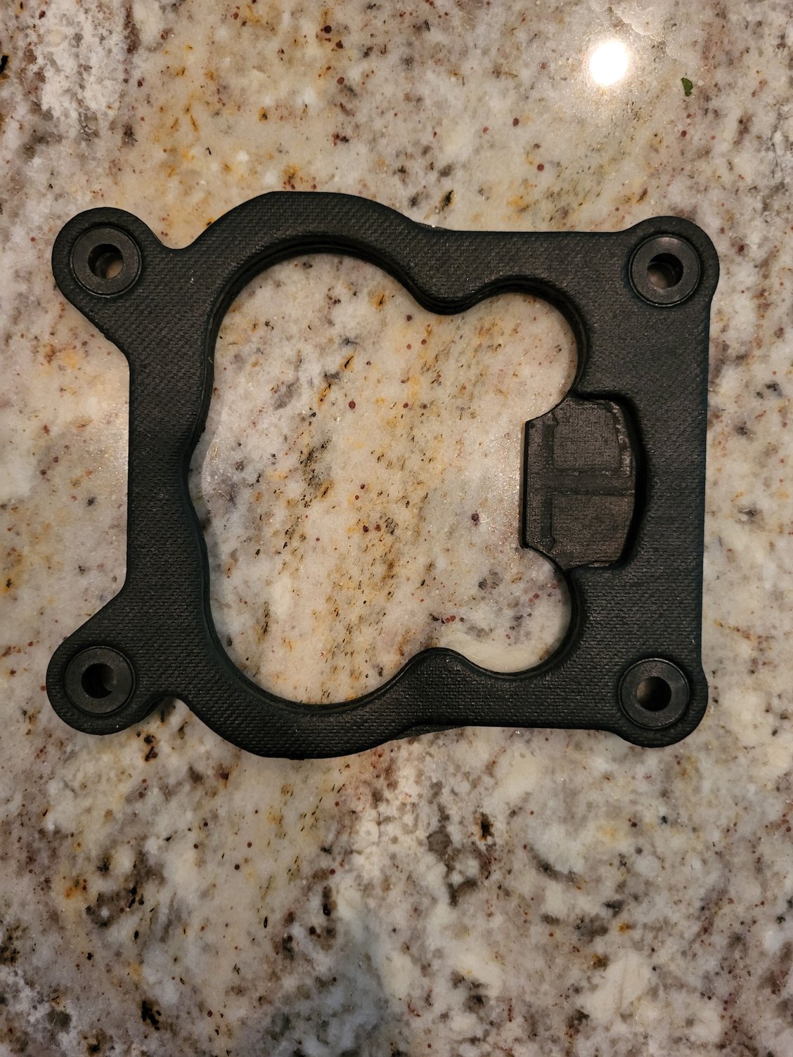

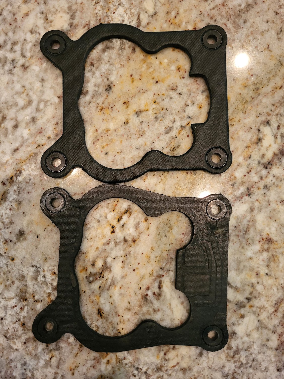

Couple more questions if anyone gets this far down... took everything apart yesterday and all went smooth, stripped the manifold (about 4 applications of paint stripper then wrapped in plastic to soak) took a fiber disc to all the gasket surfaces, etched the manifold and painted with engine cast aluminum paint... I set up a table in the garage this morning and got everything together for the carb rebuild, took my time... a little over three hours to make sure it was done right, again all went smooth.
* i set the air mixture screws to 3.5 turns each so is that a good place to start with a stock L82/auto? (one side was 3.5 and the other was 2.5 turns) NEVER MIND THIS QUESTION
* see pic of base gaskets... they are a touch different, one exposes the caps the other covers them... does this matter? I ordered from Cliff Ruggles and was correct for my application.
I have "the right stuff" for China walls, ultra grey for ports and water pump gasket maker for the coolant ports and plan to do both sides of the gaskets, I will start the reassembly between tomorrow and Tueaday.

As mentioned in your other post yesterday, that Intake Gasket you picked allows the hot air crossover.
Try the FelPro 1205. Blocks the crossover.

thanks, I purchased the set I mentioned with the crossover openings... it has crossover restrictor plates that I can block off and install with the gaskets... the car had open gaskets that I removed and haven't had issues with running hot.
Is the only advantage reducing the heat going under the carb? I assume having it serves no purpose other than emmisions which i dont have to deal with but I have all stock emissions equipment.

The concept was, to warm the engine quickly on those cold January nights. And it did work.
Unfortunately, the engineer / designer forgot that there is no way of shutting off the hot air.
July? August? 110* in the shade?
Small engine bay. Little air circulation.
And the problems go on & on.
But hey, your carb is nice & warm.

And your choke then shuts off. No exhaust crossover and the choke does still work. Just much slower to shut off. A good thing???
