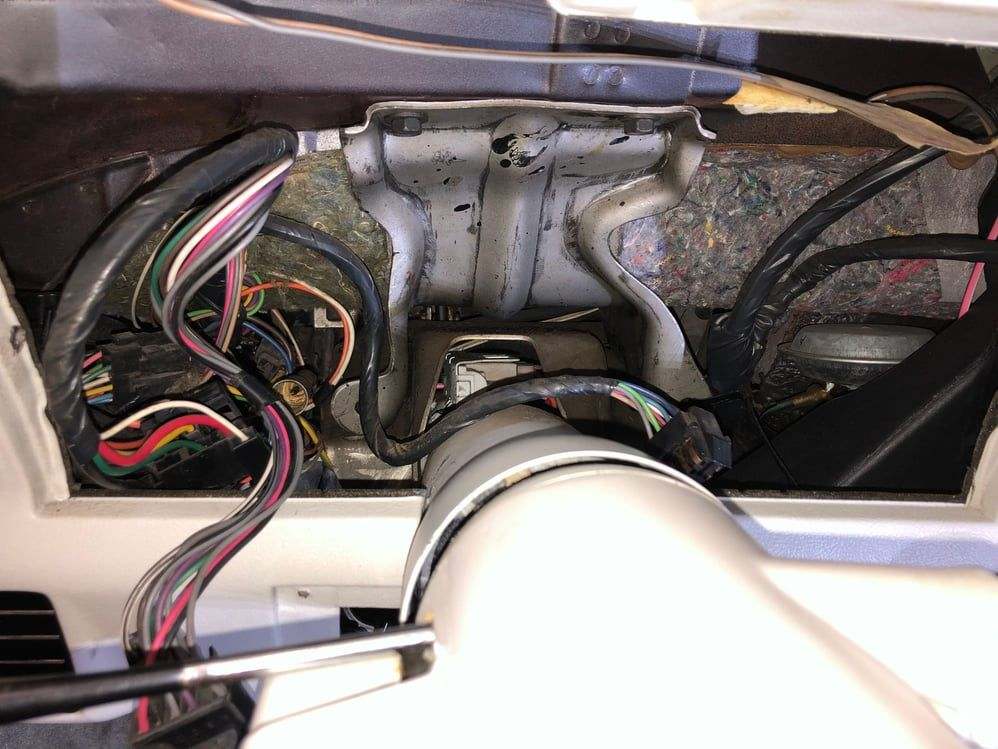

I have changed the one in my 78 by tilting the wheel down as far as you can and removing the speedo cluster. No need to drop the column. Once it is removed you can see there isn’t a lot of room to work in there and the switch needs to be in the right spot to get it all back together. While you are in there verify that the small ground wire from the switch to the frame is connected properly. Do you know how to remove the ****?

I did this a few days ago. I went in from under the dash by removing the duct & the 2 screws on the edge of the dash panel. I recommend removing drivers seat first. Space is extremely uncomfortable & cramped. Trying to get your arms & head under & behind the dash is a challenging. You can’t check the ground wire from here either. I’m 5’8” & 150lbs. I can get work in very tight places. Anyone much bigger than me is in for a very long day. The video in this thread doesn’t show everything. Following it will tear up your dash. Take a close look at the one in video. The only good tip was him pulling out the **** to parking light setting first. Then push the release button and pull the **** out. My new switch didn’t solve my problem. I need to go back in & check the ground. I’m using kanvasman’s method next time. I think you should use it too. Good luck!
