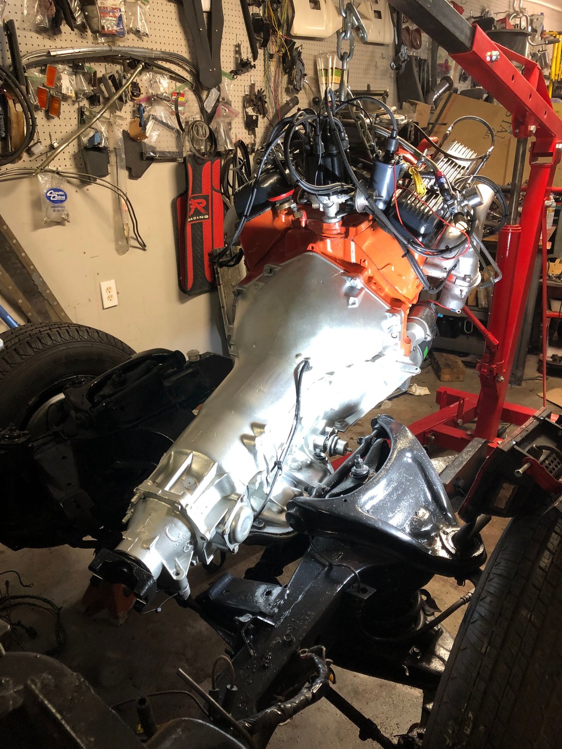

I'm doing it as we speak...I leave everything off that will catch on the chassis and slide the assembly into place.....
The engine and transmission were in good shape internally so I degreased everything/sealed all holes with tape and sandblasted both units. I wiped them down with acetone and repainted the assembly.

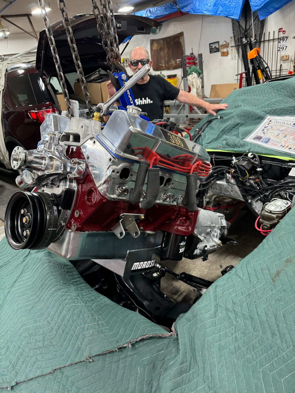

Used a Mac’s Engine Pivot Plate and chain fall
Originally Posted by 69XR7
For those of you that have installed their engine and transmission as one unit. Did install the transmission mount beforehand or wait until everything is in?
I'm thinking that i should leave it off to give more room for the transmission to slid in over the cross member.
350 w T400 installed as an assembly and mount was in place.

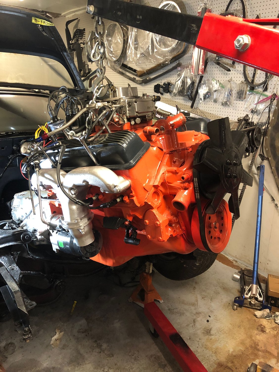

I too installed as an engine/trans assembly (454/TH400) and left the crossmember out until the engine was on the mount horns and all looked good. It was pretty straight forward as long as your hoist can support the combined weight and you have a leveler attachment to help guide it into place. I believe I also lifted the rear of the car on jackstands to aid in getting the angle correct so the trans output end wasn't in danger of scraping along the driveway, but I am a little fuzzy on that detail.
