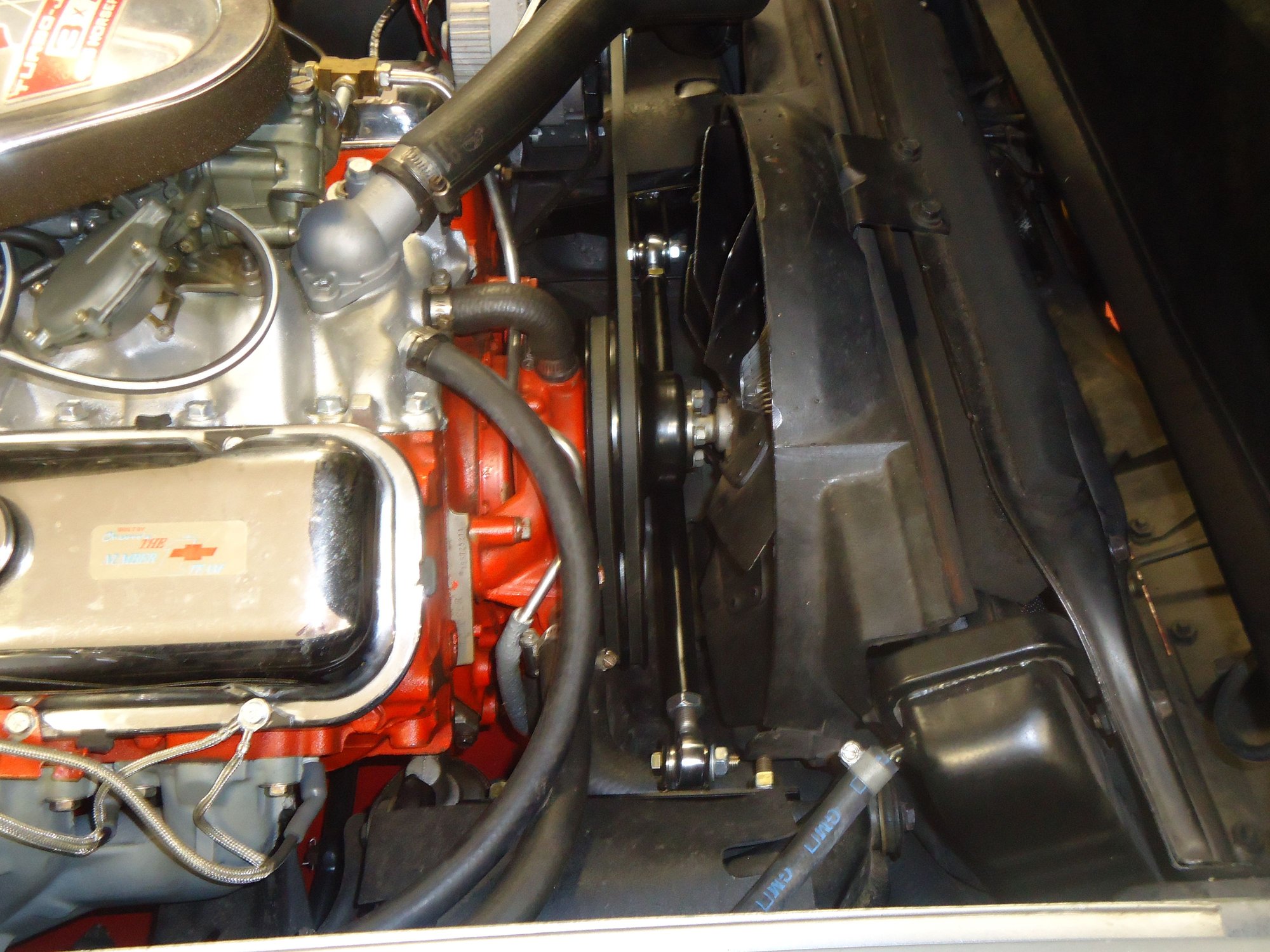

Finally after playing around with the idea of adding a spreader bar to my 427, I had brackets made where the bar clears the stock fan and pullies. The water pump pulley is from a 67 big block. It took a few made up templates to fit the spreader bar so it clears.

A few more pictures, and close up's of the bracket, would be appreciated.

It's two pieces I had laser cut and a flat washer to keep it from moving fore and aft.

Can you post your blueprint here?

I want to make some changes to the control arm bracket to locate it better instead of using a washer I had welded on.

I am very interested in this as well.
It looks to me as if you may have manual steering?
And a 2 belt water pump pulley?
I am going to attempt the same thing on my 3 belt water pump pulley, AC & PS car.
Now that should be even tighter.
The third belt goes right where you have your spreader bar.
Old Sep 1, 2024 | 07:22 AM
3X2's Avatar
3X2
Joined: Jan 2000
Posts: 3,326
Likes: 523
From: home
That's one of the joys of a non a/c, non p/s. non a.i.r., non p/b big block car, a bit more room. The water pump pulley and belts are for a 67 big block Corvette. Hasn't had a smog pump in over 50 years and I didn't like the 3 groove pulley without a belt. This may all change if I ever decide to put the smog pump ack on.
