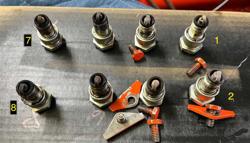

A check of each spark plug may indicate which cylinder(s) is most affected by the oil. Pull them all and arrange them in the same sequence to how they come out of the engine.
Like this:
