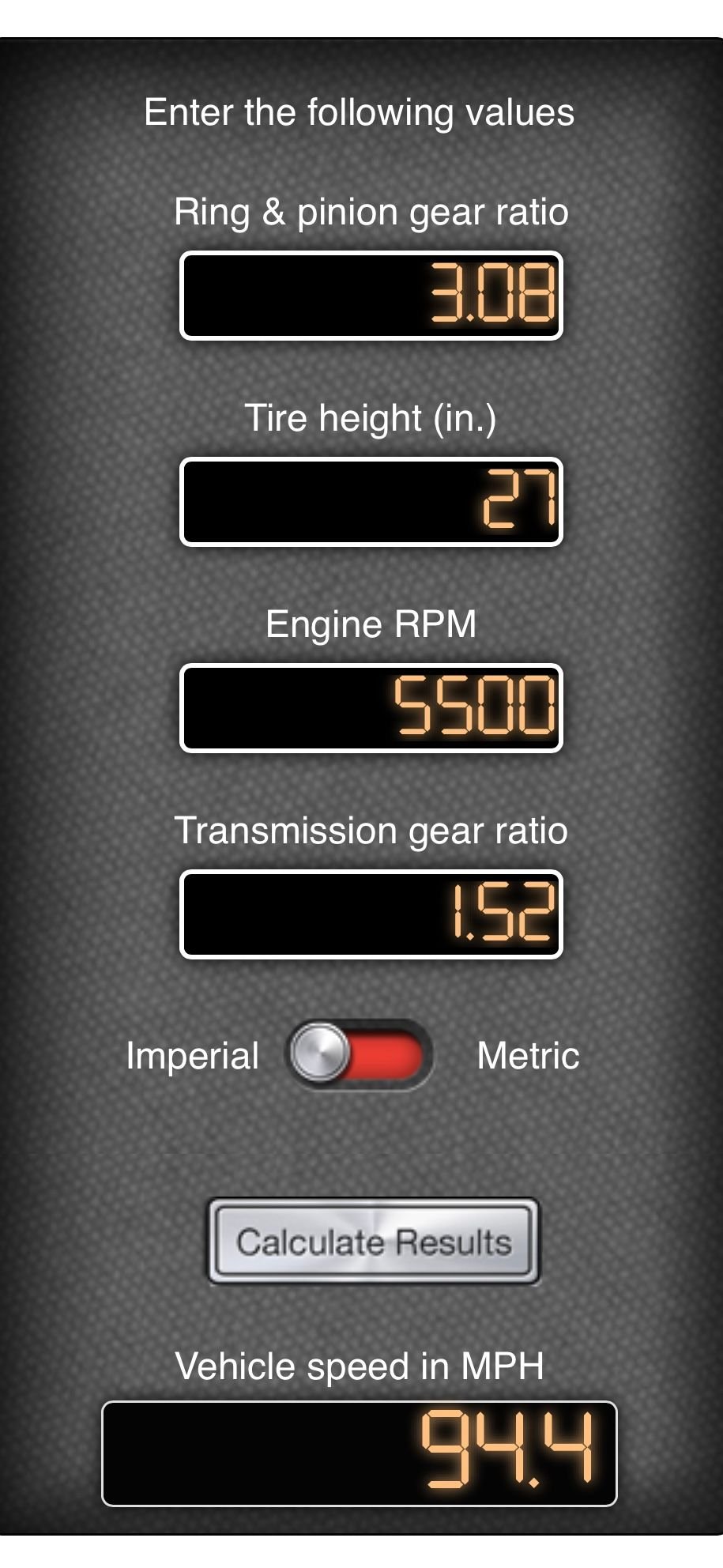

Here’s the speed the car would be going if you were stuck in 1st gear at 5,500, assuming you have a 3.08 rear end
2nd
My guess, assuming the tach is accurate, that he’s stuck in 1st
