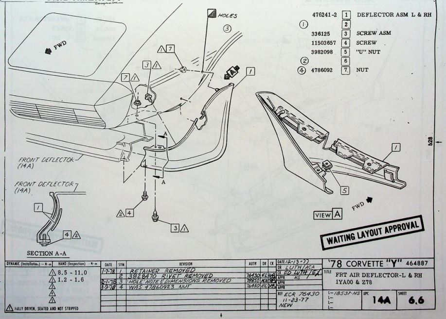

here is 78-79 spoiler OEM i put on link below , i think maybe the 79 added a screw on top outside.
I never could find OEM like aftermarket. If you found one please share!
