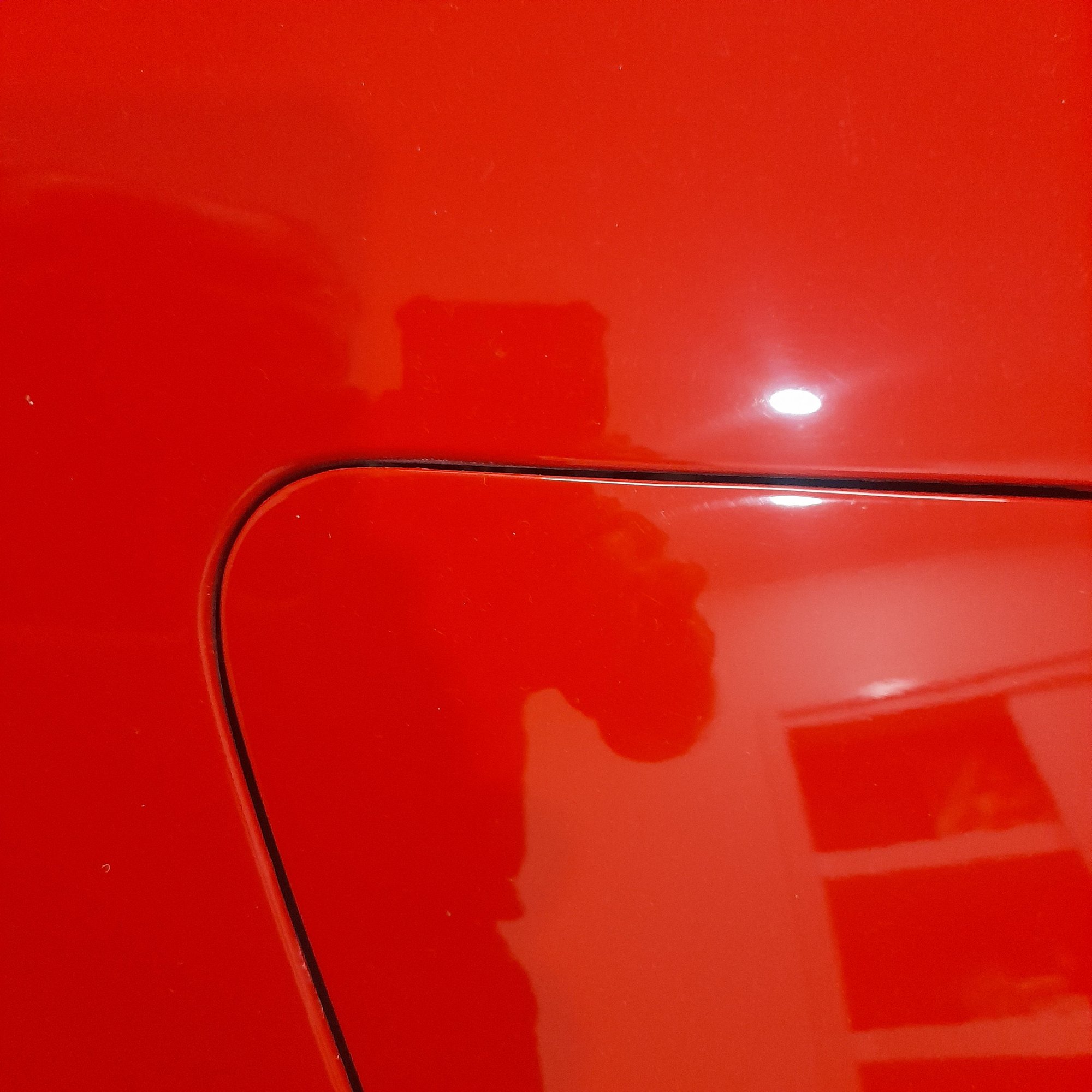

OK Dean, in the spirit of trying to be helpful.
This was me making it worse trying to get it perfect.
Giant Ouch! WOW! Did that hurt. Just trying to get it more perfect, and it really wasn't all that bad before. Just wasn't perfect. Perfect may be very.hard to achieve! This ouch cost me over 4 thousand dollars! I am a working man! This REALLY hurt!
THIS, this I settled for.
Just look at the refection in that single stage paint! No clear on this car! Same headlight door. 4 grand and the rest later. See, the gaps are STILL NOT PERFECT!
How perfect do you want them? How much time and money do you have?
How wide is your paint paddle? How tight is my upper gap? No, it's not hitting anywhere.
It's called, split the difference all around the best you can.
Spectators really don't notice!

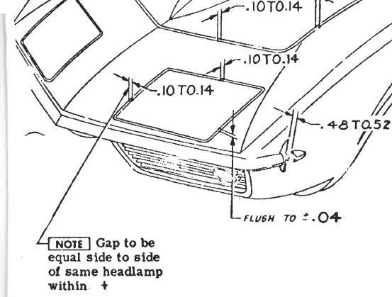

This is what the AIM indicates for the gaps. Getting that measurement is probably going to be very difficult if not impossible. Be careful.
