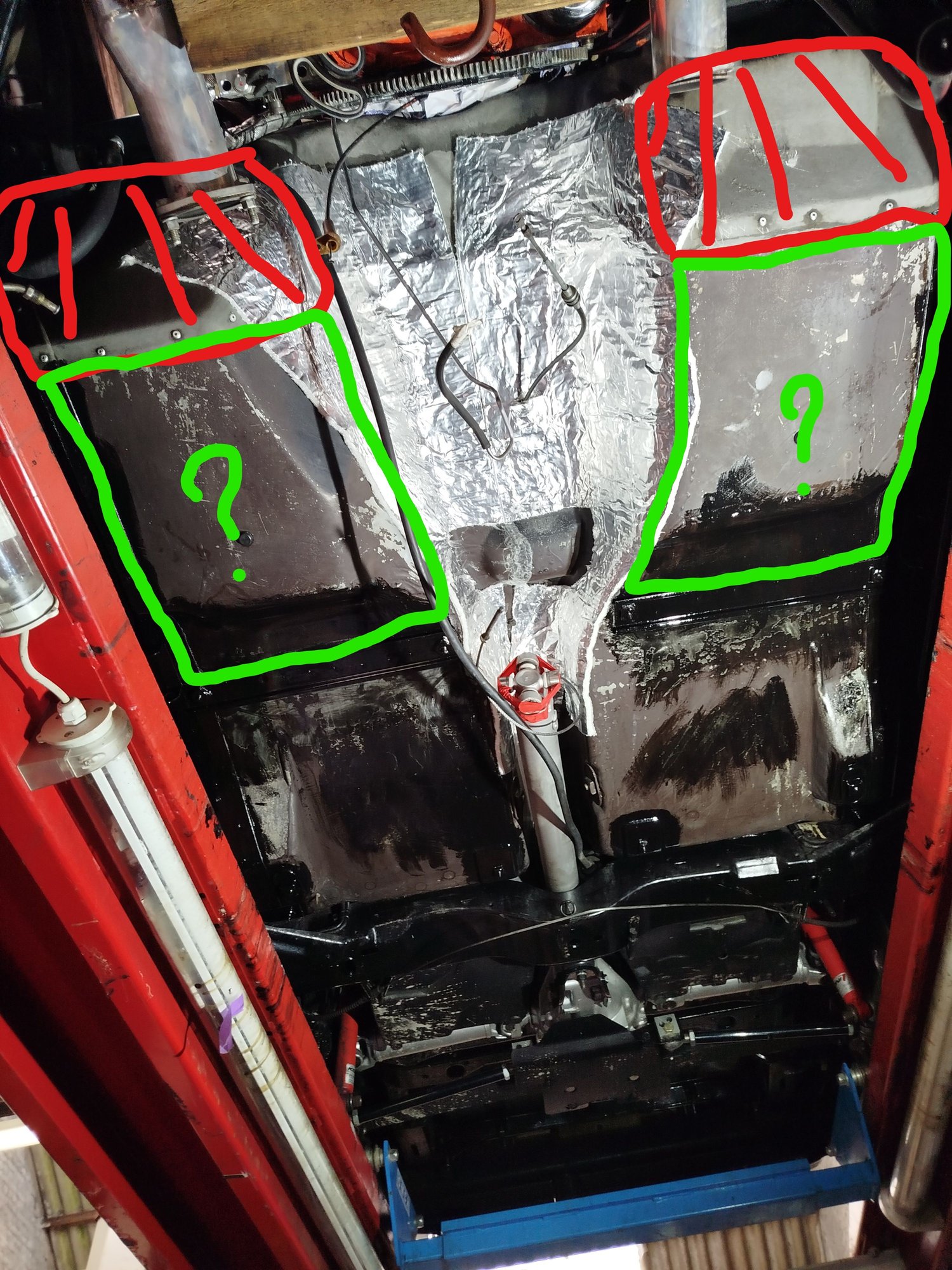

Yesterday I finished (mostly) insulating the transmission tunnel with some thick heat shield (specially for automotive use).
Should I also put some heat shielding foil on the 'floor-feet-spot' (red spots in the picture)?
What about the green area?
The shielding is rated: 500 degrees C (max. direct heat).
Can this catch fire or is that very unlikely?

I’m sure it wouldn’t hurt anything, but…
Those areas are much more exposed to the air flowing underneath the car, it should dissipate heat much better than the cramped area of the transmission tunnel.
Unless you’ve got a big catalytic converter sitting directly underneath the floor pan I would go without it.

Can't speak for your year car but there were insulation panels in both of those locations for 68-69. The green and red locations also had a protective shield over the top of the insulation once the insulation panels were attached to the fiberglass. Hope this helps.

For sure I'd do the red areas. The green, depending on your exhaust configuration.

Add as much as you like.. no way 500c..unless major malfunction
dont forget to install horseshoe seal and wrap and shield your exhaust..

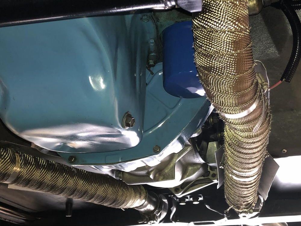

I added the some of the stick on insulation at both areas and wrapped the exhaust. Made a huge difference.

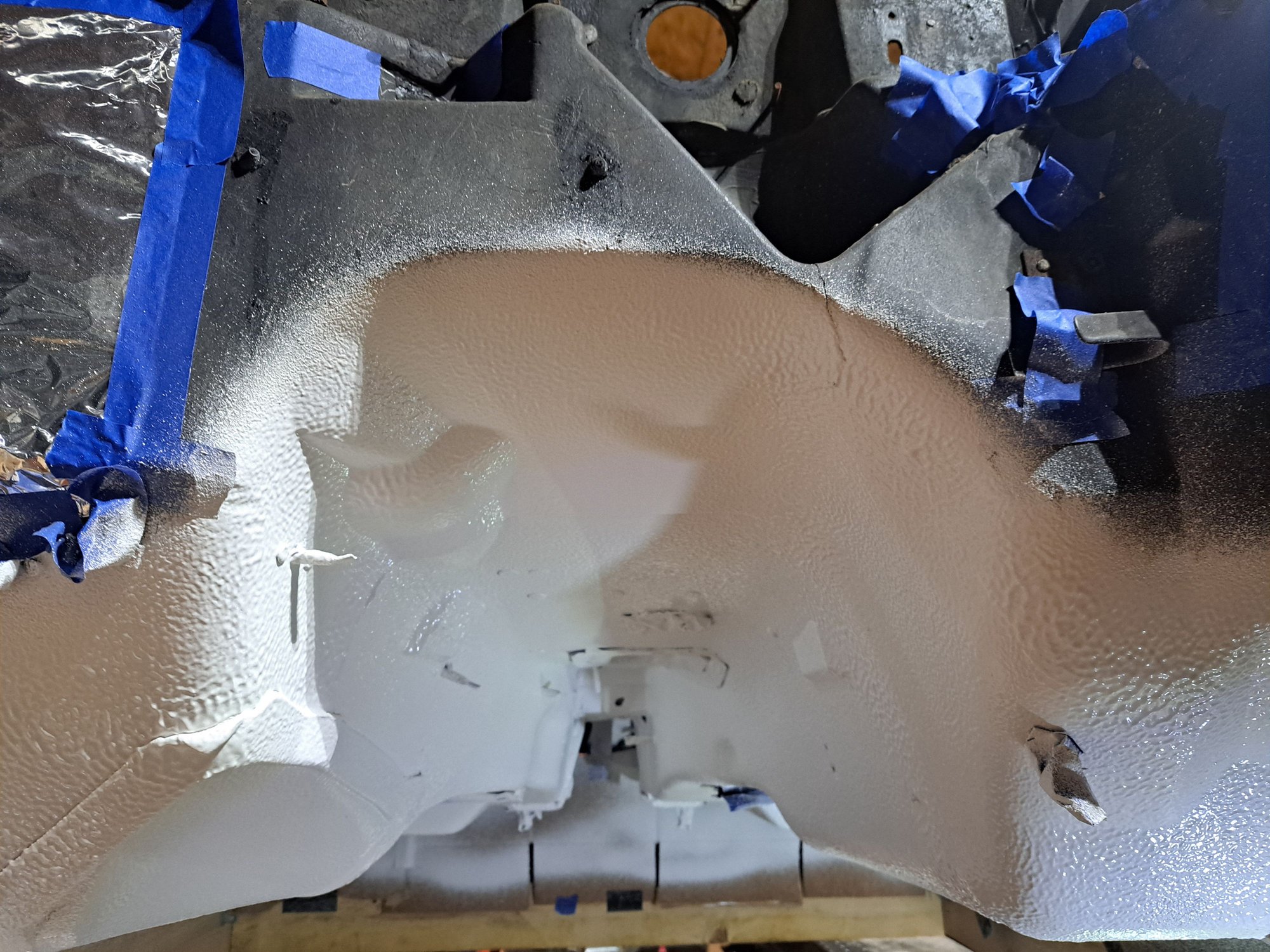

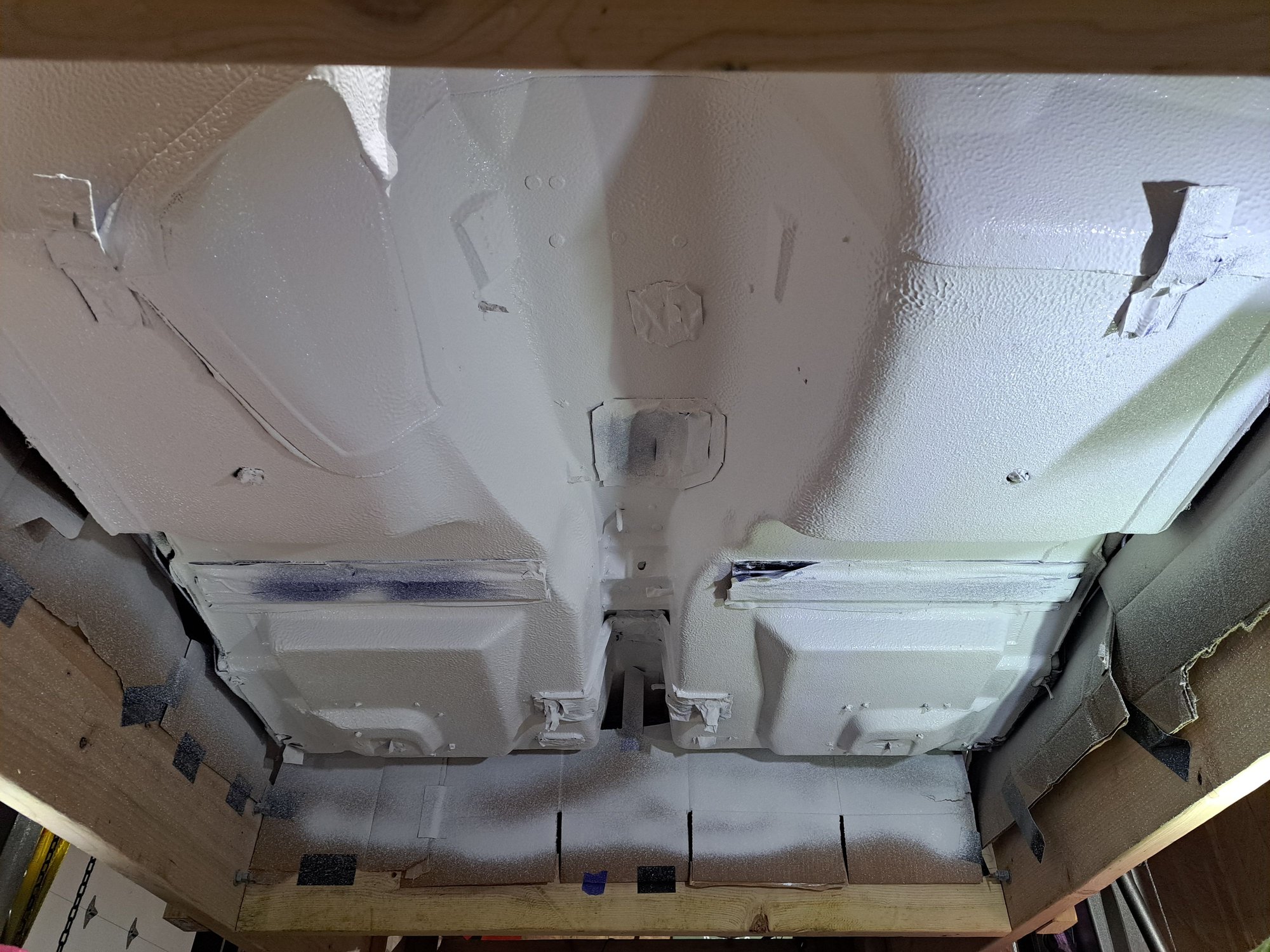

I had some of the ceramic Lizardskin left over from doing the interior floorboards/firewall and used it on the underside of the trans tunnel and both the red and green areas. I also added some of the stick-on DEI heat shielding to the front of the metal shields at your feet facing the engine.
Metal brackets all taped off
Hadn't cleaned up the overspray yet.
I'll most likely end up putting the spray gun in the classifieds for passing around for those that want to use it (just pay the shipping to/from).
