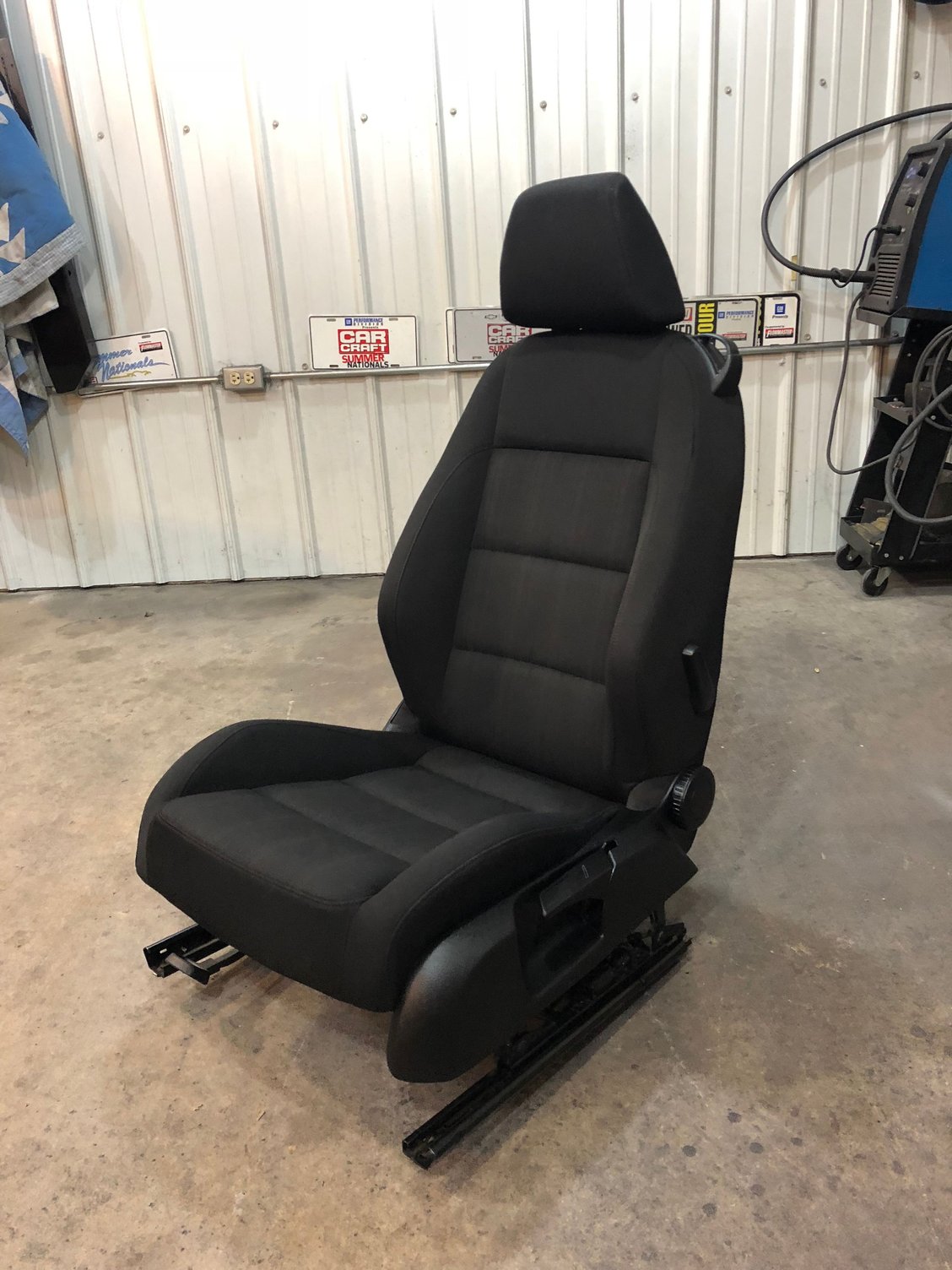

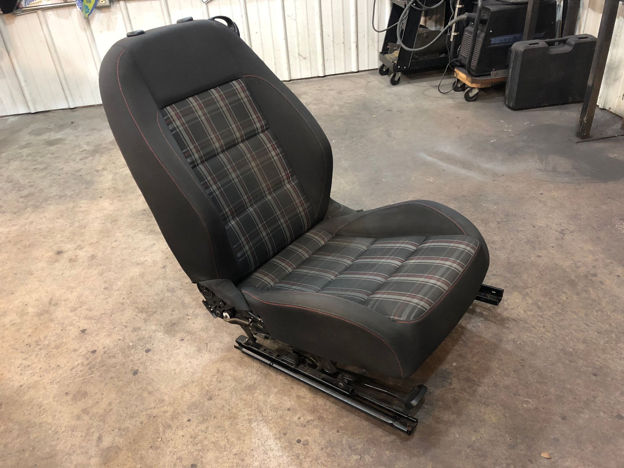

I used 2012 GTI seats in my C10 project. Got them from a local salvage yard. Paid $250-$300. Great seats. They came in a kind of a gray color but I used fabric paint to change them to black.

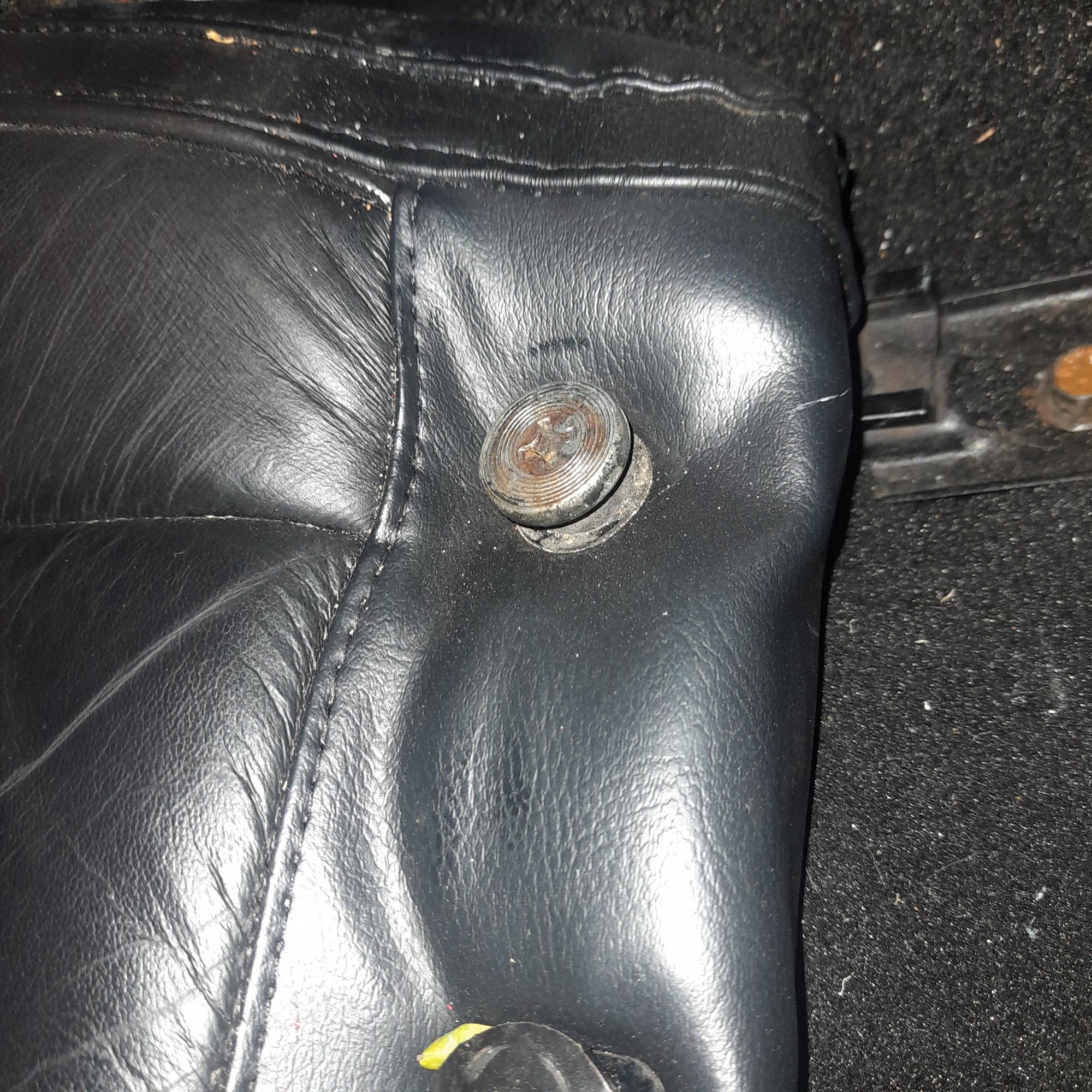

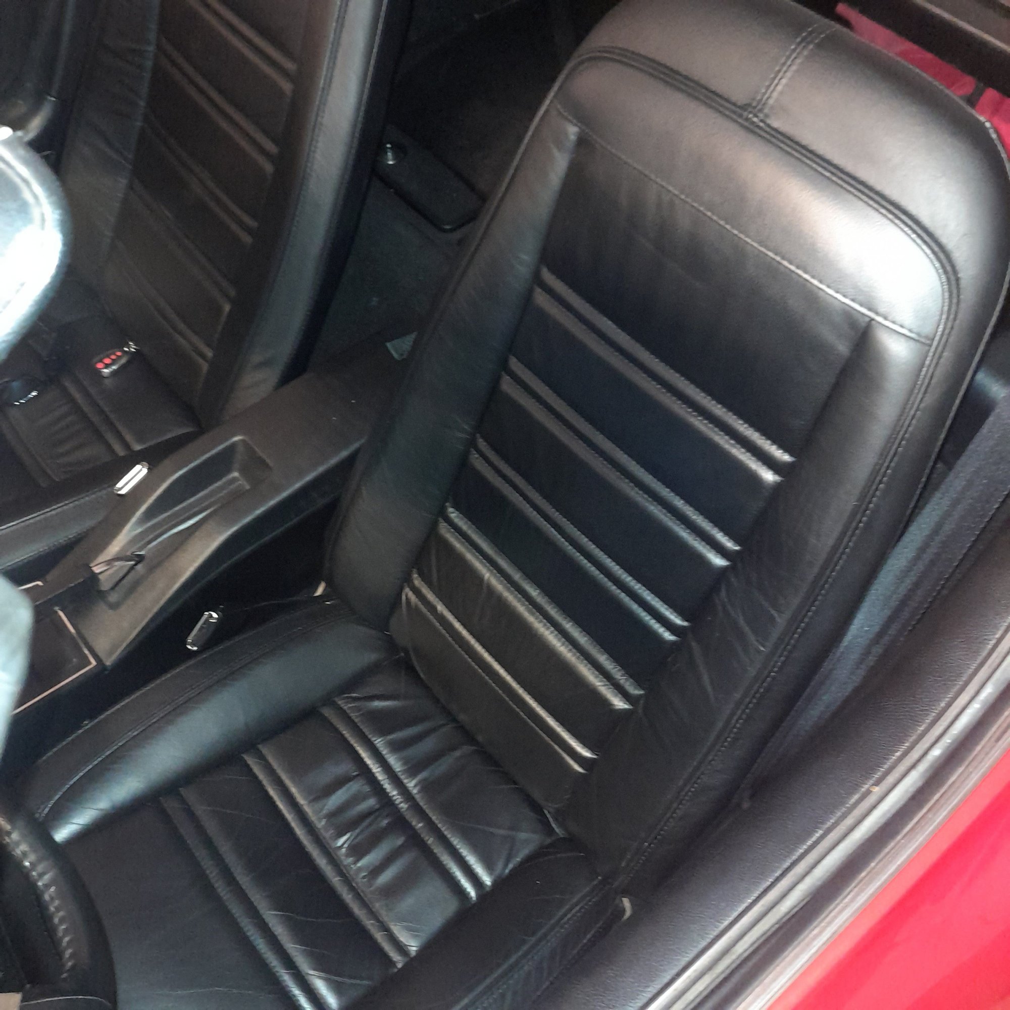

OK, some pics.
76-78 seats look like this. Just making sure we are on the same page.
One of these on each side of the seat bottom.
And one of these with the rubber bumpers on each side of the lower edge of the seat back. These can be adjusted out quite a way and actually get the seat back bolt upright. Which likely wouldn't lock there and I never really tried. But they screw out a long way. Of course you are meant to get both of them adjusted about the same.
