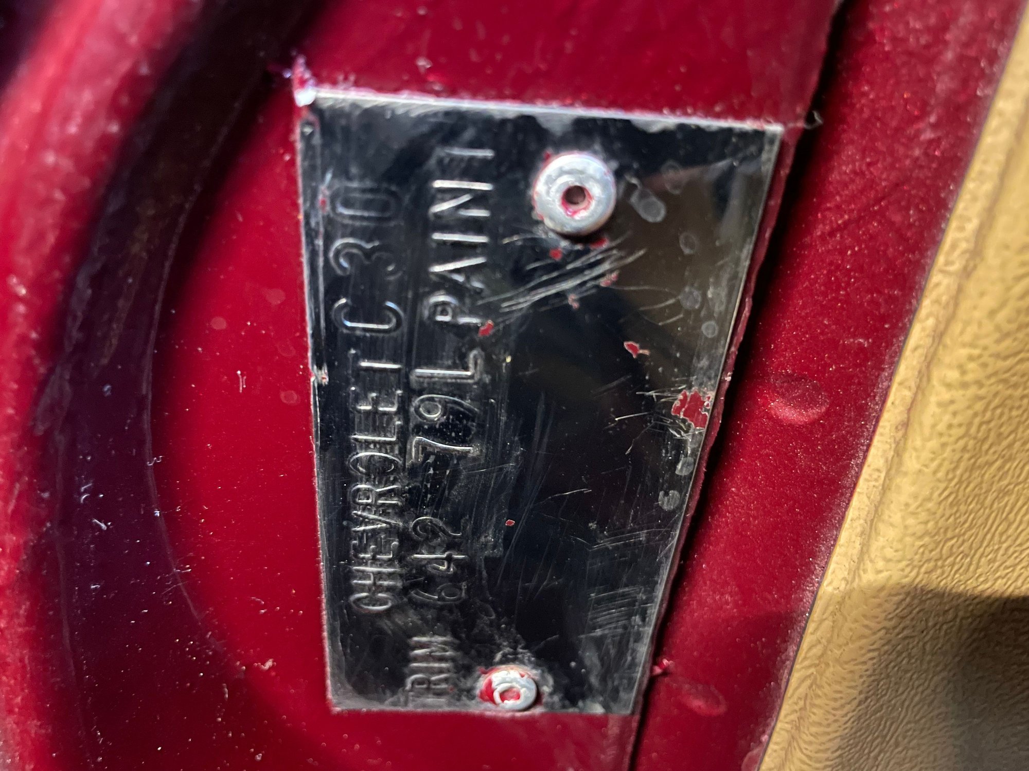

I have a 1981 Corvette with a tan interior I need to replace both sun visors, driver and passenger with a mirror .. the color is a tan color but, there are several colors doeskin and camel… can anyone help me on finding out what is the correct color…

drv door plate lists paint and interior colors by code.
take pic or write what is listed and copy here

There was only one tan interior in 1981 Corvettes, trim code 642 Camel. Just order visors in Camel for a 1981 Corvette from your favorite vendor and your should be good.

You were right they are camel I need the passenger side I have a mirror in mine… mirror is broken.. the driver side keeps falling down so the arm needs tightening or replacing
