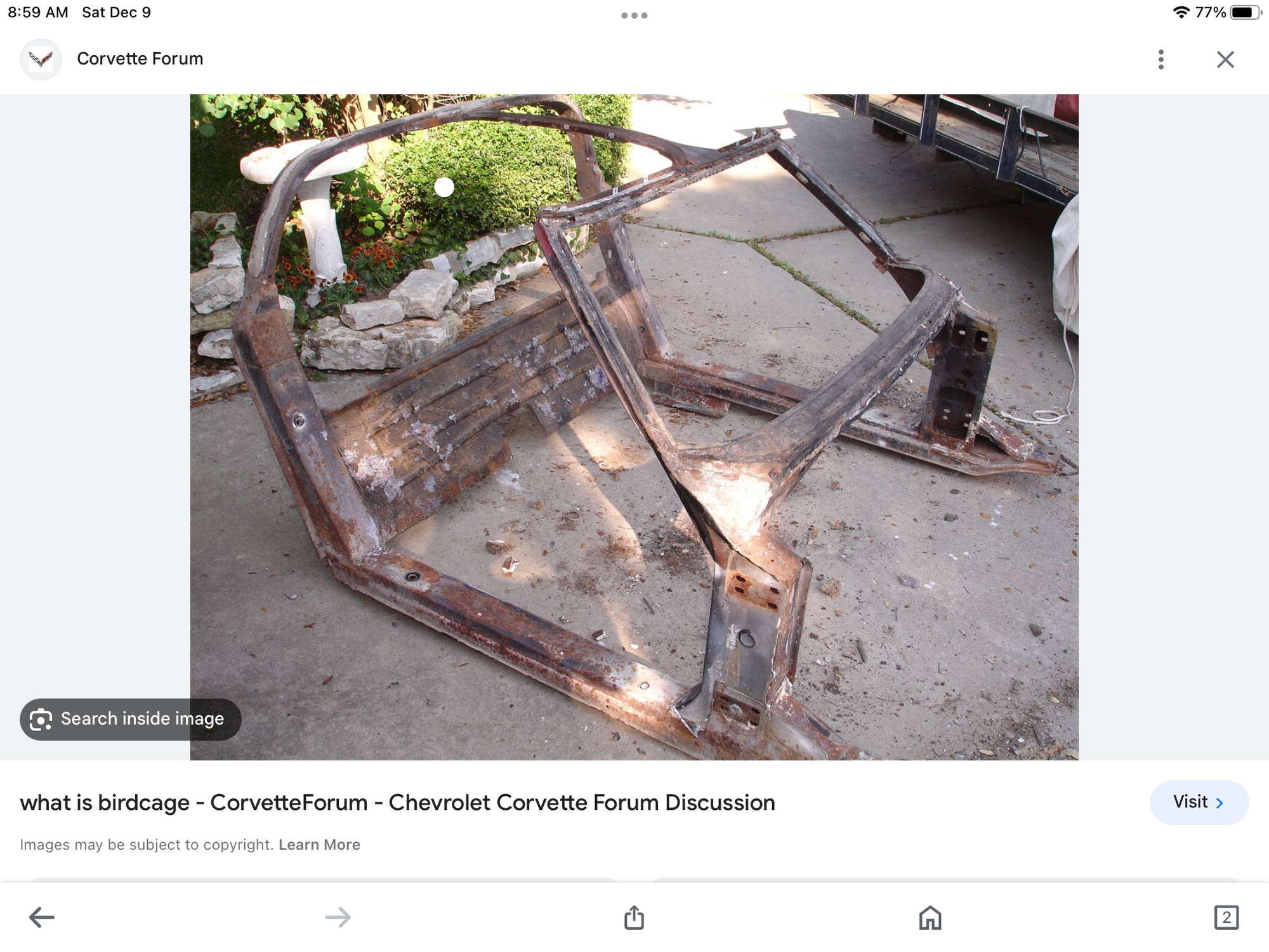

70 is my favorite year! I owned a low mileage convertible and will always regret selling it. Most important is check for rust behind the kick panels. I think one side should do it and the passenger side is easier to get to. The seller will need to allow you to take a phillips screwdriver to remove the panel beneath the door, then the kick panel. Pretty simple and will reveal the door post which if clean will indicate a pretty clean birdcage. There could be more to it, but that is a great indicator.

Educate yourself on the birdcage. A rusted ‘cage is a make or break decision.

Check the numbers and the bird cage / frame rust. Everything else is inconsequential in comparison.
