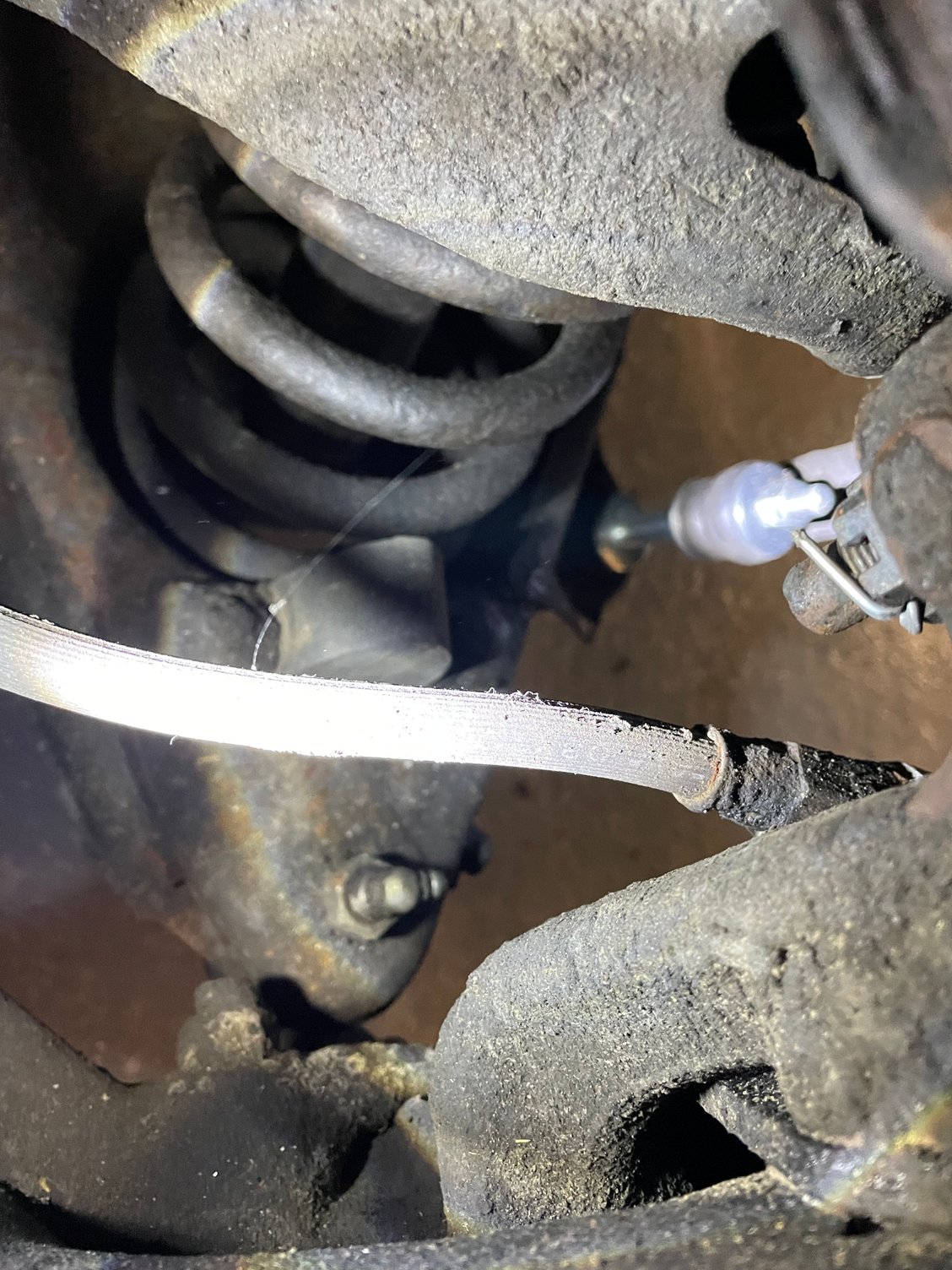

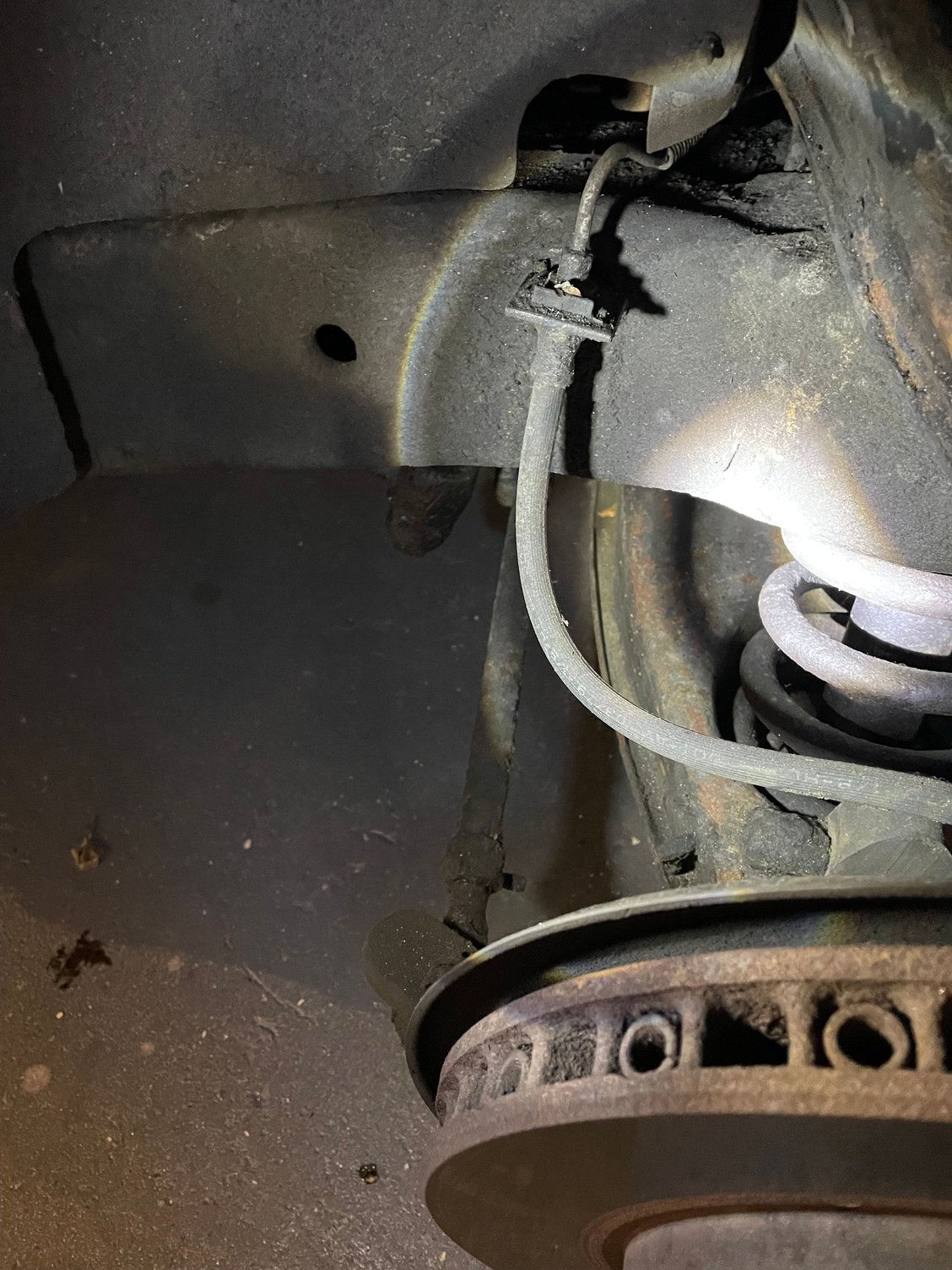

Well, everything LOOKS ok to the naked eye. The flex line seems to be perfectly fine. There is no sign of any leakage at all from anywhere. I guess I’m gonna have to take the caliper off and take it apart. I didn’t want to do that if I could avoid it. But I think I have little choice.

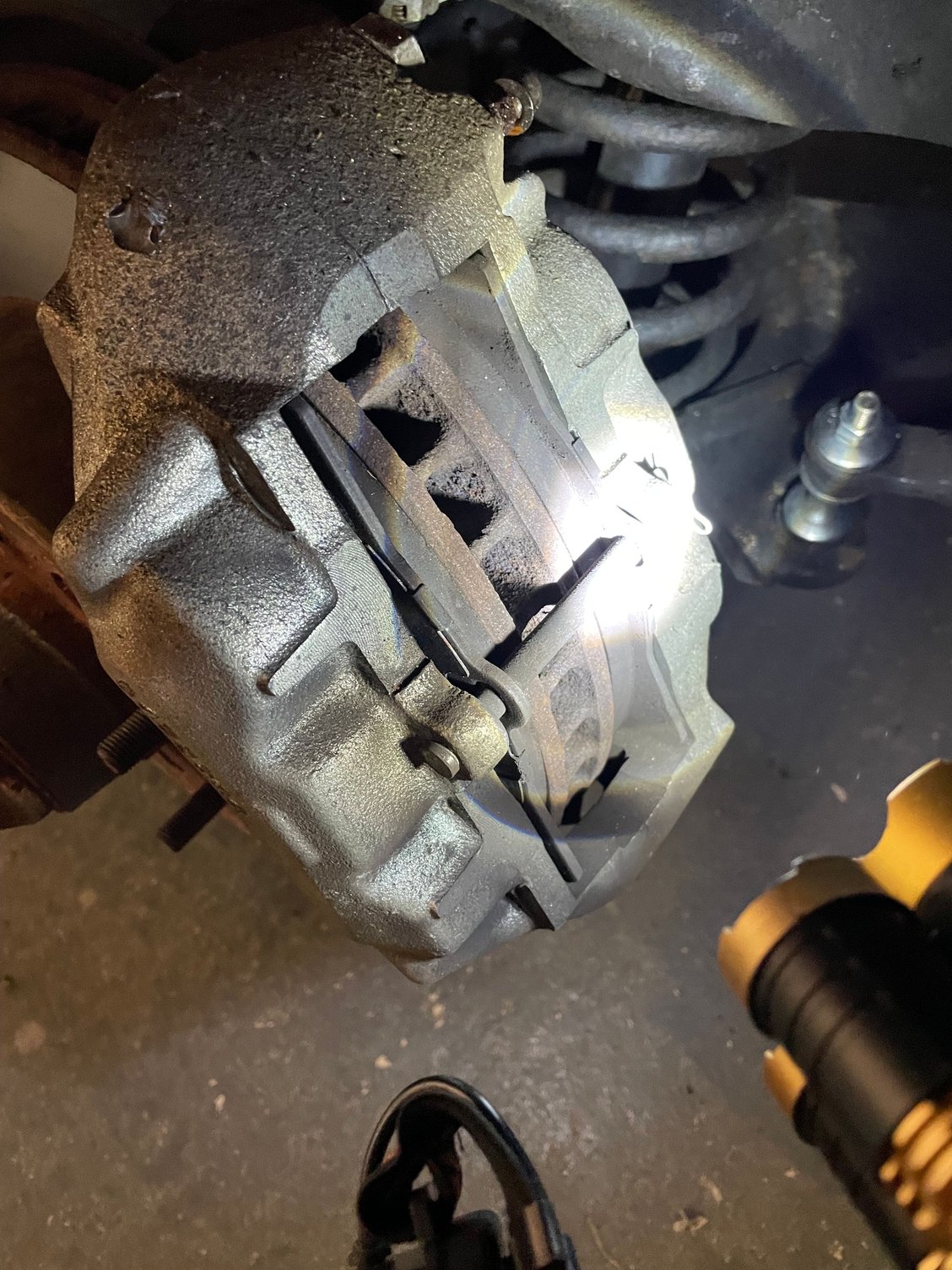

That hose appears to have a single crimp which is the way the factory hoses appear. Only hoses with double crimps have been available for decades (?). I'd say they are original or at least very, very old. Wipe off the road dirt and see what the date code says. The hoses are like tires, they have a limited life and are recommended to be changed every ~10-12 years.
That looks like a relatively new caliper and certainly not original. An original by this point would be quite crusty with surface rusting. I'd wager they are not in need of rebuilding or replacing if you don't see any seepage at the joints where the two halves bolt together or at the piston seals on the backside of the pads. Once the new hoses are installed (yes, all 4 corners), do a full brake flush and bleed.
BTW, to remove the rubber hose, the end at the frame needs to be disconnected before the end at the caliper. After the new hoses are installed, check to be sure there is no twist of the hose any more than 1/4 from end to end. The white stripe, lettering, or ribs help to determine the twist.
Here's a pic of a modern hose with the double crimps:

Originally Posted by micmak
Anyone know what the deal is with the spring-looking things inside the disc vents?
Old Sep 29, 2024 | 11:17 AM
