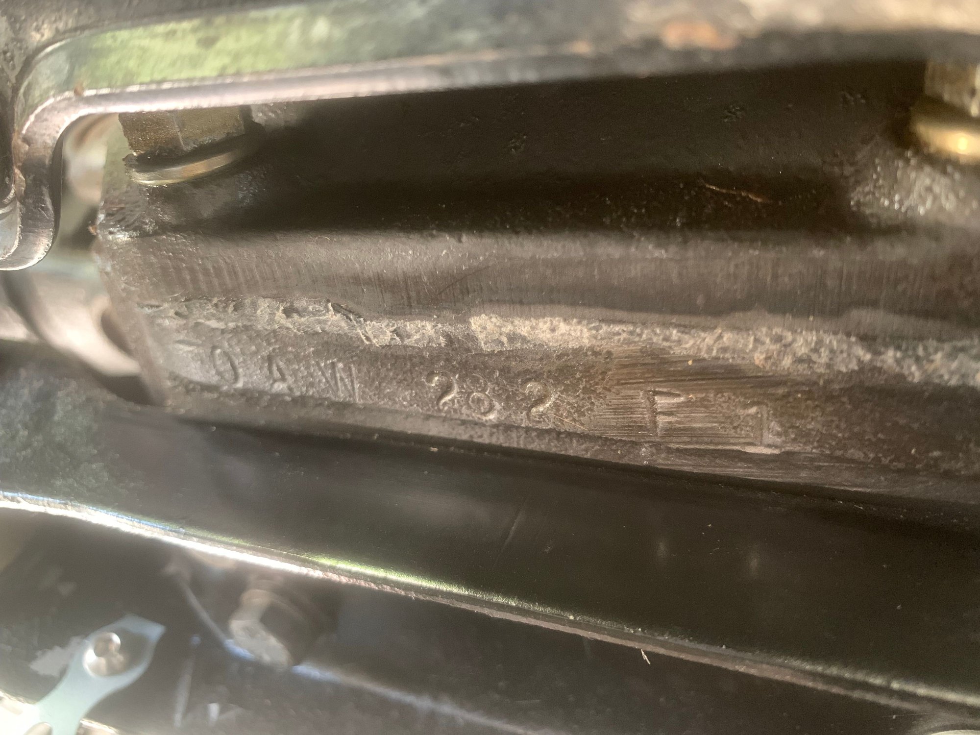

I have a 1975 Convertible L48 four speed.
I do not have any documentation. I know there was some significant work done to it before I got it.
According to the on-line calculators, it has 3.70 gears in the diff based on 3100 rpm at 65 mph with 26 inch tires. However, the stamps on the differential indicate 3.08.
The looks like it has been opened before.
If you are skilled at decoding, please look at the picture and decode. Is it possible the gears were changed?

AW is 3.08 in 1974 and the math indicates it currently is 3.70.
So my math is right which means the gears were changed at some point. Thank you.
Note the car is a 75 and it appears AW is not a 75 year code. As such, the diff has definitely been changed.

AW is a 1975 model year code, it’s for a 3.08
Although your code is OA, which is a 3.08 code from a later car
Do you have different than factory size tires? A 225/70r15 or 255/60r15 is closer to 27 inches

AW is 3.08 in 75 also
OA is 3.08 in 76
All the codes are here
https://corvettec3.ca/axle.htm
Running P235/60 R15 all around.
