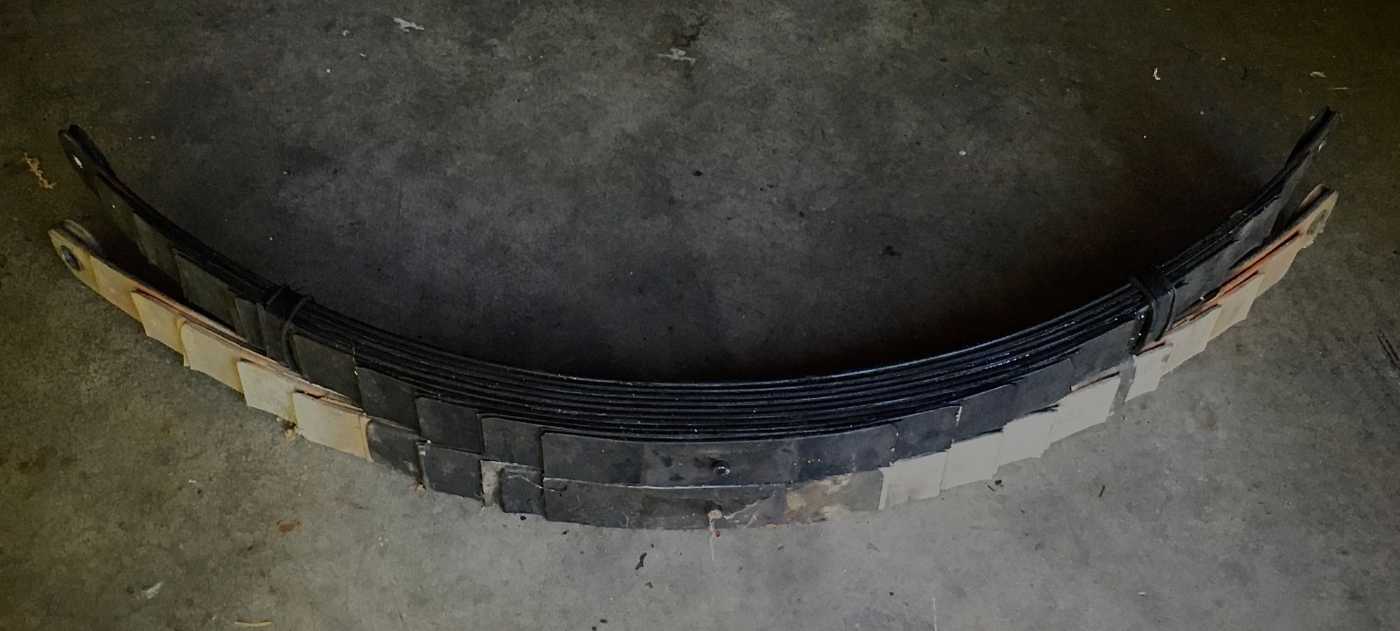

Here’s a pic of two ‘78 leaf springs stacked up. The upper one was re-arched to factory spec by a spring shop. With the re-arched spring installed the rear was too high. Longer mounting bolts put the spring ends very near the tires. So close the spring had actually scraped the tire from where it rolls inward on a turn. Replaced it with a 330 composite from Vansteel. If you’re really into spirited driving get a 360 or coil-overs.
Charlie

That spring is bent the wrong way. That's what's clapped.
Get a low-arch composite spring from Van Steel to replace it.
