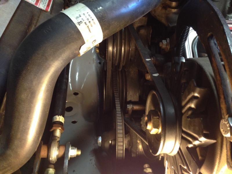

Here is a picture. You can see the pulleys and how I ended up aligning them to run my stuff.
The Forwardmost pulley drives the Sanden A/C compressor.
I can look for a picture of that if you need to see it.
BUT REALLY - as expensive as these pulleys have gotten if I was starting now I would go Serpentine.
You can find good pulleys on ebay for a lot better price than you will get from the Vendors.... the vendors just keep jacking prices ridiculously because they can. Seriously - look on ebay.
And here is more pulley info and a/c info and I think one of the fellows even had a 71: https://www.corvetteforum.com/forums...do-i-need.html

thanks again for this information and the photo. From the photo, it looks like the power steering pump is driven from the middle, crank pulley, the alternator is driven from both the inner crank and water pump pulley, and the AC would be driven by the second groove of the water pump pulley. Is that right?

For MINE which
The Forward most (3rd) drives the a/c compressor.
The 2nd WP pulley drives the PS belts.
The aftermost wp pulley drives the alternator belt.
... BUT---- mine is a 68 that did not have the option for both a/c and ps with the 350HP. Pretty sure most of the 71s could be had with both a/c and ps.
You just need to get the proper forwardmost pulleys that will mate with your existing waterpump and crank pulleys and start there.
You should look at the 71 AIM.
What is the pulley number for your waterpump?
What is the pulley number you have for your power steering pump?
How/where does your a/c compressor line up?
Take some pictures and share them....
