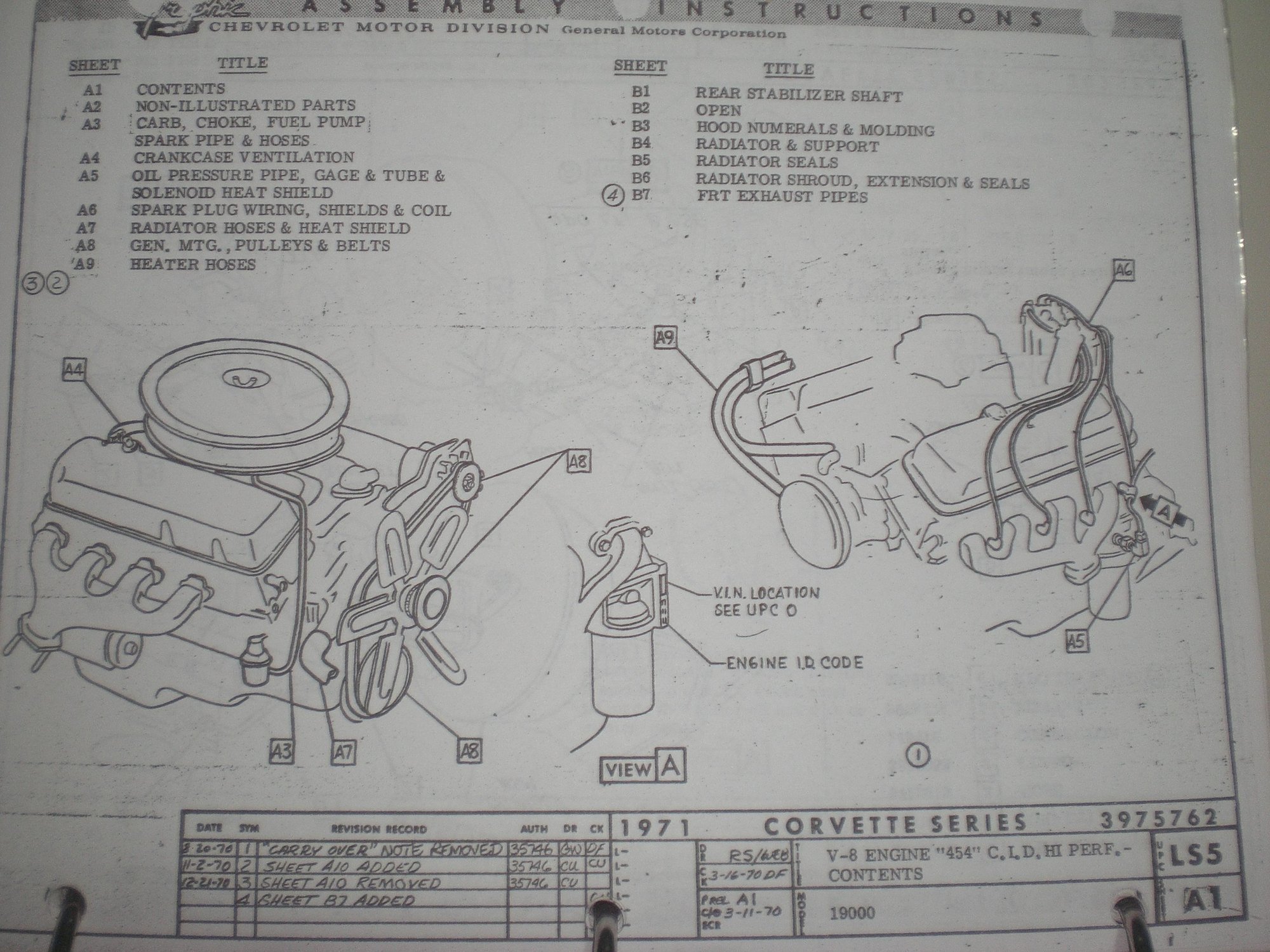

Battery behind the driver's seat
For a '71 454, but according to '69 AIM, it's in same place on a 427
cool, i'll take a look next time i'm over there. thanks very much!
