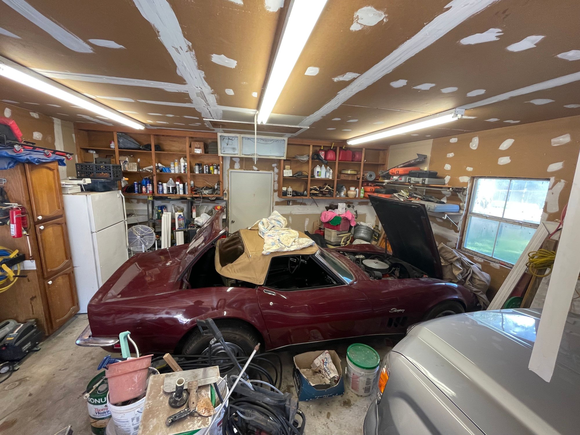

Here's how I found her recently burried in a garage:
And today when she followed me home:

It looks like it's in the garage sideways. How did you get out?
Old Oct 14, 2024 | 10:09 AM
Arg0413's Avatar
Arg0413
Joined: Feb 2015
Posts: 1,440
Likes: 1,031
From: Baton Rouge Louisiana
It was on wheel dollies is how he had it tucked in there sideways. It was some work to get it out, but my buddies car hauler tilts back and has a winch so was easy to get on the trailer once we got the car out the garage and sitting on the tires.

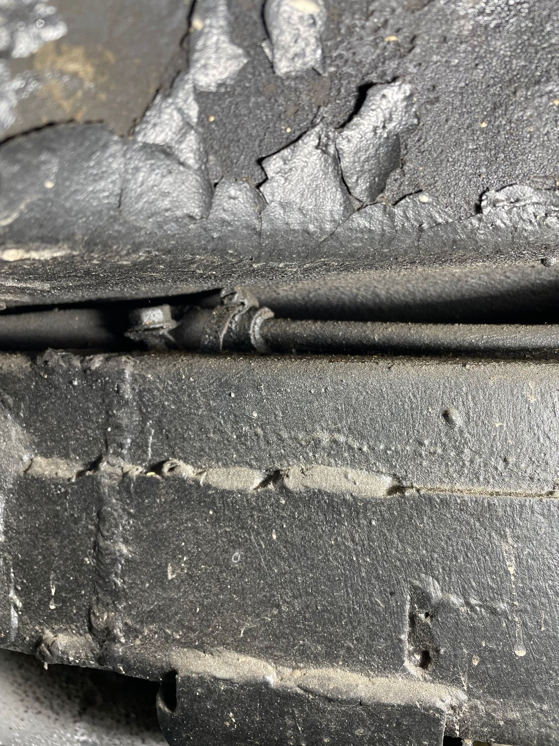

It appears on a convertible that it's quite challenging accessing the hard fuel line on the frame to replace the rubber hose that attaches and runs from the metal fuel line to the fuel tank. Any insight or tips here?

You could loosen the #3 and #4 body mounts on that side of the car enough to raise the body 1/4" to 1/2" . BUT nor more that that so you don't crack the quarter panel fiberglass.

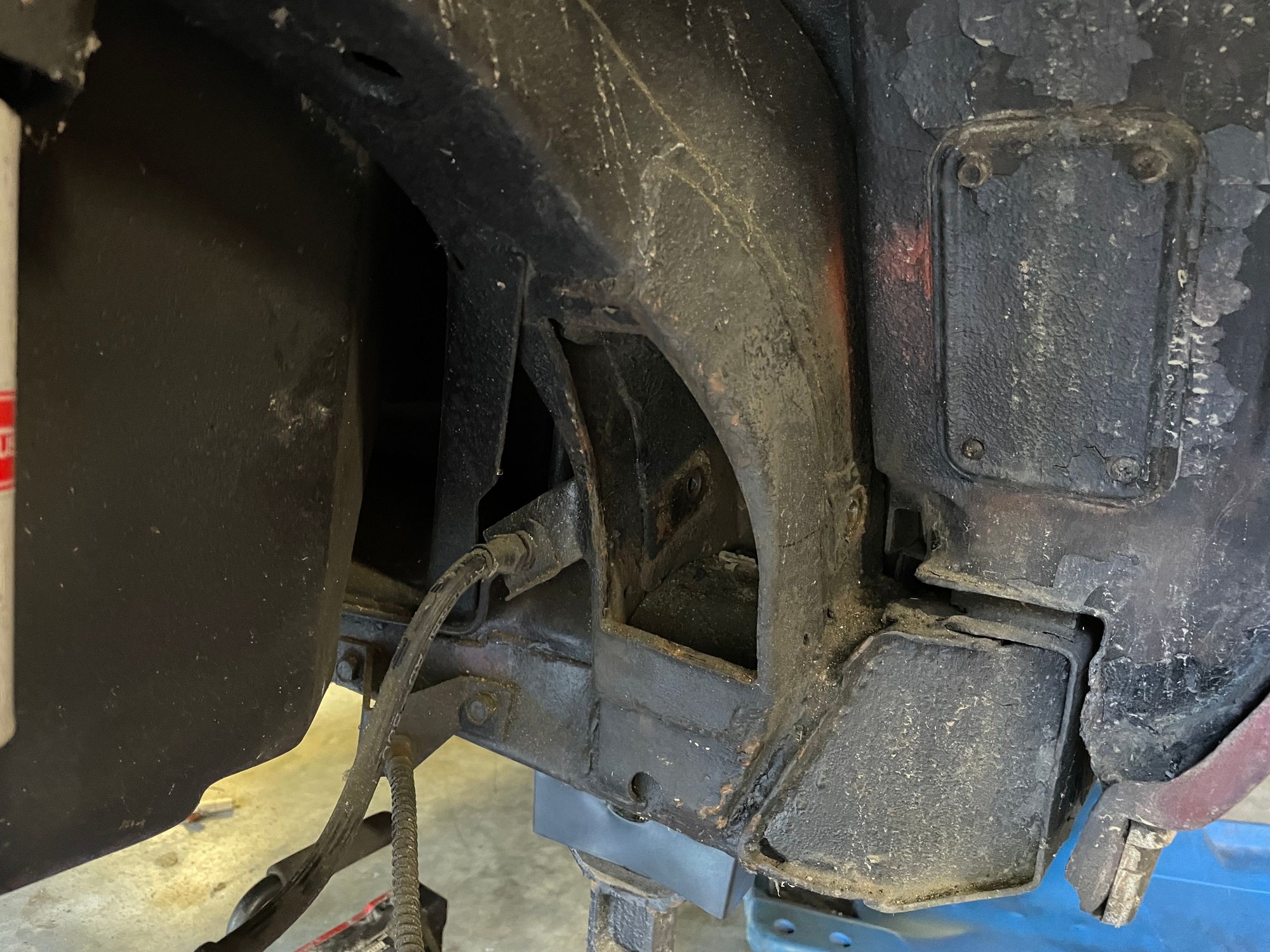

It's werid they didn't run the metal lines to the back of the frame like a coupe an stop above the rear wheel where you can't reach it!!!! Body mounts can be opening a can of worms, i'm going to have to figure this out .. maybe been the metal line outwards to connect the rubber line?

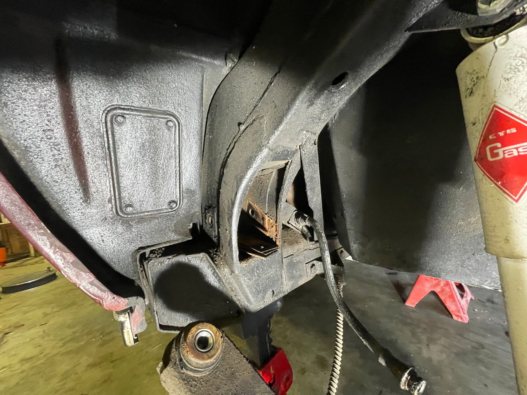

I found where the rubber hose connects to the metal line above the rear wheel, here's what i'm working with:

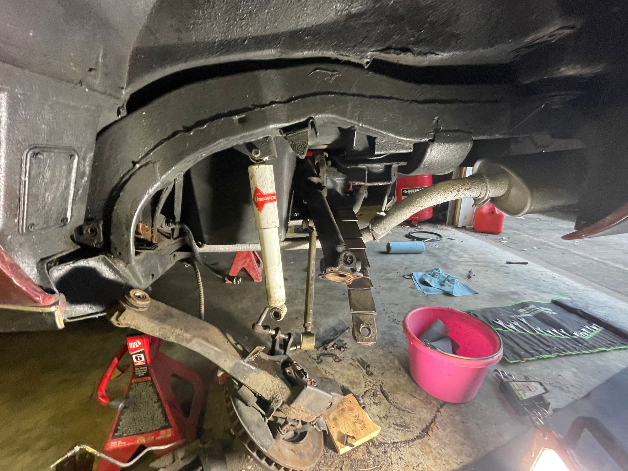

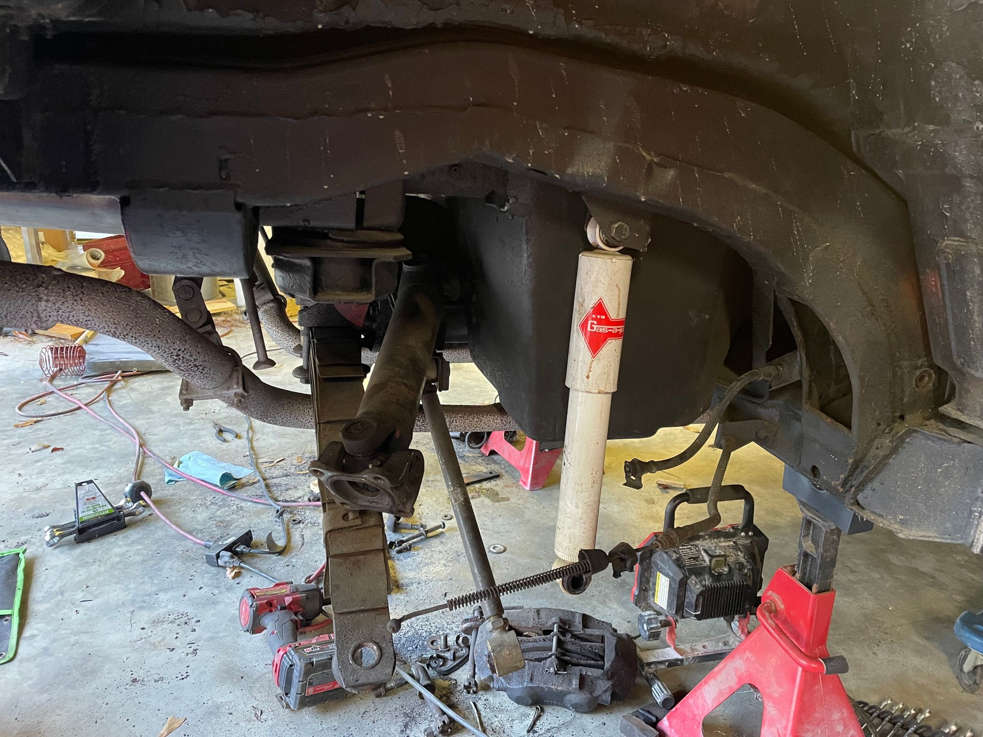

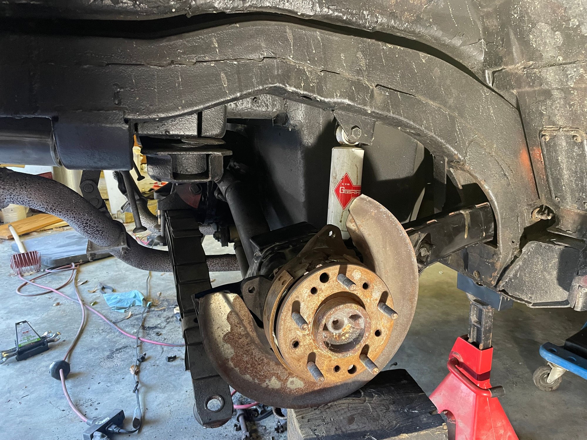

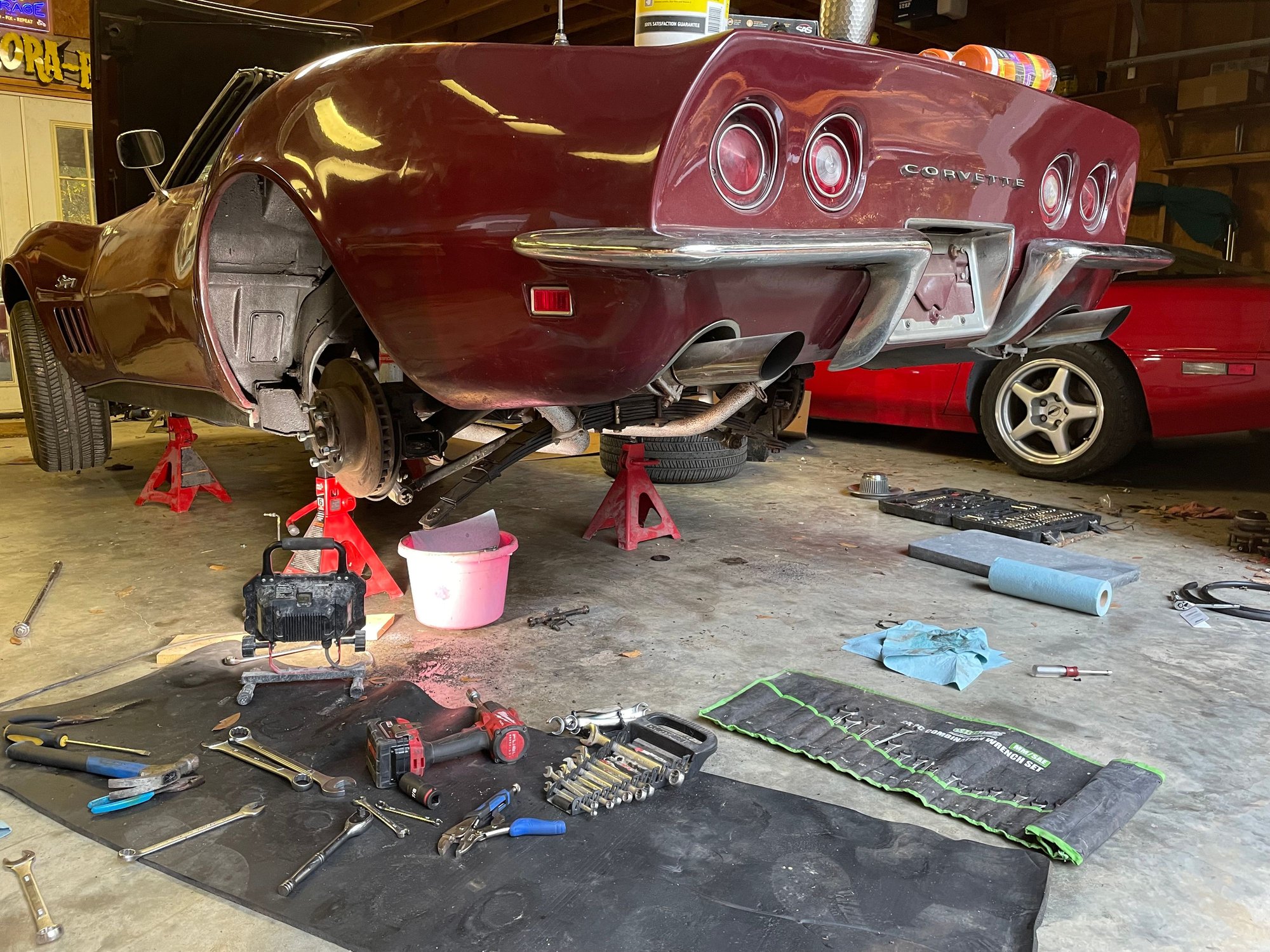

Now we know the drivetrain is properly functioning it was time to make it stop and address the suspesion issues: trailing arms have play and poly strut arm bushings are completley shot! Not too mention one of the front brakes leaks so the brakes didn't work. I decided to take the bull by the horns tonight and start pulled the rear suspension apart to replace the trailing arms and bushings.
Got her in the air and went to work without too much of a fight
An hour later, the drivers side was out
It was nice to confirm my findings of a beautifully rust free rock solid frame!!

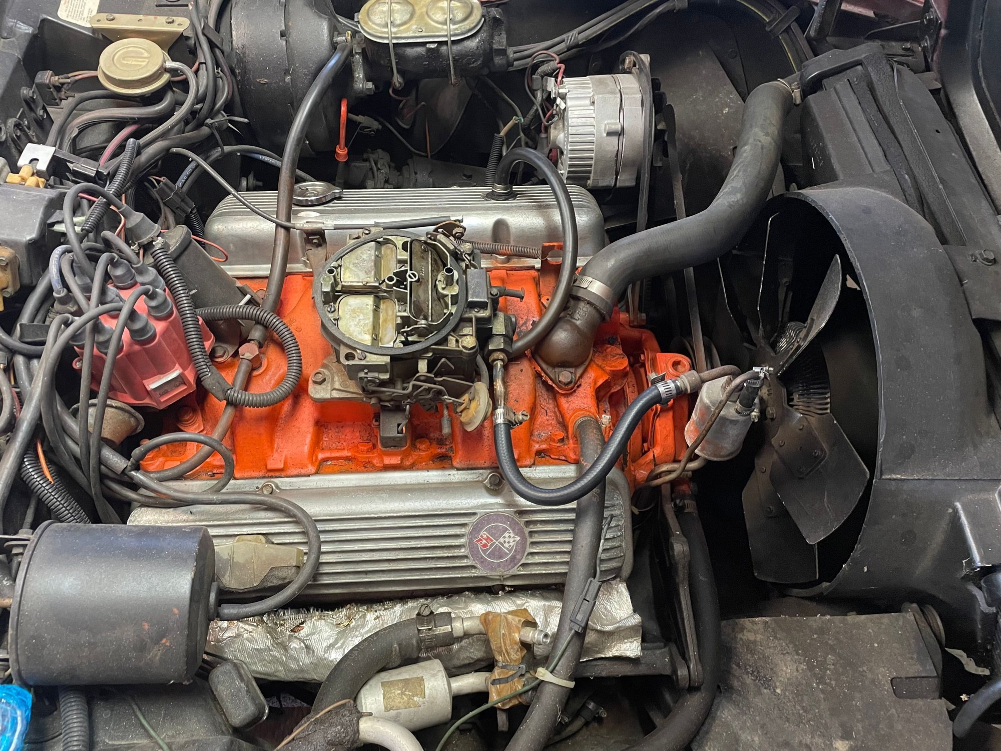

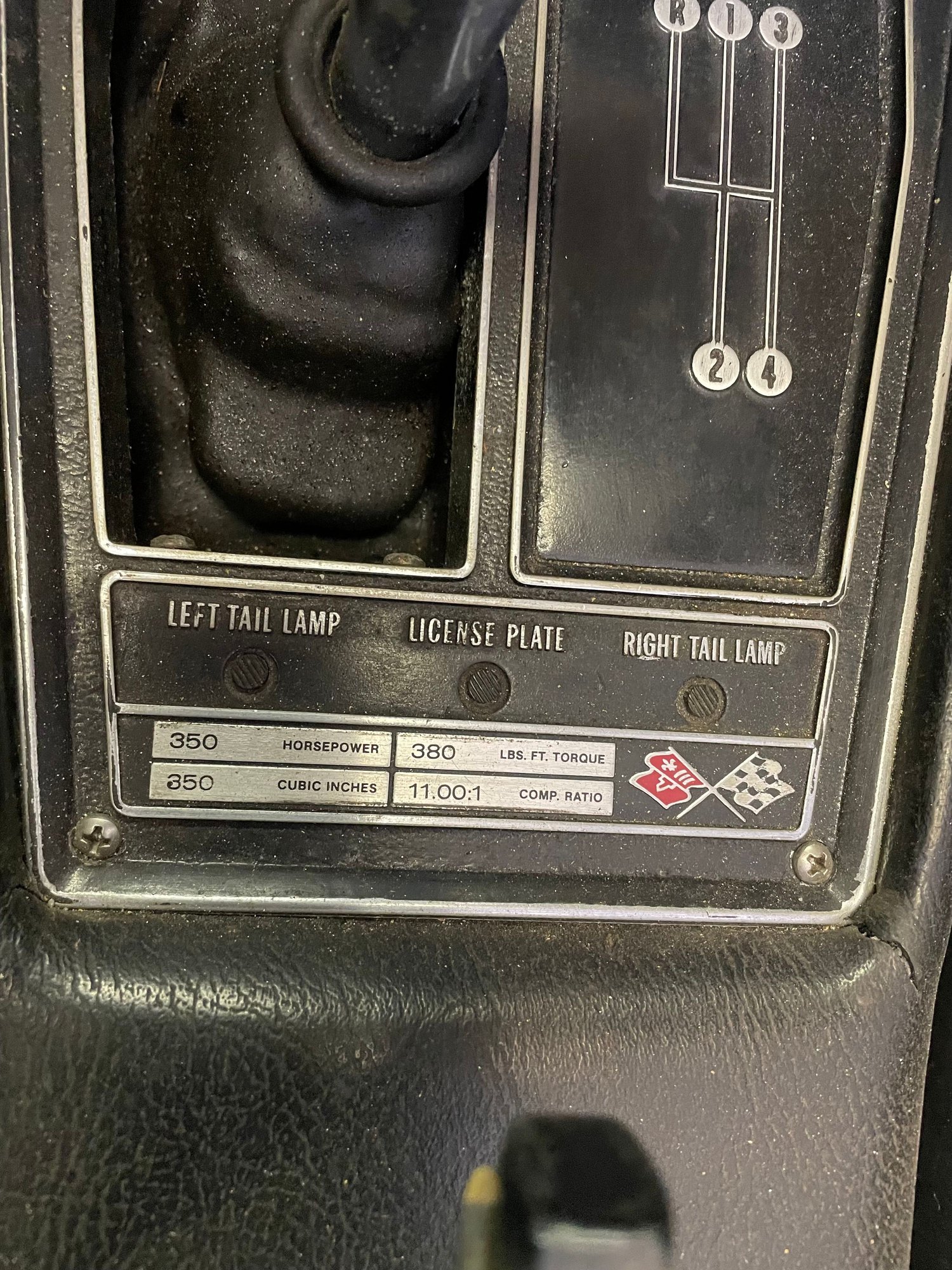

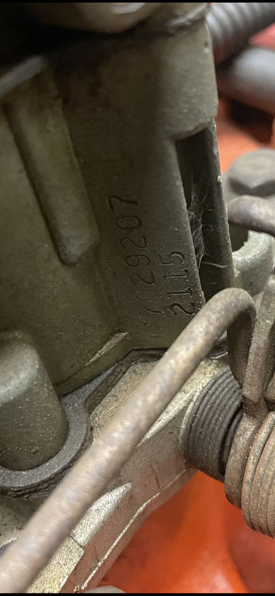

This car keeps getting better: it's an HX code L46 Convertible!!!!
Seller told me he wasn't sure if it was numbers matching and I couldn't clearly make out the engine code from it being decked, so I priced accordingly... After doing some research it does indeed appear to be an HX L46 with AC, PB, PS, & Pw!
Indicators:
Correct L46 heads and valve covers
Correct 29207 L46 only Quadrajet
6000 redline tach
L46 console plate
L46 only fuel filter with return
numbers matching M20 - and I confirmed an L46 could be ordered with the M20 or M21
CF code emissions sticker
block is correct 3970010
Im going to have to get an acid stamp pad retrieval done , because you can see it there but not make it out. If it is numbers matching, I hit the jackpot! If it's just an era correct block with all the correct parts on it and a real L46 car = still super happy!
Experts take a look and tell me what you think:
Here you can see the L46 console plate
6000 reline tach for L46
CF emmission for L46
29207 Quadrajet only on L46
Proper heas, valve covers , an fuel filter with return for L46

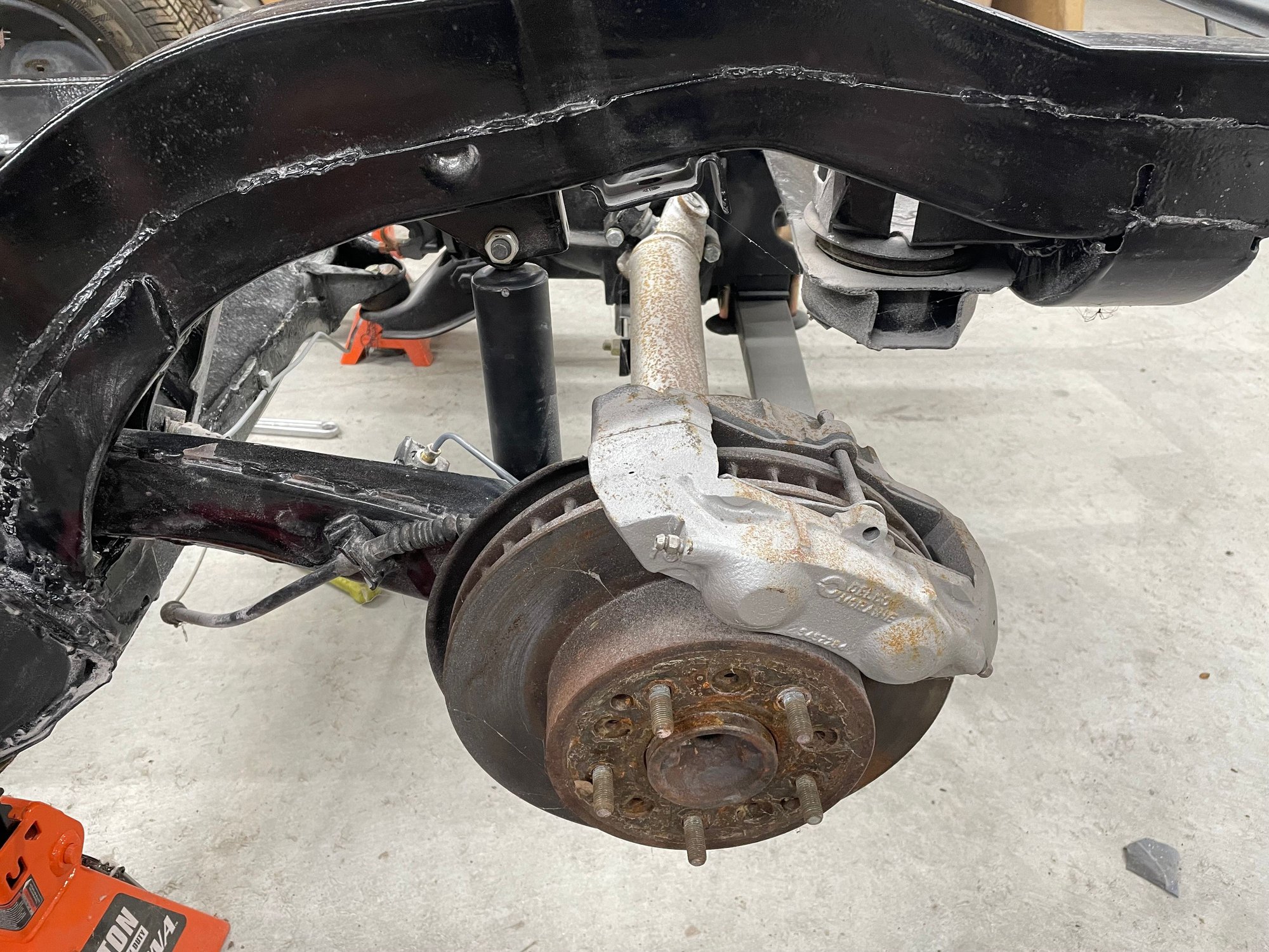

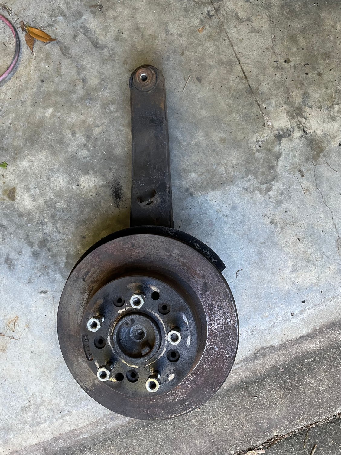

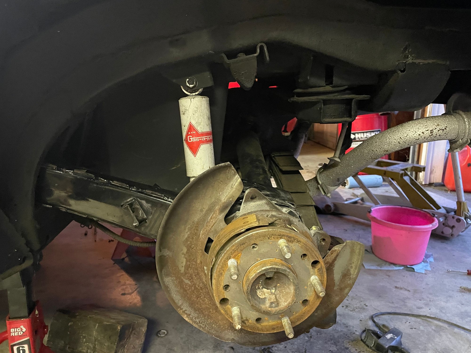

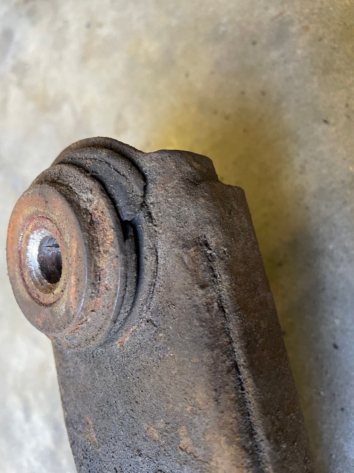

Finished getting the passenger side trailing arm out tonight and have the rear suspension and brakes fully gutted
No surprises here: nice solid rust free frame!
The drivers side trailing arm bushings were completley shot, but the bearings didn't have too bad of play:
Passenger side was a different story: bushings shot and the bearings had horrible play!!
So I have a '71 I'm building with a built chassis sitting in my shop and decided to steal the trailing arms. These were redone 10 years or so ago and in good shape, but not perfect, and decided I coudln't justify having them redone on the '71 . Perfect for the '69 though and if I have to pay for a set I'll get a pair of Van Steel offsets built for the '71 and steal these for the '69 to get her on the road!
