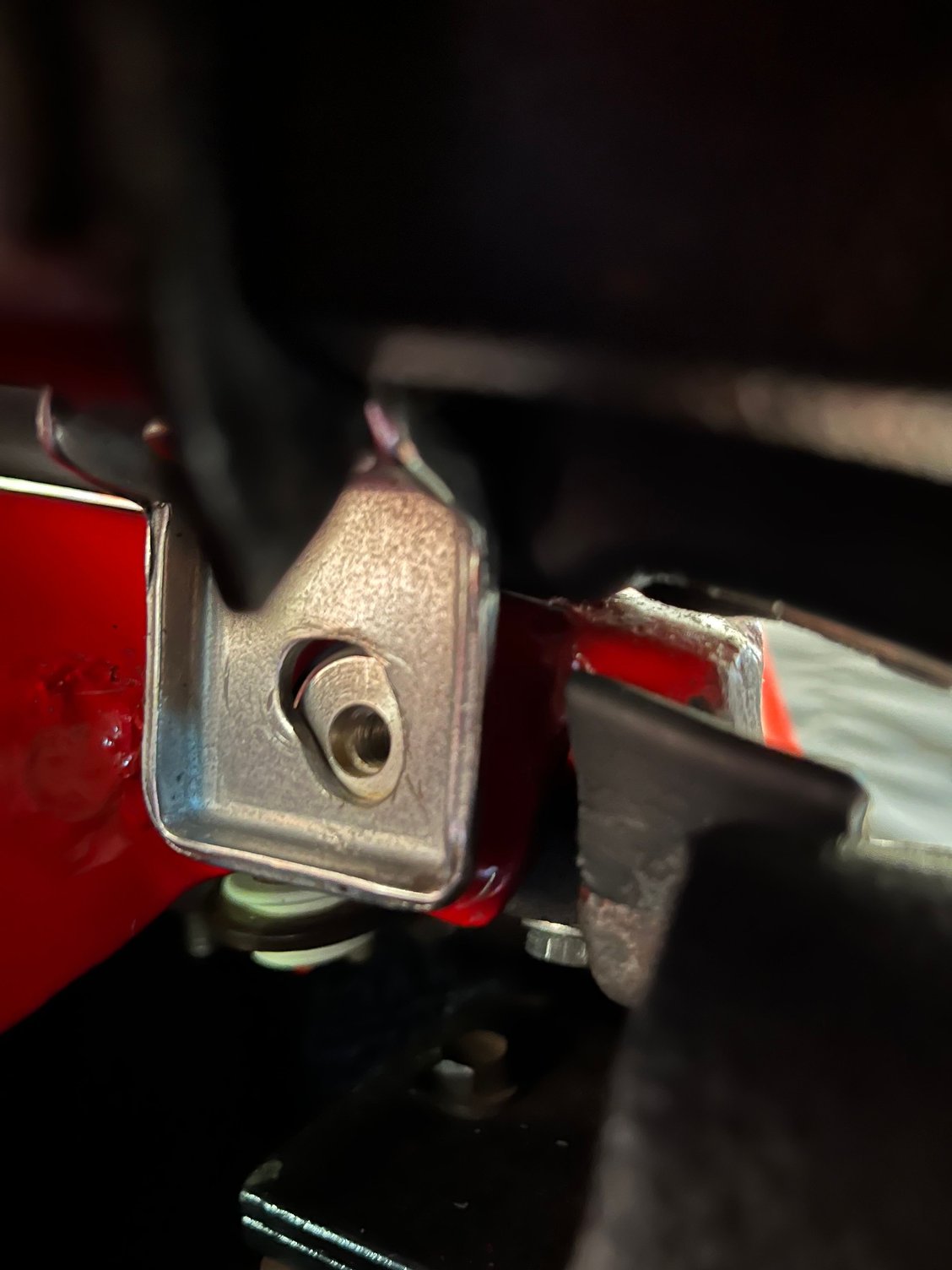

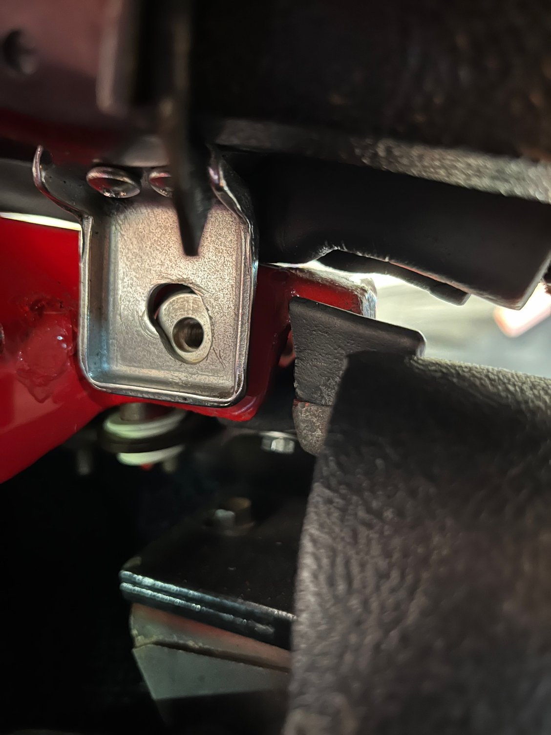

Here you go
You can see the bracket on the hardtop, left front of photo
I made these to keep the long bolts from scratching the rear deck

Originally Posted by Eliredandblack
Here you go
Thanks. My hard top has the same lock in place pins installed as the soft top. My rear deck is already scratched up from the hard top and will get a repaint down the road. That's how I assumed the threaded inserts went, but this is the first photo I have seen of the side of the rear deck lid with them installed.
Thanks. Will order from Zip this week.

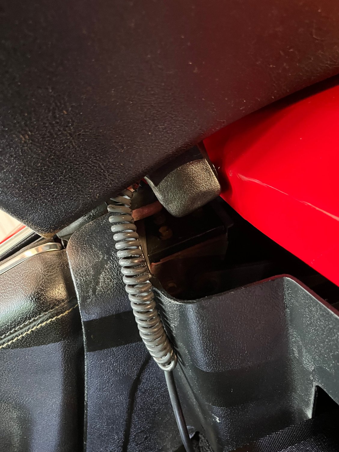

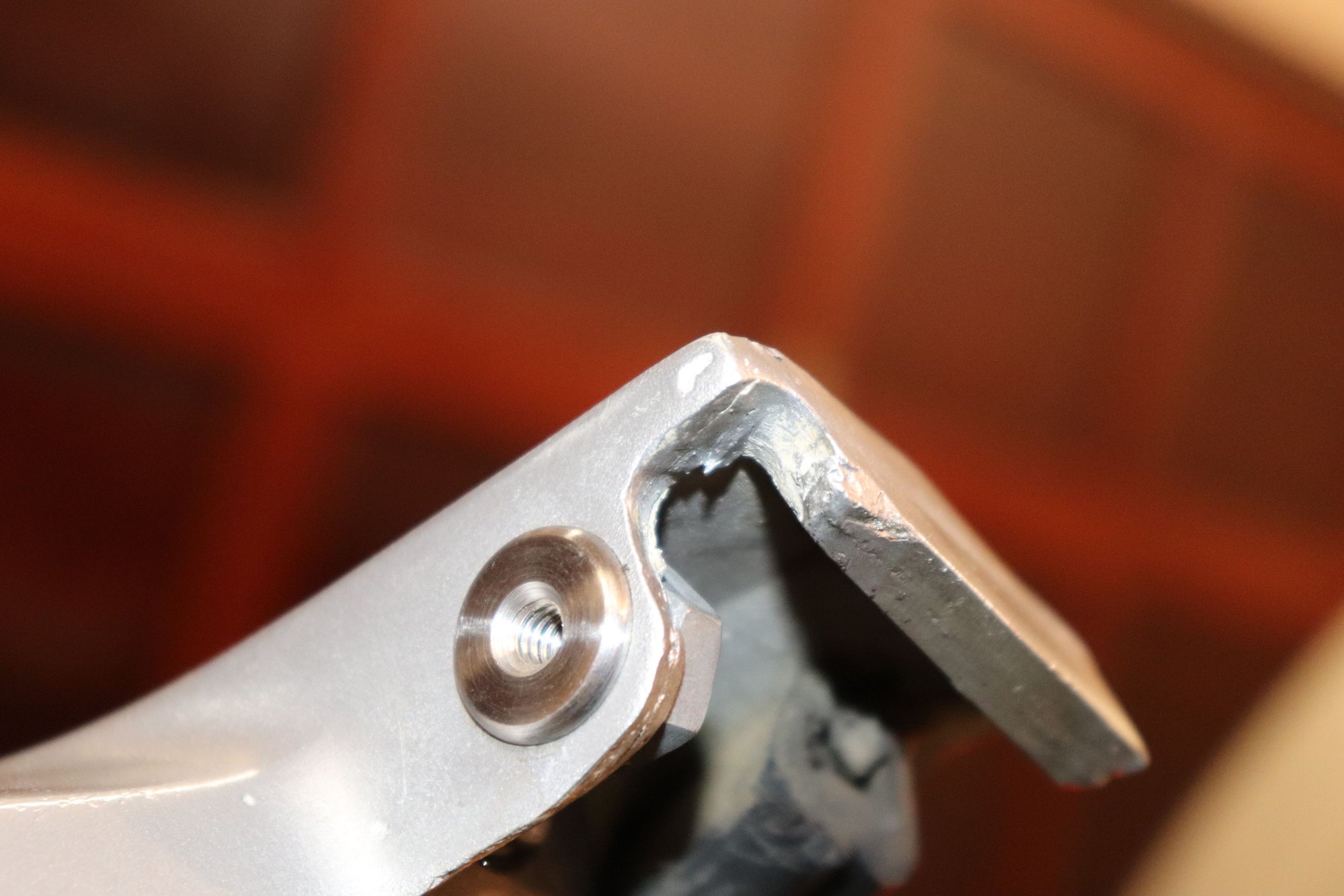

A few more pics.....
Thanks so much. I just ordered the hardware from Zip.

Be extra careful when drilling in the side of your rear deck. Theses cars are old and we don’t know what punishment they have endured. Good Luck, go slow, you may have noticed that one bracket has enlarged hole, adjusted to fit receiver on side of deck.
I wondered why only one side was adjustable. It seems like both sides should potentially be adjustable.

The hole I drilled in the rear deck was off, so I reamed out the bracket hole to make bolt fit, very Bubba thing to do.

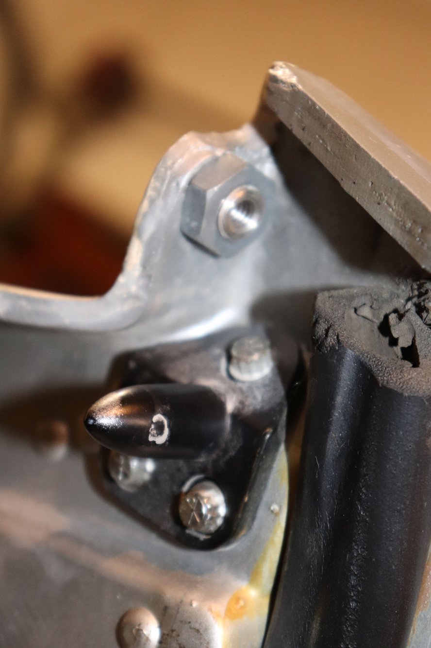

Is there not also a bolt in the center, under the glass, for rear attachment?
( see picture )
[ [ asking for a friend,, lol ,, 😂 ] ]
