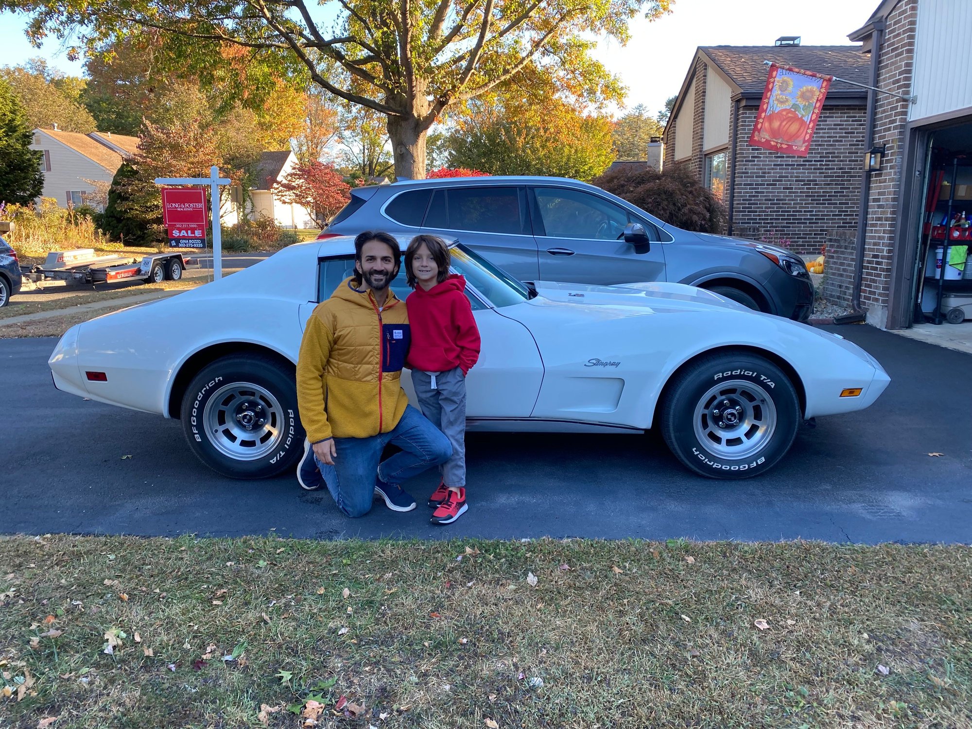

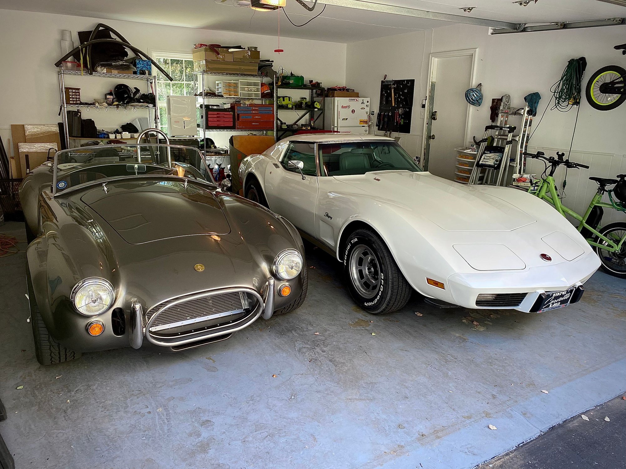

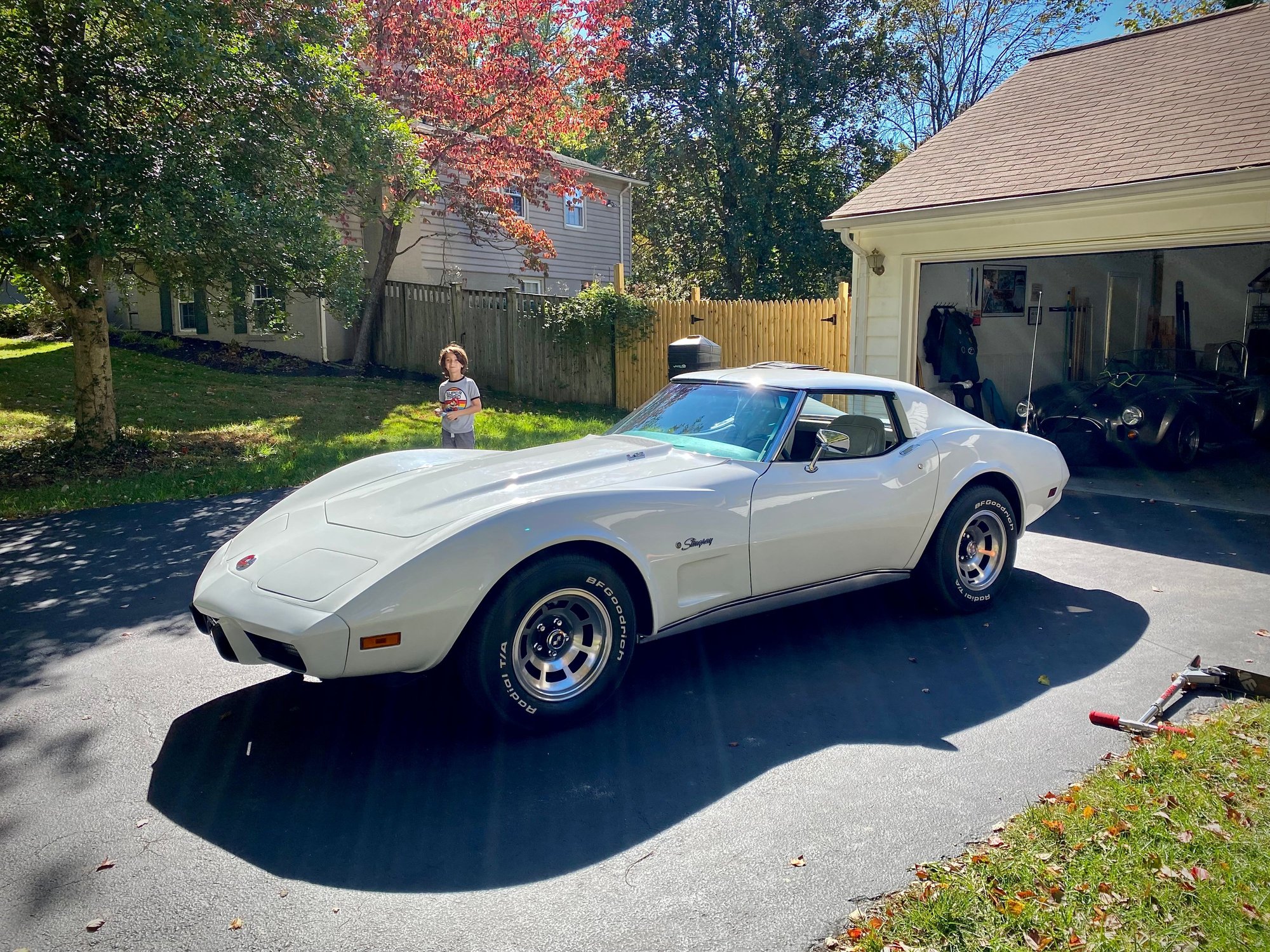

Hi all,
First post here, as I am new to the Corvette community! I just picked up a 1976 coupe with 23,500 original miles on the L82 4speed. It looks great as you’ll see in the pictures, and my 8 year old son and I are thrilled.
Last year we built a Factory Five Mk4 Roadster (cobra kit car) with an LS3 / TKX drivetrain. We took that heretical route because I want to be able to drive the car very often and without worry on short and long trips. And we do exactly that. I drove it drove 300 miles for my anniversary with my wife, and 600 miles for a car show with my son. There are months where we’ve put 1000 miles on the car. I even take it to get groceries and for Home Depot runs!
I want to make my C3 into a similarly dependable car, but I am also new to the car building hobby. To be honest the cobra was very simple as I ordered the kit already designed for an LS. Before that the most I had ever done was change my own oil. I’m nervous that the level of customization to put an LS into a car that wasn’t designed for it, as well as the cost, would be a barrier. For example, my gauges, headlights, and wipers won’t work on the C3. The mounts would be all wrong. Etc.
Another important piece of information is that I don’t plan to track or race the car ever. Power is not important to me, reliability is. I want to be able to take the car anywhere I want, at any ambient temperature and altitude, without worry. 350hp or 450hp makes no difference to me.
So with that being said, I’m considering two options:
1) LS3 again. I know it, it’s bulletproof, and I trust it implicitly. But it’s also very expensive and will require a lot of customization.
2) Blueprint 383 with multiport fuel injection. Pricing it all out, this would be a $10k cheaper build than the LS, and it has a 30 month 50k mile warranty. Plus it will be so simple to swap it in, as a SBC for SBC direct exchange, so I could do it with my son as a father son project and there is value in that. The issue is I don’t trust that an EFI system developed by Blueprint will be as reliable as one by GM, who spends more money on office supplies than Blueprint does on R&D. Not that I don’t want to support a small business, I just want something that is extremely reliable.
Am I wrong to not trust the Blueprint offering more? I really like the price and the warranty and want to go with them if I can be convinced. Are there other options I should consider to achieve my goal of a daily driver and road trip ready C3?
Thanks for your input!
