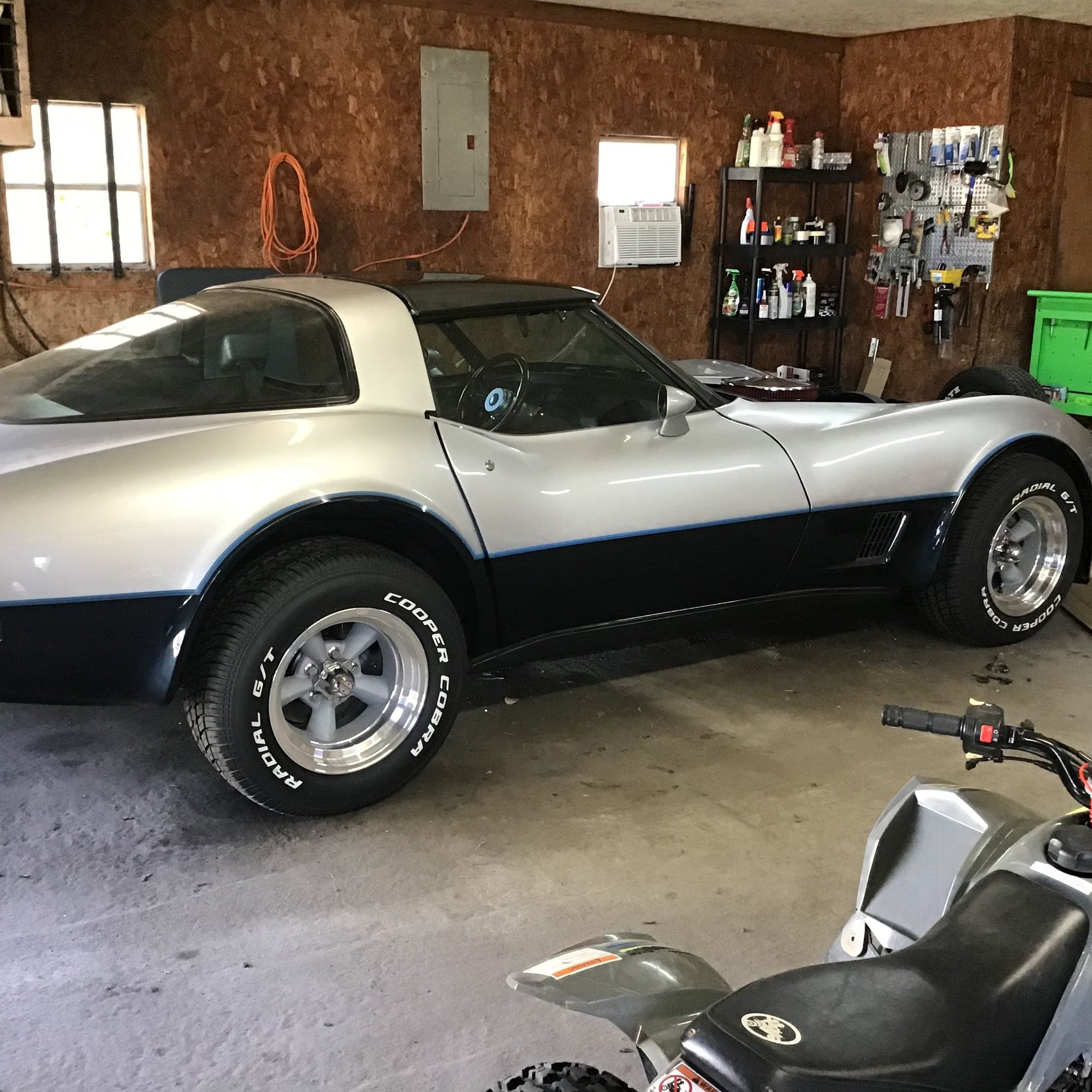

After being at a shop for the last 3 months,a 1981,he replaced rear differential,new trailing arms,new bearings new rotors,longer leaf spring bolt because I wanted the back dropped some,new shocks,new bushings and all new u joints,and new adjustable struts. I picked up and some followed me,I also have new wheels that are offset,and had to use 1/4 inch adapters to clear calipers,my friend told me that on drivers side he could see the fron tires following me,which I also have adapters on the fronts,so it needs lignin up,especially the rears,when I got it home on level ground noticed the divers side front and back,the gap between fenders and tires were much closer than passenger side,and I don’t trust anyone doing this,so DIY,or try too,where to begin,everything is new,pretty much,and I’ve heard of using string line down side,but I have different size tires 235 Fronts, 255 Rears. So,any recommendations thanks.

Well,it needs to be adjusted,my issue is tires are not running straight or if your behind me,you shouldn’t be able to see my front tires or drivers side front sticking further out than my rear tire. It’s like not tracking straight.

Spacers on all four,and the shop said that they put shims like it came out,but like I said,new wheels,which are 8.5 wide,offset,and on one side can tell is leaning at top.
