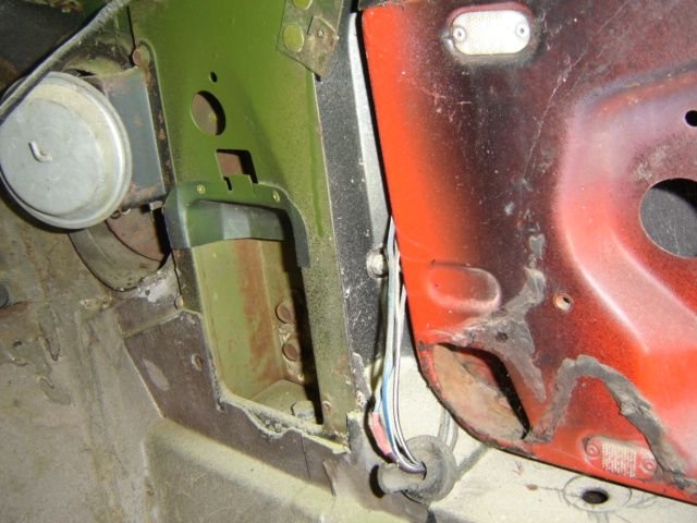

Need some experienced opinions, please.
I’m on the hunt for a nice 69-72 lawn-show quality C3 with solid birdcage and frame. I thought I found one, only to learn the insides of the frame rails back by the doglegs were kinda scaly. Outside of the frame rails looked good, but the insides not so much. All felt “solid”, though.
But then I found a rather randomly placed rust hole on the inside vertical wall of that same rail. I can stick just the tip of my finger through it back near the gusset. Everything and everywhere else looks & feels super solid. Is this something that makes me walk away and continue my hunt elsewhere? It’s priced very fair market value and the seller said he’d come down to offset such a repair. I wouldn’t be tackling it myself, as I’d have a pro do it. Not sure how cheap it’d be because I don’t want a bandaid style repair. I want it done correctly so it’ll outlast me.
I’ll try and attach a pic. Thanks everybody!

Have you thoroughly checked the birdcage for rust?

I think so? Care to list the most prone areas I should be looking closest?

Every section of frame is available. Minor welding project for some, and others see it as a major catastrophe.
How much rust is too much is definitely a personal decision. But finding a car over 50 years old that hasn't had any panels replaced and has zero rust could prove to be very difficult.

Check out the #2 body mount, by removing the interior kick panels. is a good place to start.

imo this area is one of the most important.

My frame looked like yours and had rust at the kick ups. I bought the 12" patches, cut out all the old tusy metal, welded in the new , then had it all sand blasted and powder coated: good to go!

You see that above, that's my point. Every section of these frames are available.
on my frame my kick ups were/are fine. But the bottom under the door was rusted. Just the very bottom. Sectioned in replacement panels. You would never know if you didn't know.
But, I can weld.
A perfect frame? It's out there. Best of luck.

Only way I'd dive into that car is if it had some sort of sentimental value or it came real cheep.... A hole in the frame you can stick your finger through!!! Keep looking... There are tons of frames out there with no holes, maybe surface rust that can be easily delt with...

The only car I restored was a 64 and it had rust in that location. I could not put a finger through until I started probing and hitting it. Ended up learning to weld and replaced a small section on both sides. It came out fine for me. Built the car and didn't look back. If you don't want to pull it off the frame I would pass on it.

Windshield header, base and A posts, #2 and #3 body mounts, u- channels under the sills.

Good move. That frame was full of course rust scale in every picture I saw. Frankly I'm surprised nobody brought that up.

Every picture??? There was but one picture.
One small hole? One small welding project for some.
AND, As I stated earlier, a catastrophe for others.
If it was a really nice car otherwise, and we really don't know. One small hole wouldn't have fazed me.
How much rust is too much? We all have different levels of acceptance.
