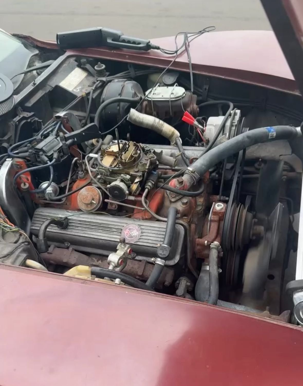

I went to go buy the car yesterday​​​​​​. about 28 degrees out and snowing. Didn’t take my vette for obvious reasons. Tried to get it started again, but it had a dead battery. Newer battery, but the map light was left on.
After jumping it we tried cranking it with a timing light hooked up, no flash. We were getting power at the pink battery wire to the HEI, but no spark. The ignition coil and module were replaced a few months ago, and I made sure the module was installed with plenty of heat sink compound. Tried a coil and cap that was known to be good off my car. Still nothing.
So we’re dead in the water currently. I’d really like to get the car inside to a heated garage rather than out on the street, especially because the salt came out on the roads in Minnesota last night. I’ll be going back tomorrow with the entire distributor out of my car to see if that will solve the issue. My guess is the ignition module went bad, despite only being a few months old. That or the pickup coil.

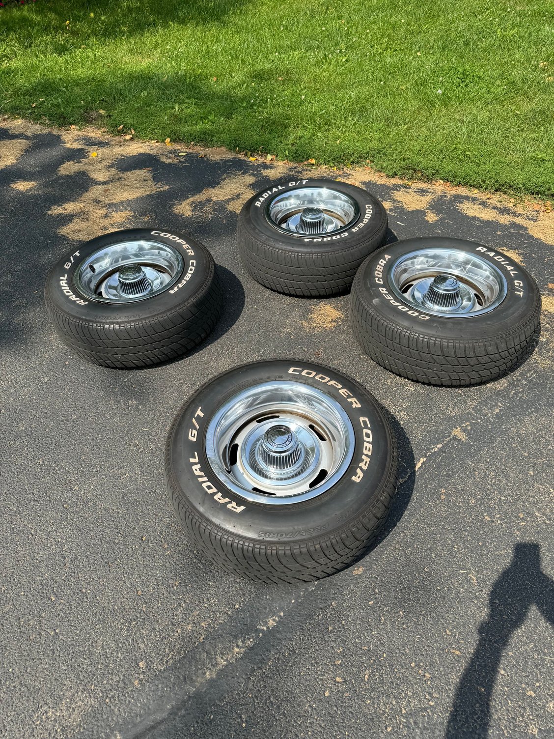

Another thing to note is those tires. Goodyear Eagle STs. The date code is on the inner sidewall, so I’m not exactly sure when they’re from, but from what I’ve seen online they were discontinued in the 90’s. Scary.
First thing I’m doing is slapping these on. They came off of my car.
On a positive note though, I do believe the car actually has 7,600 original miles rather than being rolled over. The interior except for the carpet is in great condition, just a little bit dirty. It should clean up really well. Can’t wait to get started on it.

Woke up early on my day off to get back to this car.
I pulled the good distributor out of my car, bought a new grade 8 hold down bolt +75¢, and went to put it in the car. Even with my offset wrench it was difficult to get to. I eventually had to remove the vacuum advance and modulator line to get it, but it came undone.
The car probably has a parasitic drain somewhere. Even after charging the battery it required jumping again, but after that I was able to get it started.
Putting a timing light on it with the vacuum advance unplugged I wasn’t able to get a reading until 63 degrees of advance. Clearly the balancer is slipped or was changed out to one with a different marker. No biggie, I turned the distributor until I got the highest idle, made it slightly retarded, then plugged the vacuum advance back in. Should be good enough for now.
I also noticed the choke pulloff was bad, luckily I had brought one of my 17059216 Quadrajets in case we had issues with this one. Two screws later and the car now has one that holds vacuum and takes two seconds to fully extend.
Took it for a short test drive. Ran good, the brakes are GREAT (I should probably rebleed the ones on the white car.) The 1-2 shift was a little firm, but the 2-3 was softer. The car was sitting for a while, but that might also be a Turbo 400 thing I’ve never experienced before.
The owner gets home at 5 today, after that I’ll be buying it and parking it inside where it belongs. The roads are clear of snow now, but I know the salt is still there.
First order of business will be fixing the distributor. My guess is that the new ignition module failed, but I’ll be checking the pickup coil too.

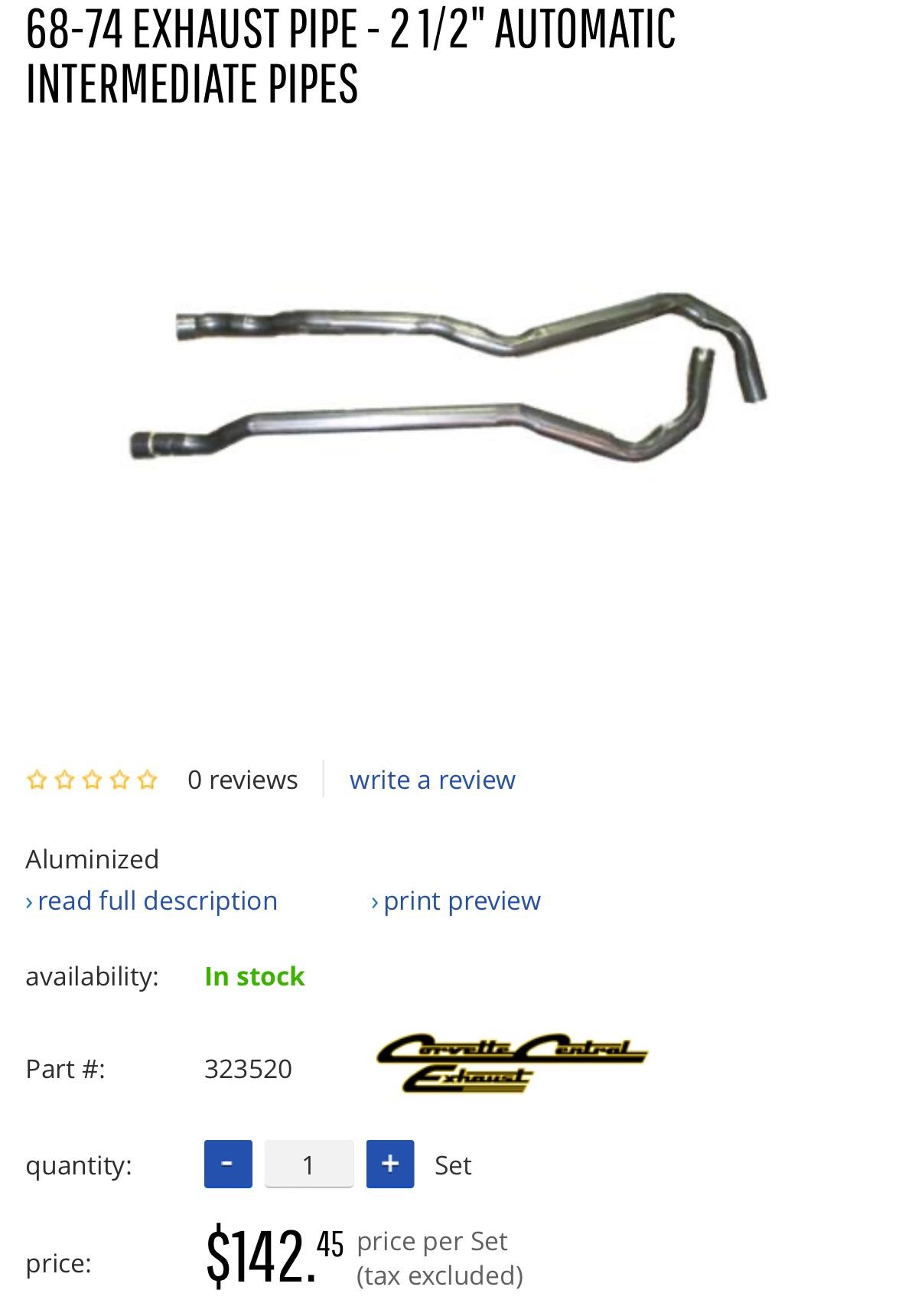

Piersonpie deleted comment.... my suggestion about using 2.5" 64-65 downpipes with 2.5" speedway smoothies is for a MANUAL car.

Originally Posted by carriljc
Piersonpie
Not sure how much work you want to put into this? Or if you're getting rid of the cat?
NOTE: THESE 64-65 DOWNPIPES ARE FOR A MANUAL CAR.
But if you are getting the 2.5" speedway ramhorns just buy the 2.5" 1964-65 downpipes.... they'll attach to the rest of dual exhaust system and run all the way back. I did that on my 68...... you're not planning on keeping it or I would suggest the speedway 2.5" smoothies..... they stay looking good and don't need any cast iron protection. I did install a 2.5" heat riser "spacer" just to avoid annoying exhaust alignment issues.
I'll find the link for where I put that full 2.5 inch system in --- in case you want to read it.
Found it...here is the thread on using 64-65 2.5" downpipes: https://www.corvetteforum.com/forums...post1598259107
Looking at the ‘64-‘65 downpipes they look very similar to the Corvette Central piece, about the same price too.
I do plan on getting rid of this car, but I still want to treat the manifolds. I’ve heard good things about Seymour’s “Cast Blast” paint that holds up really well over time.
Thank you for the tip about the spacer, I’ll give the thread a read too.
