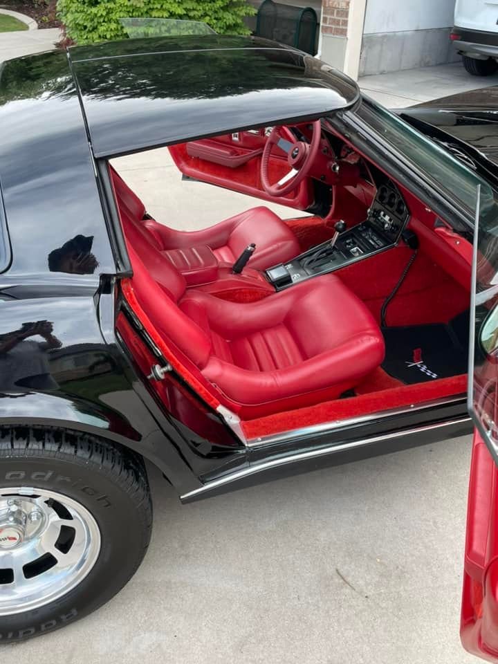

Hello! And welcome to our forum! Whooo Hoooo! I have one of those! Seriously, just picked mine up as well. Well, July of 1989 if I remember correctly. Been just a couple weeks. Best of luck with yours. Mine has been on the road and in use since spring of 1977. Still driving mine quite regularly.
Here's mine.

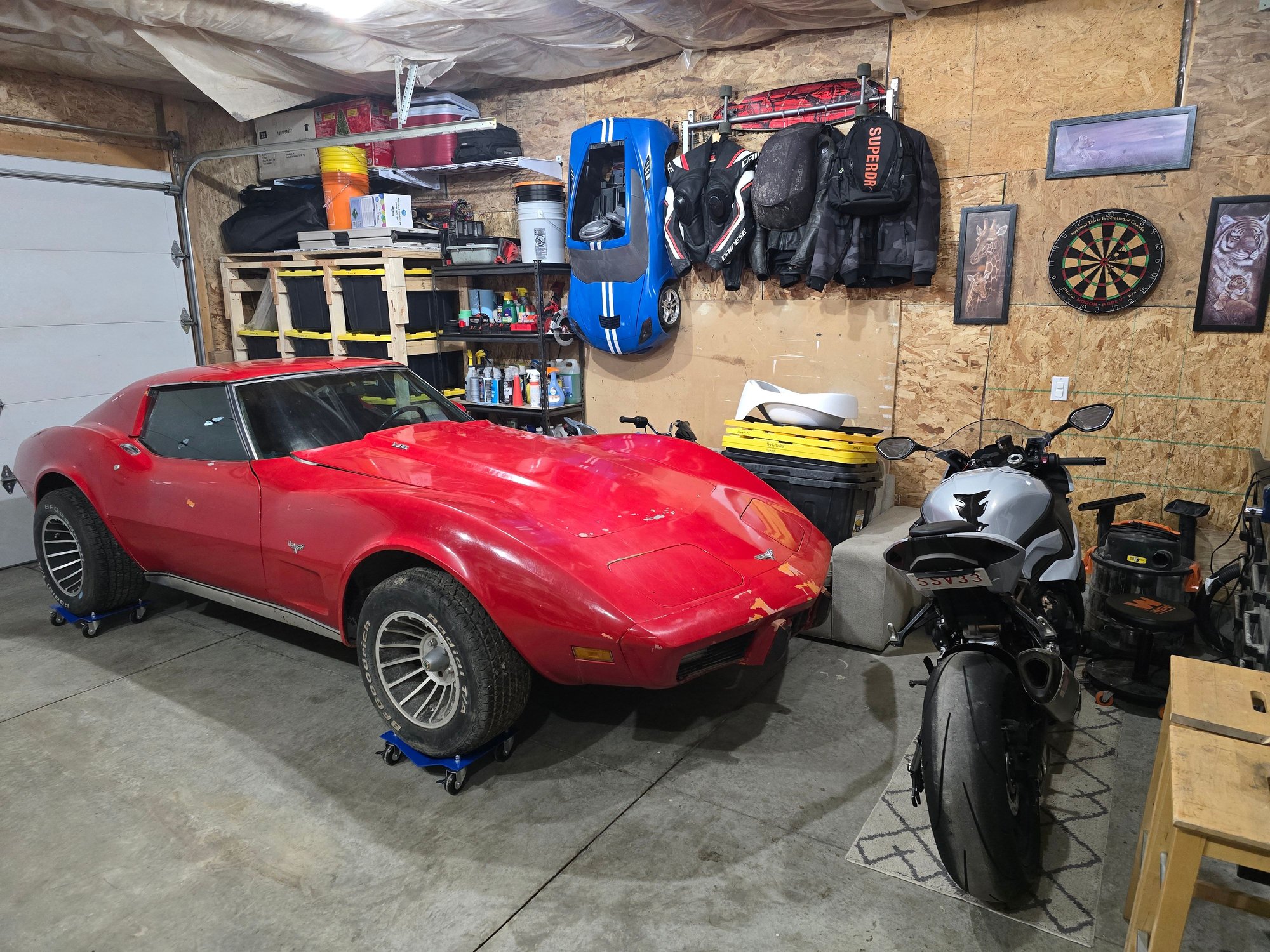

Wow friendly group!
Thanks for the advice, gives me a good starting point. I bought the car yesterday but won't have it in my garage till this weekend, more pictures will come.
Underside looks to be in good shape, minor surface rust but nothing too concerning. The interior is currently in pieces so my first focus is getting that back together but should be pretty straightforward. The car has new tires and wheels, new exhaust, new carpet and I bet a few other new things that I don't even know about yet.
I'm in Alberta so no smog requirements that I need to worry about.

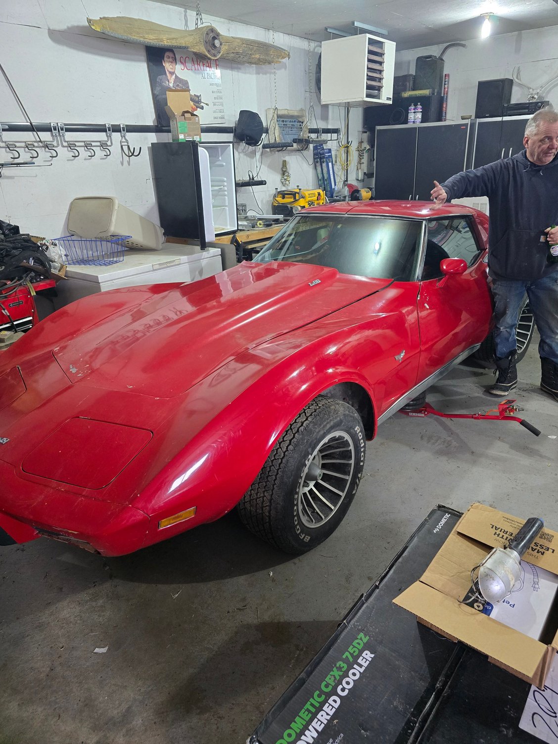

Finally got the car home last night, picked a terrible night to pick it up. -25°C, fog, frost, snow and turns out the heater core in my truck is plugged up again so the hour and a half drive to and from the seller was... Uncomfortable haha.
Totally worth it though!
Also found out the car only has 40,000 miles on it so that's pretty cool

Those wheels are my favorite part of that car.
