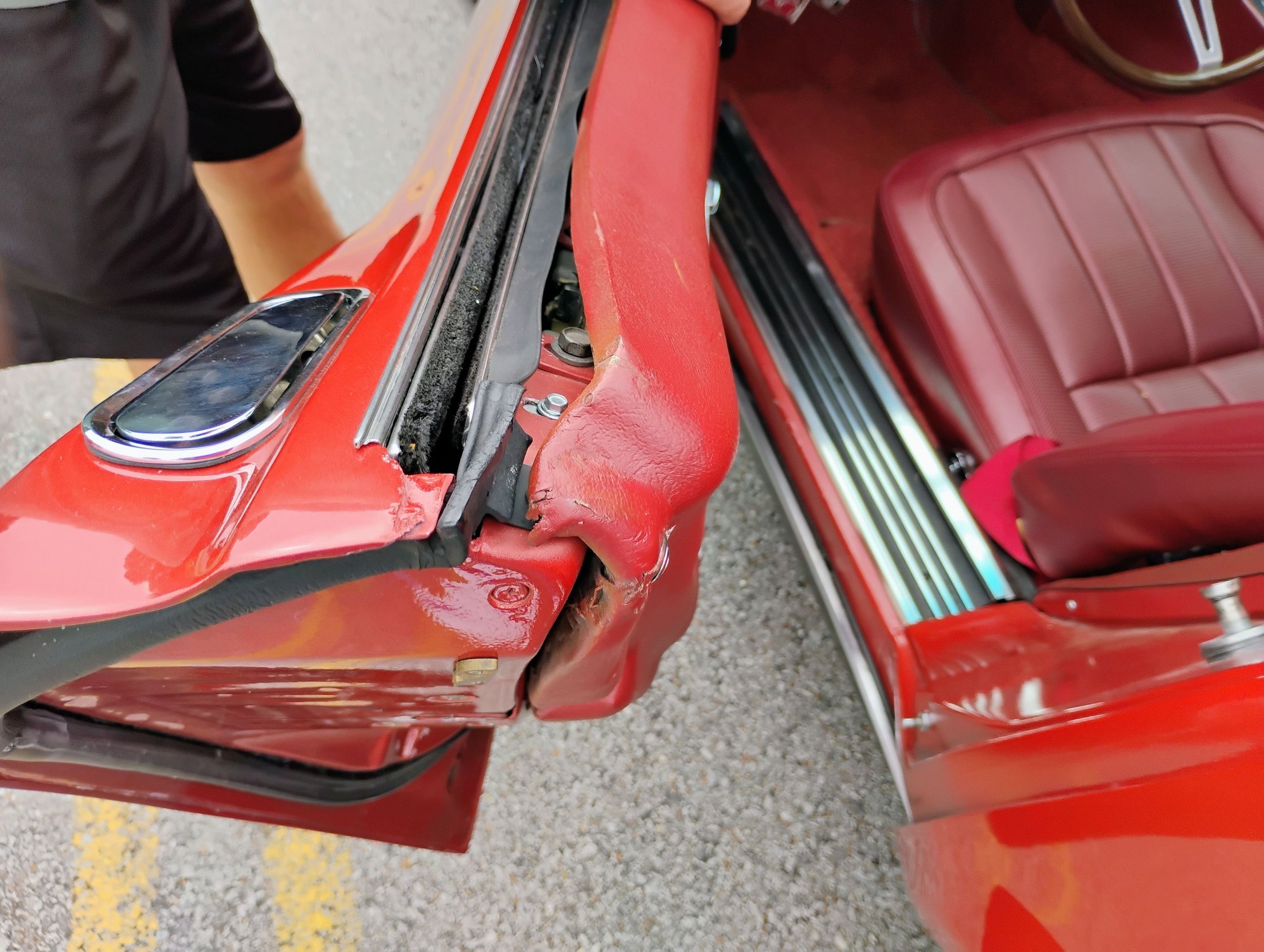

Here is what I am dealing with.
Have you tried removing the panel, applied heat from a hair dryer and then reinstalled making sure the upper lip is engaging the top of the metal panel?

They have the fiberboard backing. I was thinking of steam or a damp hot rag to soften the area then going back on. I was just wondering if anyone else had done a similar repair before.

To me it looks like you had water intrusion and that is why the panel warped. Al Knoch makes both original fiber board panels and ABS ones. Top Flight Automotive, that use to be called Corvette America, is the only other company making Corvette door panels and they are ABS. If you had to, you could get a new fiber board panel and dye it the dark orange color. Lou.

Hot sun and get them soft enough to bend and clamp. You may need to make a jig and force it straight enough to cool into the original shape
