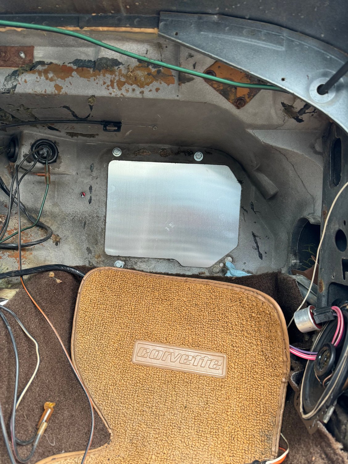

I would love to just keep the heater and get an AC delete cover like this one. I haven't been in there yet, does removing the AC components and using that delete cover make it so that I can no longer use my stock heater core? And can all of this be approached from the engine bay while I'm in there for the swap or do I have to rip apart the dash even if all I want to do is delete AC and keep heat?
Oh, and I have the long compressor style, it won't fit with the Holley mid-mount unit which places the compressor in front of the passenger cylinder head. I'd need to change to a short compressor, and I'm not sure how to use a new compressor on an R12 system.

Most of the bolts are accessible from the engine bay, the last one you have to get from inside the car, but it’s at the very bottom. You should be able to remove it without having to take anything else out.
The cover you linked is the same design as a non AC car, you shouldn’t have any issues running the heat.
