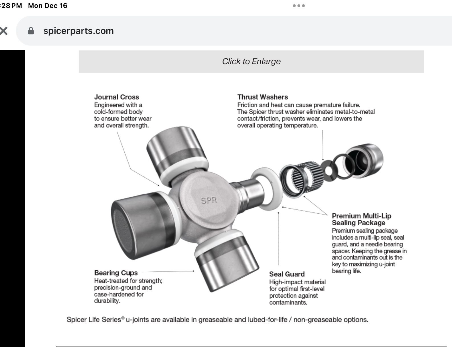

Hello. Wondering what the purpose of the small thin paper washer with a hole in the middle of it is under the cap of a Spicer u-joint. A 1310 u-joint if that makes a difference. Thanks and take care.

Spicer makes several product lines. This is just one from their website.
