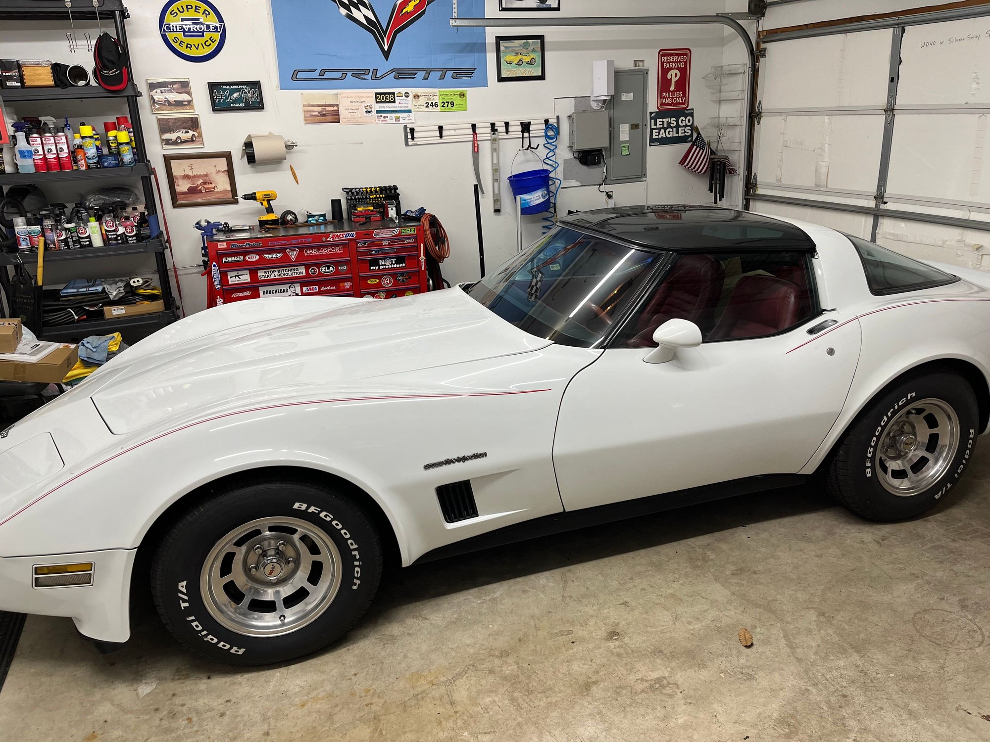

Love my newly acquired 82, but probly cause it has a 350 Vortec with 700R4

very nice... no more iconic color combination than white over red

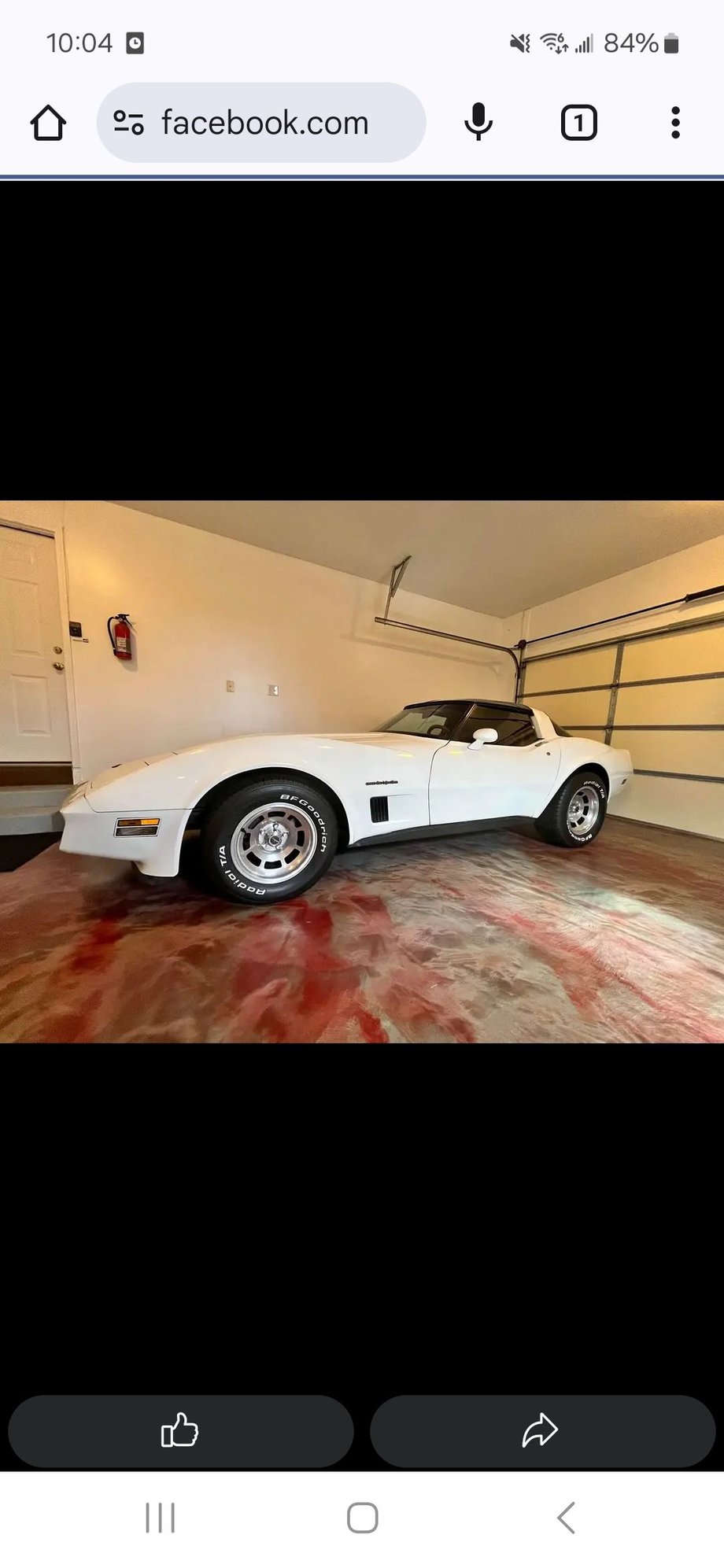

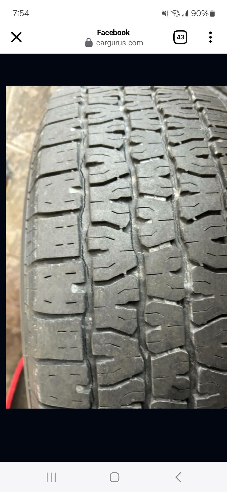

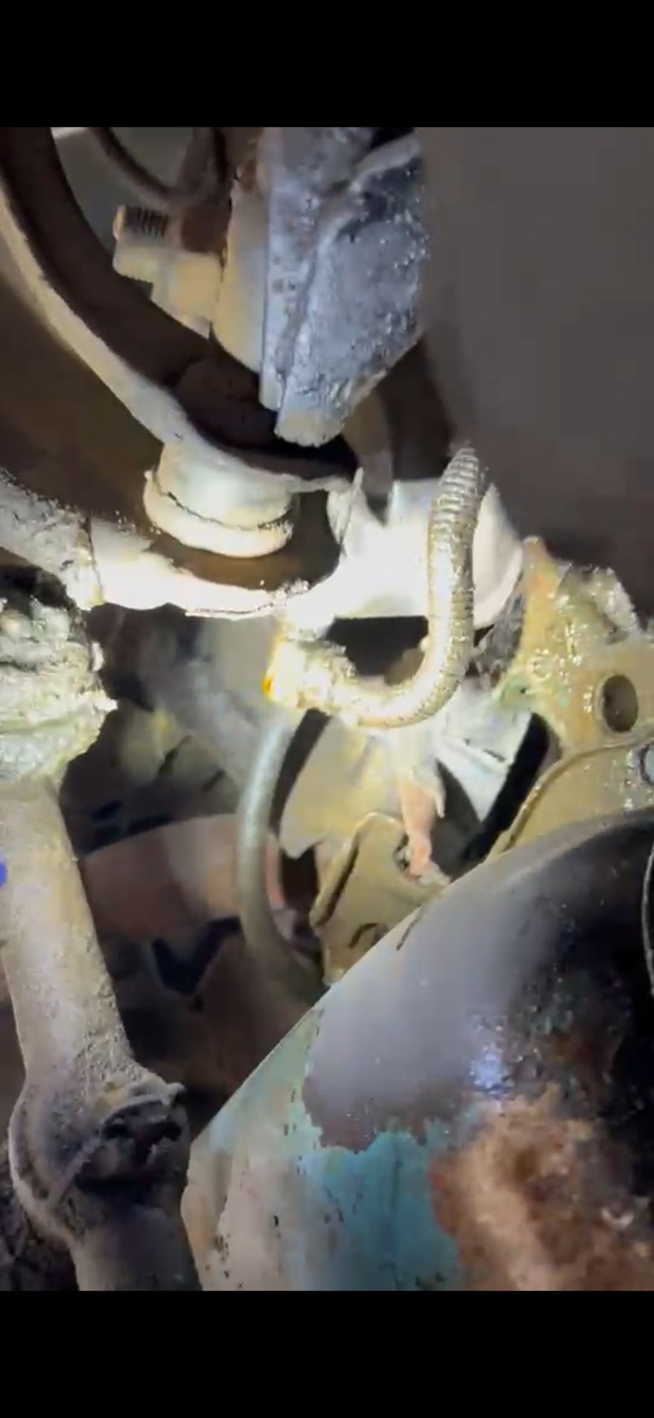

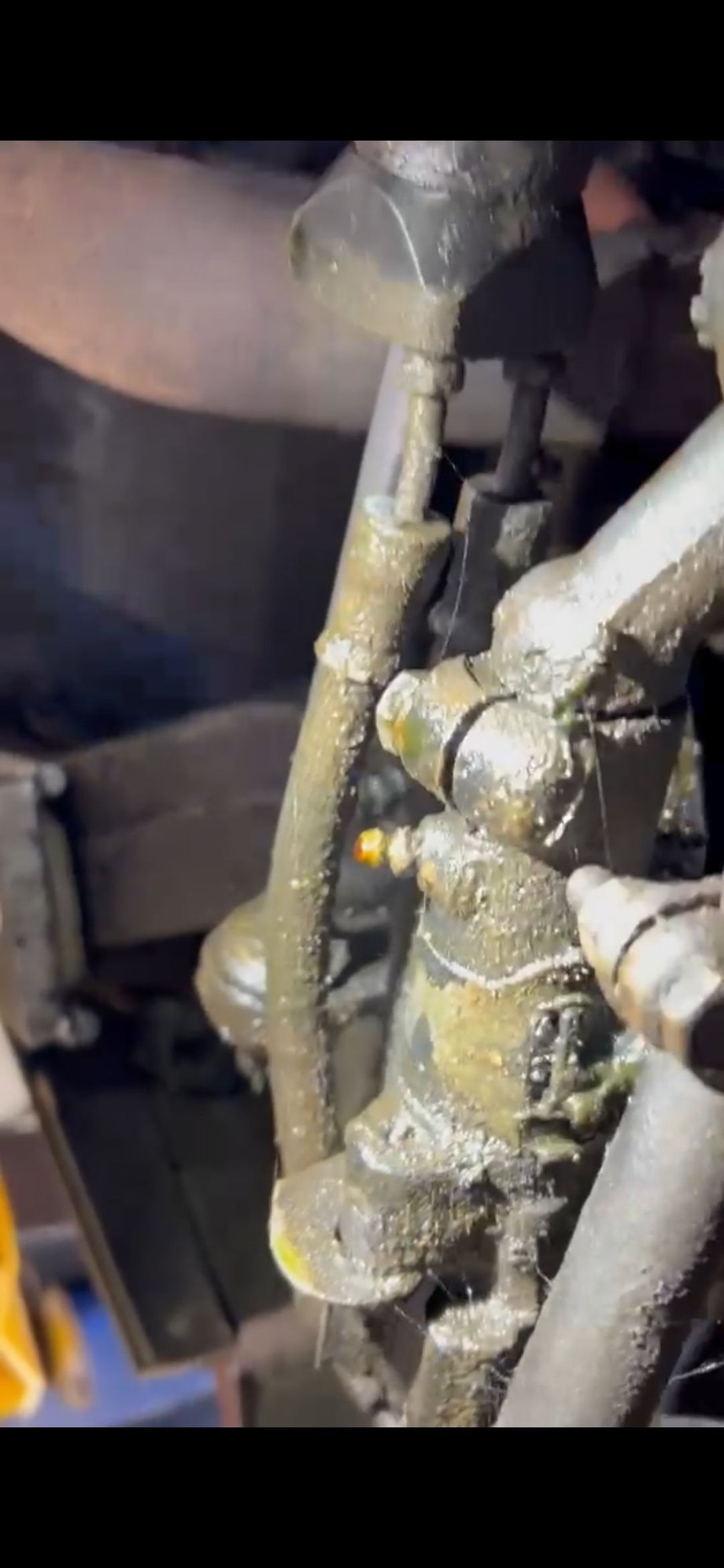

I made an offer and wasn't accepted, they wanted $21,900 and I offered $19k, tires were very old and split and the underside was rough and wet, PS leak, oil pan leak, fuel pump leak at gasket and fitting... and sledged up suspension, didn't match the top side and interior, with over $2k for shipping it wasn't worth it.
The ad said new tires and suspension all gone through with just a few drops of seepage throughout the winter... then I saw the cardboard under it.

That's too bad. You were very reasonable @ $19K IMHO considering, but the vendor very obviously overstated the evident condition of the car. I'd be pissed and tell the guy to his face on my way out the door. Good luck on the next one !!!
