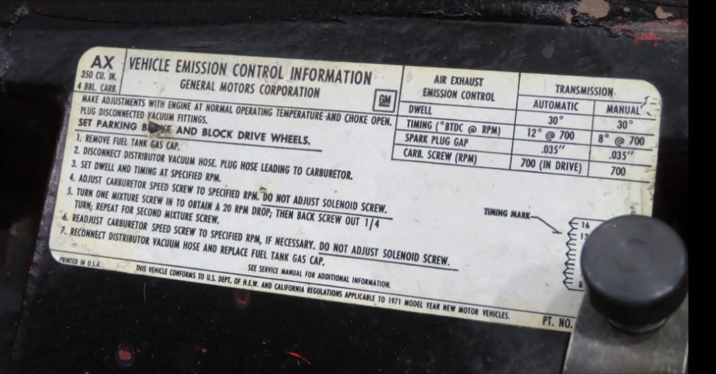

I looked around at some pics of other pads and did see some supposedly real ones with the C fairly closed but also saw one where it was more open. Somebody with experience viewing more pads would need to chime in.
Just for fun, here is the engine in the car and supposedly the emissions sticker. Again, I've not seen the car in person yet. Just going by the pics I was sent.
Well, I just noticed he had marked the ad as pending. I might have missed out on a pretty good deal.
The emissions decal is a repo
Would you mind sharing why? If you prefer, you can DM me so you're not helping the fakers realize what makes it look fake.

Below is a picture of the emissions decal from my unrestored 71 LT1. The decal is original and all original AX LT1 decals were reverse printed.

Originally Posted by 427SIXPACK
What I DONT LIKE is the fact that as mentioned the sticker is a reproduction, pointing to someone, somewhere trying to misrepresent what it really is or was !!
Putting on a repro emissions sticker is pretty darned common -- they are so easy and inexpensive to replace that it's like replacing air cleaner and valve cover stickers. My '72 LS-5 emissions sticker was peeling off, scraped, and looked pretty horrible. I replaced it and didn't think any more on it (but would if I were going for judging). There is nothing about a replaced sticker that should warrant more than passing commentary as there are much more reliable clues to the original engine option.
You can disagree with me, that's ok. I have a number of exact same engine stampings in my library. My database has thousands of engine stampings, trim tags, and factory paperwork. Here is one engine stamping for comparison to the LT1 stamp provided by the original poster:
Wow, there are so many matching characteristics between these two engine stamps! The light V, 1, 3, & C; the heavy 2, 0, G, Z; the weird nick in the 2's center stroke. The only thing I don't really see in the later stamp is the little down-turned beak on the 3, but there's something there on lower stamp, just not the same.
Feel free to send me a private message, and I will answer any questions you have. In addition to the L88 and L89 registries, I have a site, Corvette Validation Services, that helps buyers and owners validate engine stampings, trim tags, and factory paperwork.
....just look closely at the original's letter spacing in between the "steps" and look at the placement of the GM logo vs where it's at on a repro.

Side by side, I now see many other differences such as:
1. Top left corner, the space in the words "4 BBL. CARB." to the line underneath it.
2. Set parking brake and block drive wheels appears to be a lot more bold.
3. Do not adjust solenoid screw ( is underlined 2 x's in both steps # 4 & # 6 )
4. Bottom line spacing ( printed in usa ...................etc, is printed on the bottom edge with no space underneath )
when you removed your emission sticker because it didn’t look good that would put a flag up for me as to why you did it . If any car wasn’t a high dollar car I guess it may not matter . However if you’re talking about 67 427/435 BB that would be a big deal .

Just seeing this now… As Jonathan and Mike have already posted, this look to be a really good stamp. I always like to withhold final judgement until I see a pad in person (you can rule one out from photos, but you can’t definitively confirm until you actually see it in person), but this one looks spot on. Add to that, Jonathan’s comp photo of a pad near this one and I think that you’re good to go on this one.
As far as the emissions label, as others have stated, these get replaced all the time during restorations. Some are better than others. What you can do is save the original for future owners once it has been removed.
Regards,
Stan Falenski
