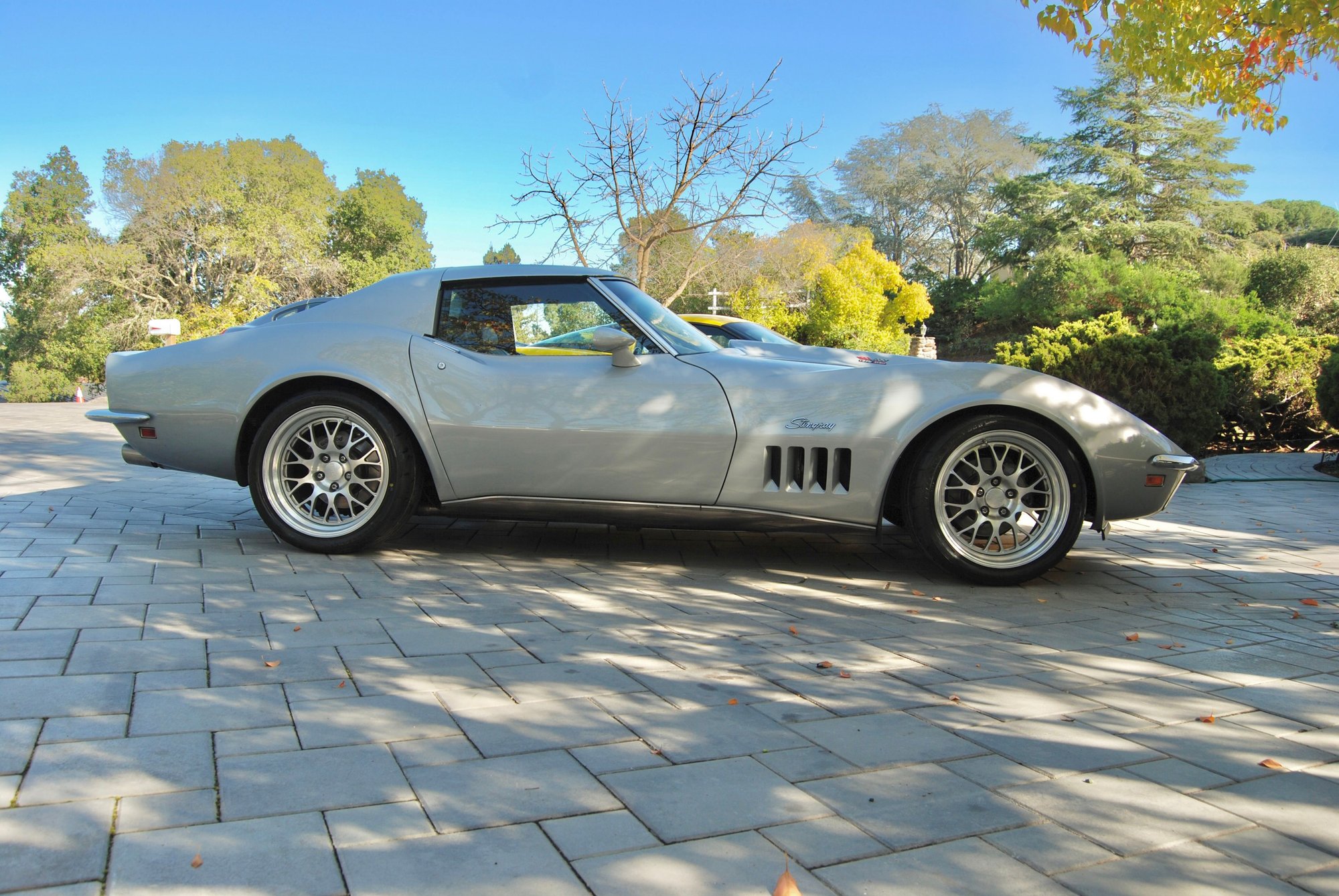

Here’s a pic with 2” dual rate lowering springs from Ridetech with 27” diameter tires. Some guys go lower by cutting the coils. I tried smaller diameter tires, but the the oil pan scraped going over relatively small speed bumps. The 27” also fill the wheel wells better, IMO. Ridetech has rubber spacers available to raise back up 1”, if necessary.

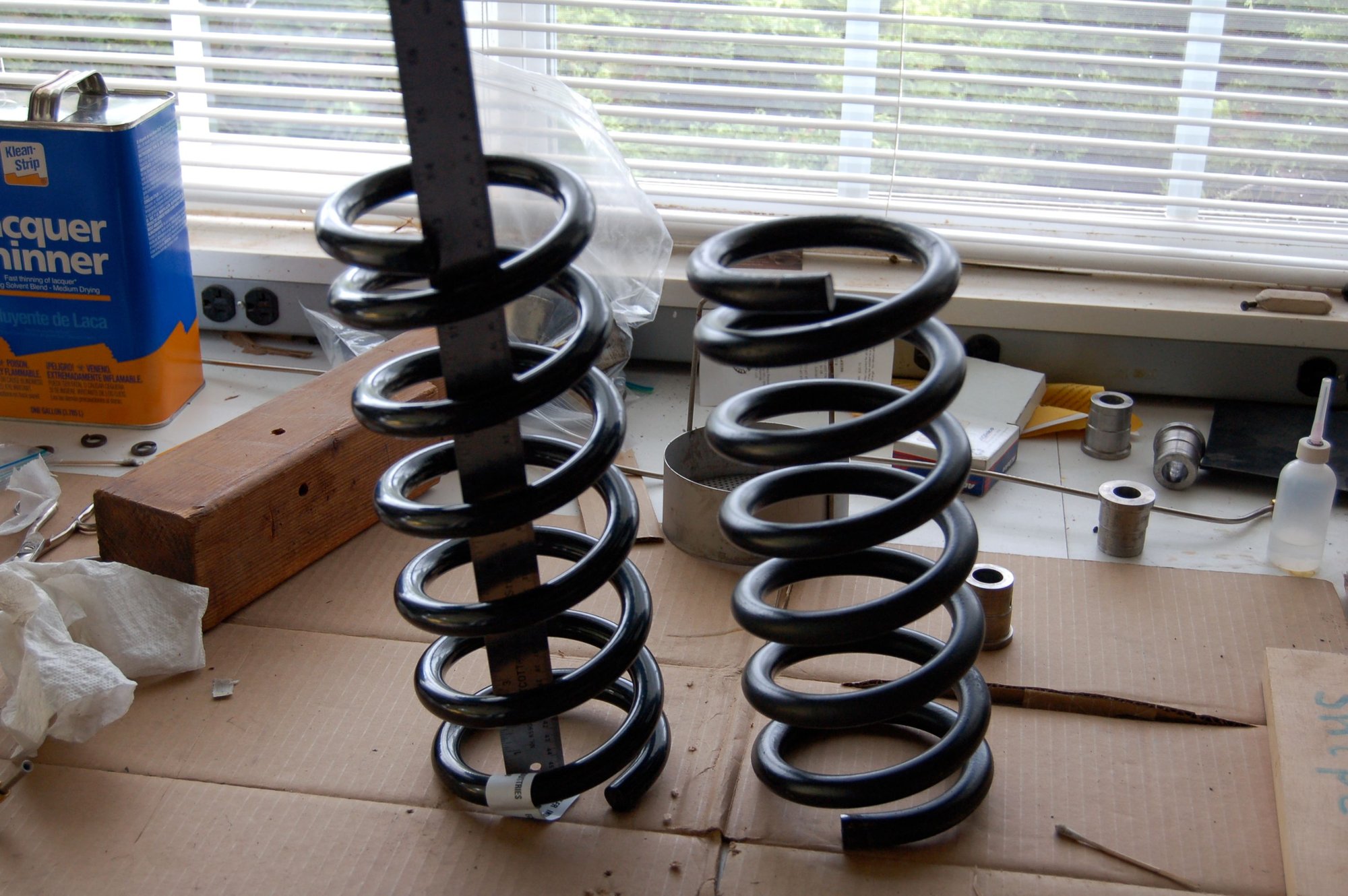

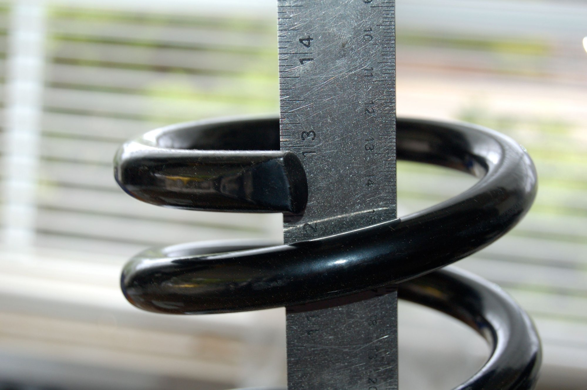

I cut one coil off of a new set of medium rate springs. You should be aware shortening them stiffens them. Got the ride height I wanted

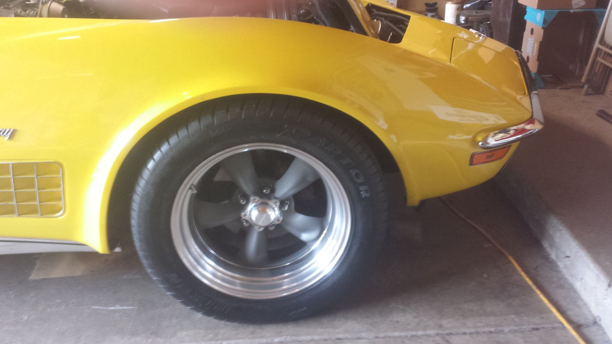

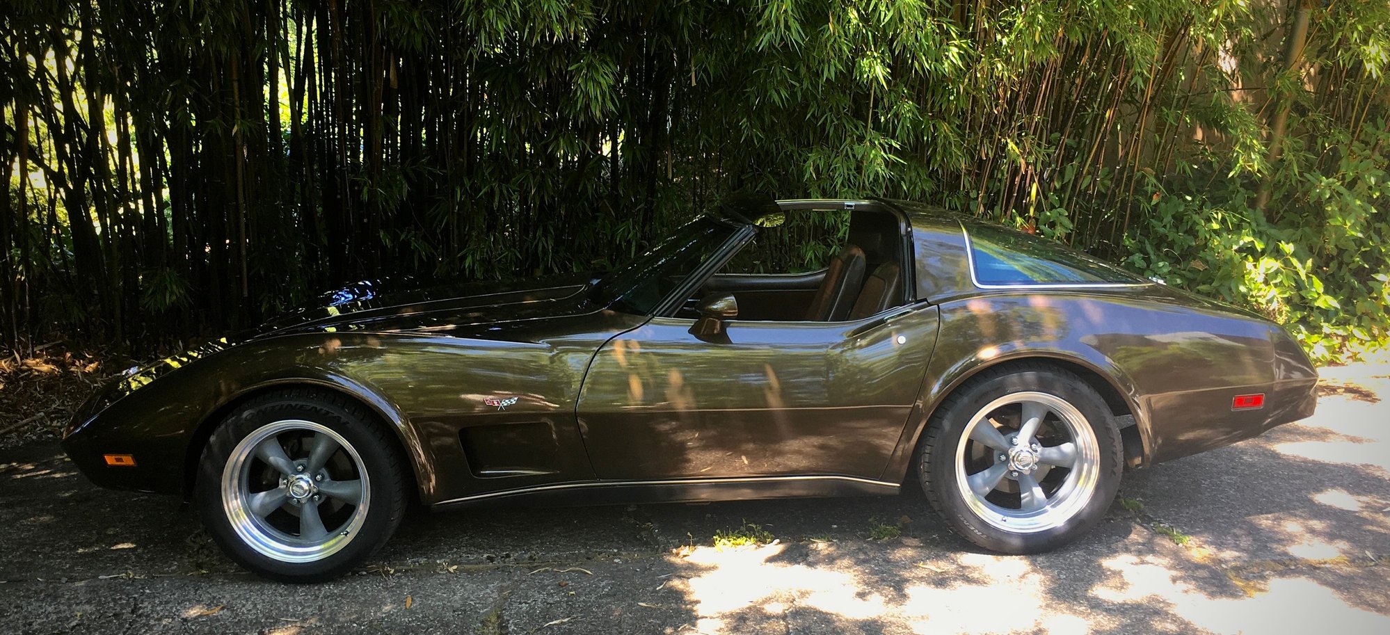

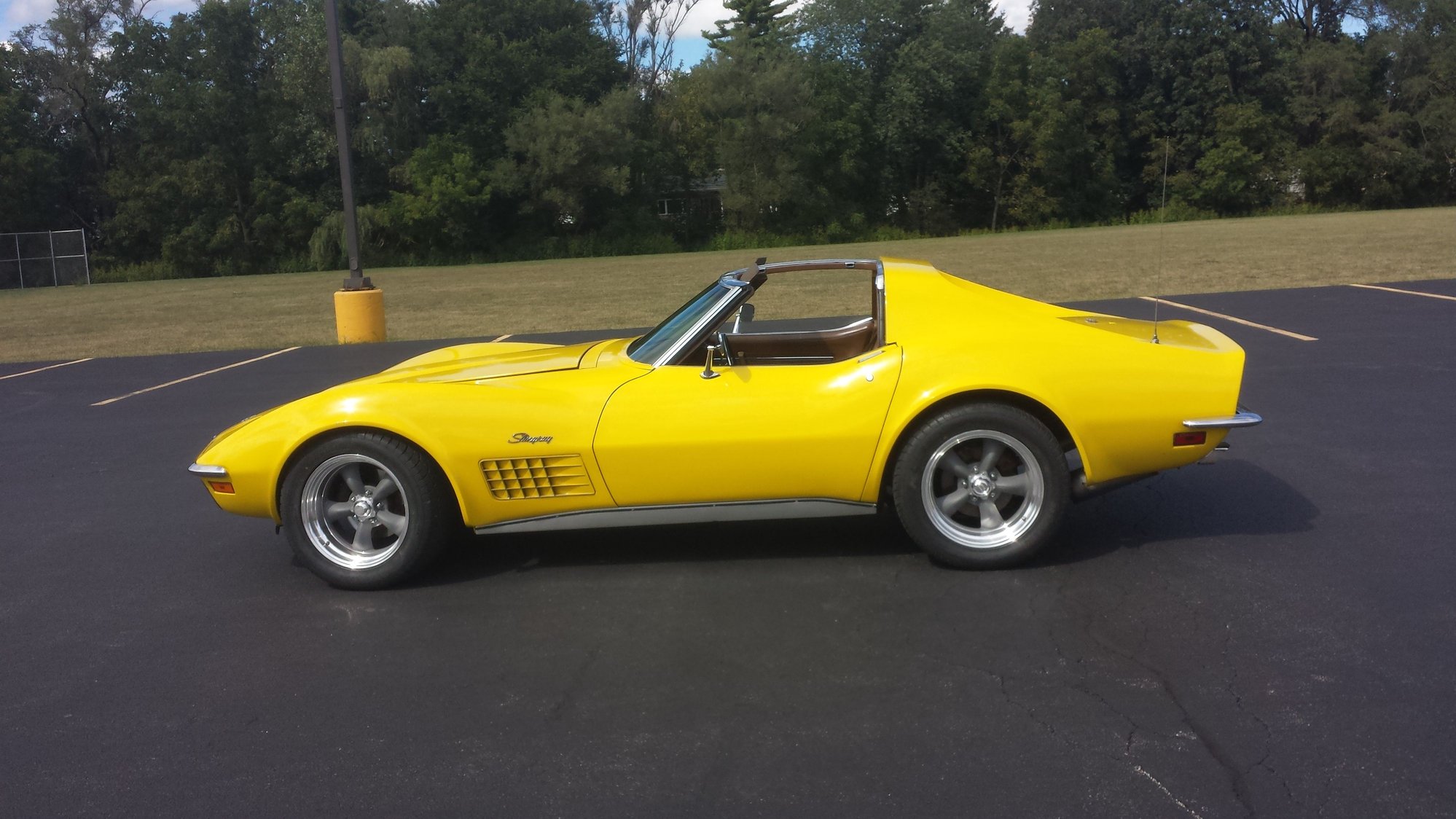

Moog 5762 (474 lb.) with a 1/2 coil cut.
