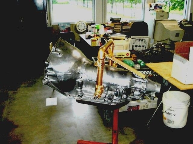

Look for water or rust in the pan from sitting a long time, maybe outside. Any corrosion or rust in the trans or valve body is not good.
Not all Th400 were built the same. The late 60's had better 2nd gear and sprags then the later ones.
When I rebuilt my original 72's Th400 I used an early drum and sprag, along with the hot rod tricks to the pump and valve body. I made an adapter from black pipe and angle iron to mount the trans in my eng stand.
