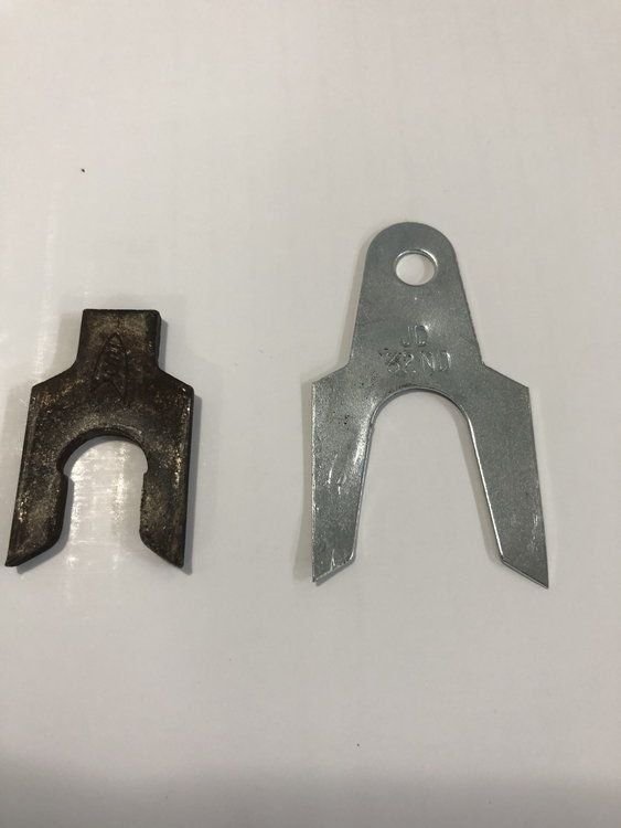

got pic? when i used my front shims i modified the new ones to look more like old ones as they fit much better and less chance to slip out. I think the new ones fit a couple of sizes universal.

It took 3+ years to notice? How many miles? There's quality/correct shims available - none in post#8 are to even be considered! Hard to believe someone would even consider posting them. Wire tied is a very good idea, prevailing torque nuts should've been new and requested or supplied by the OP when the alignment was done.
I don't believe it's valid to blame the shop as implied by poster #6.
