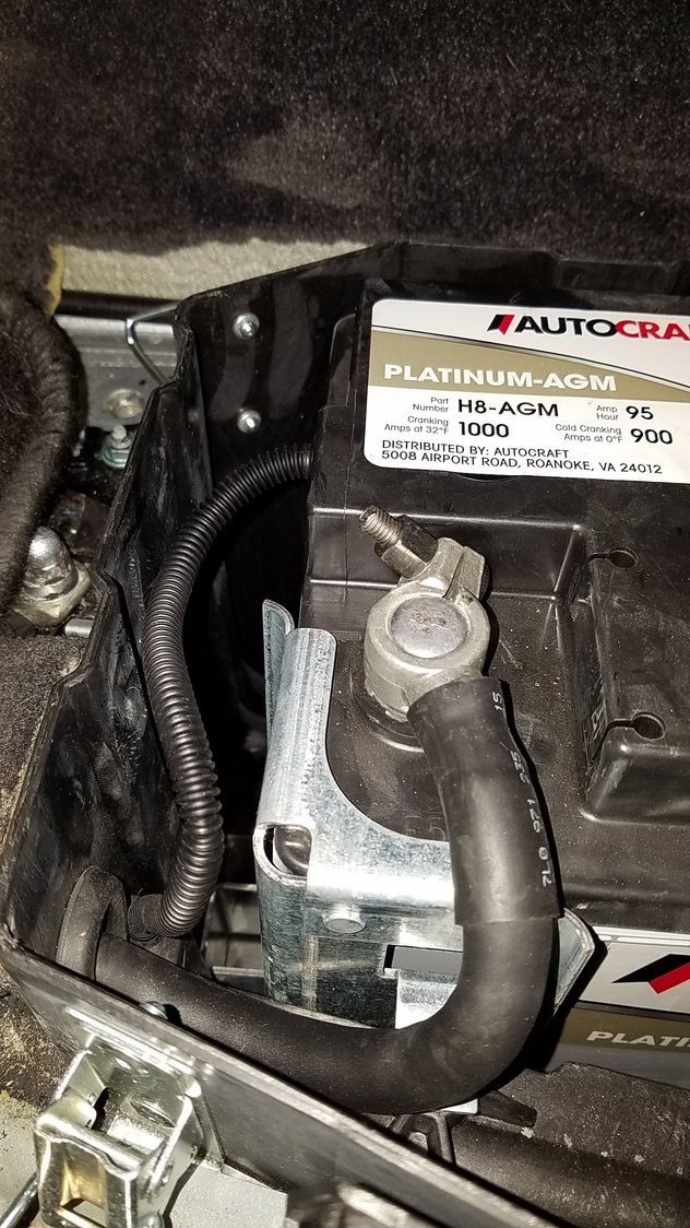

Im using an AGM battery and it is definitely vented. Battery has been in this car since 2014 and still working perfectly.
