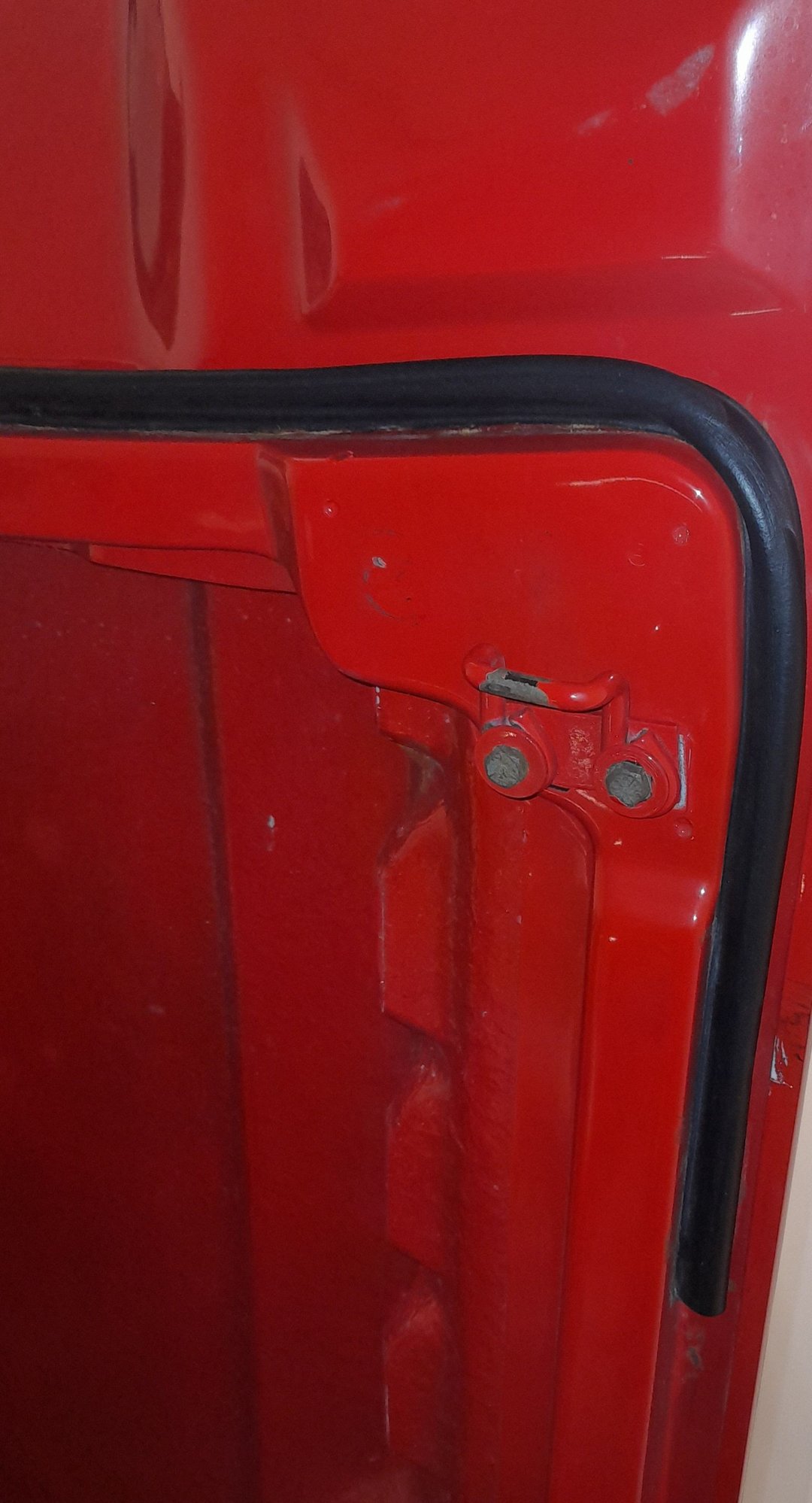

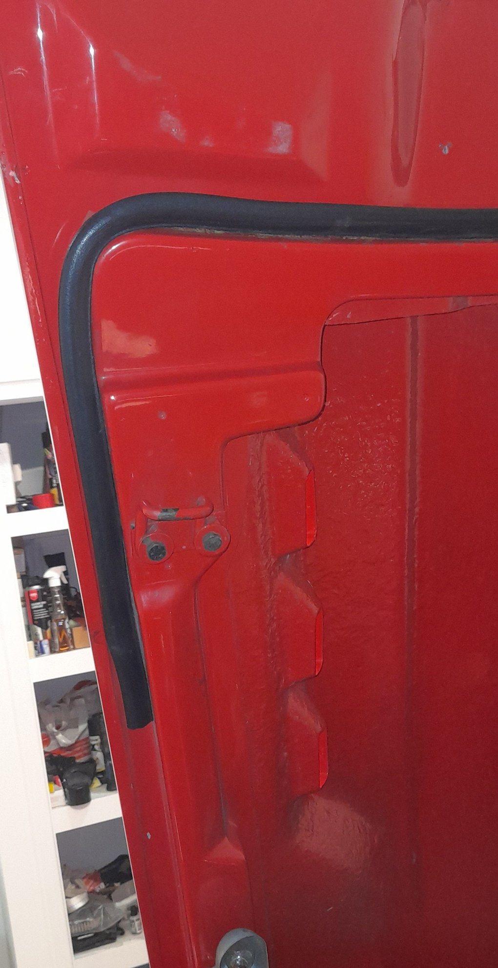

I have a 1978 corvette, nothing fancy, actually needs alot of work yet. I got it running after sitting for about a year and notice one side of the hood isnt latching. Turns out the previous owner apparently made his own hood strikers. They are actual strikers, but the bolt holes are 1 and 1/2" apart, whereas the bolt holes on the hood are 3" on driver, and 4 and 9/16" on the passenger side. Doing a Google search I find many different pictures, but nothing that appears to work for what I have. Can someone help me figure this out? Are the bolt hole dimensions I gave correct for a stock hood? And can someone direct me to what I need? Maybe some pictures of a stock set mounted? The brackets heade, although not pretty at all, are close, but the driver side needs to move to the outside a little further, as the strike is hitting on the edge amd not letting the catch on the firewall latch when it comes down. Thanks for any input.

It appears you may have a 76 or earlier hood. The 68-76 hoods used a spring loaded male pin on the hood, not the loop latches. Your strikers look like someone's homemade pieces made in an attempt to use the earlier hood.

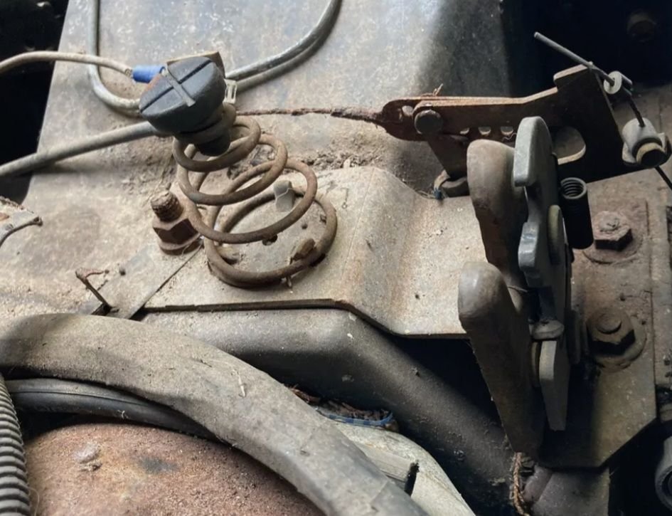

Any suggestions where I can get the correct ones? This is the type if latches on the firewall

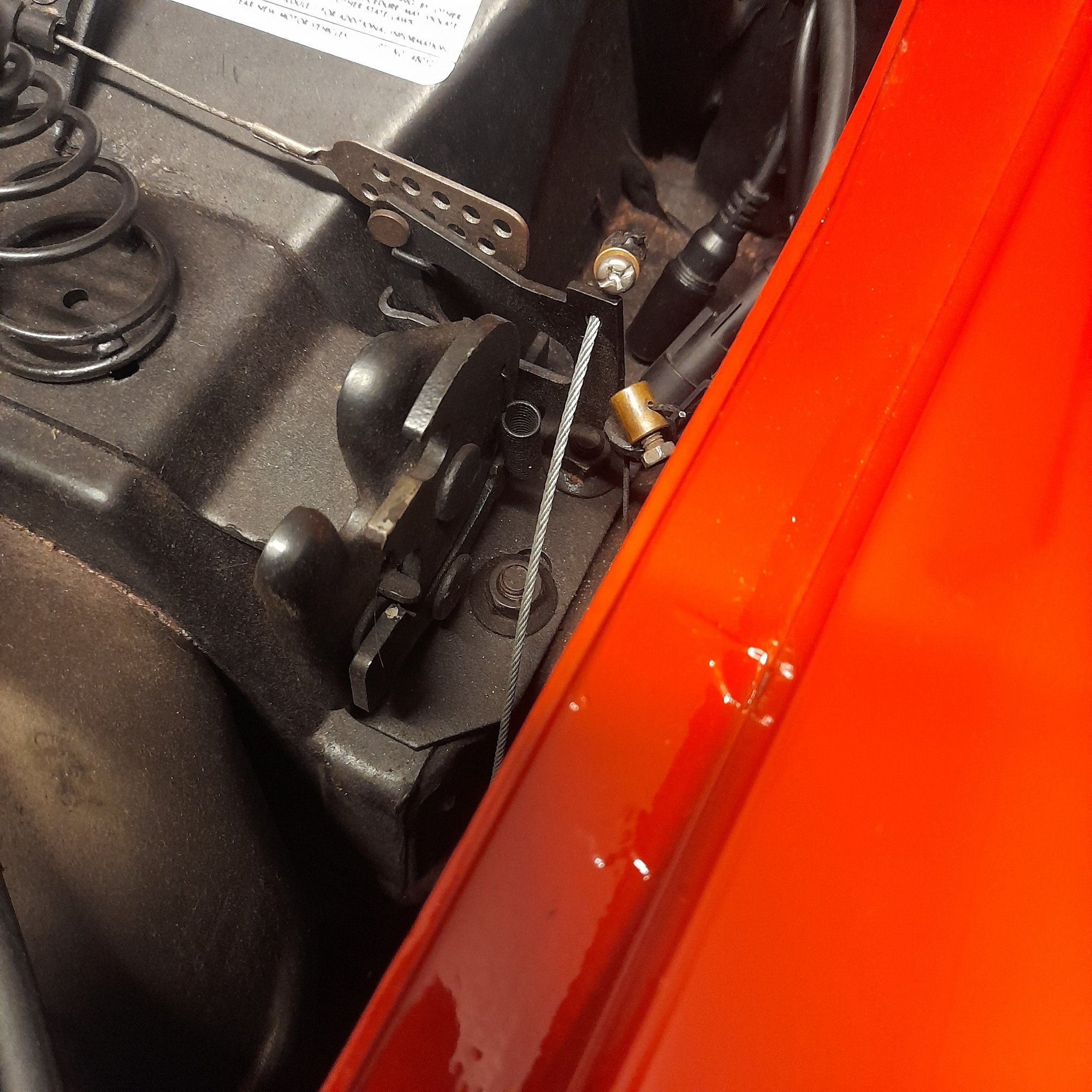

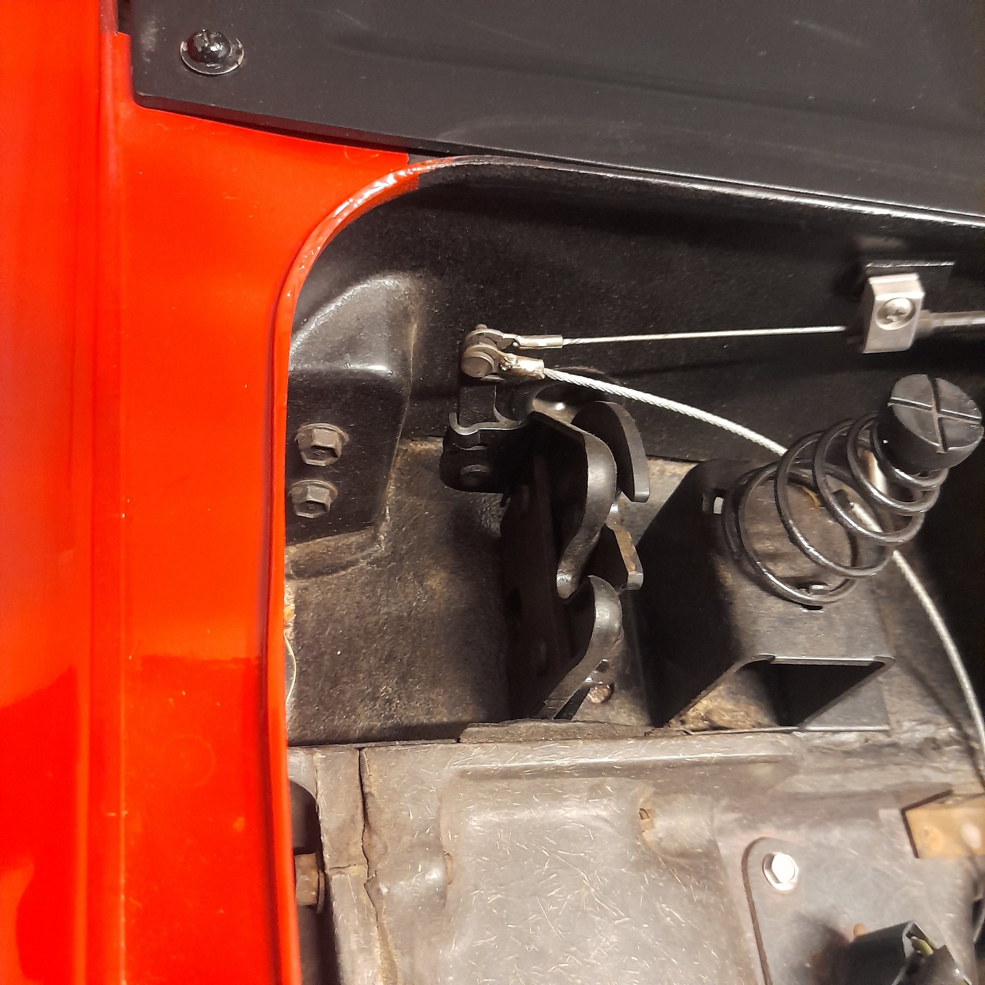

Here ya go. Correct 77 and up latches

Your drivers side latch looks correct. Which side isn't latching and why?

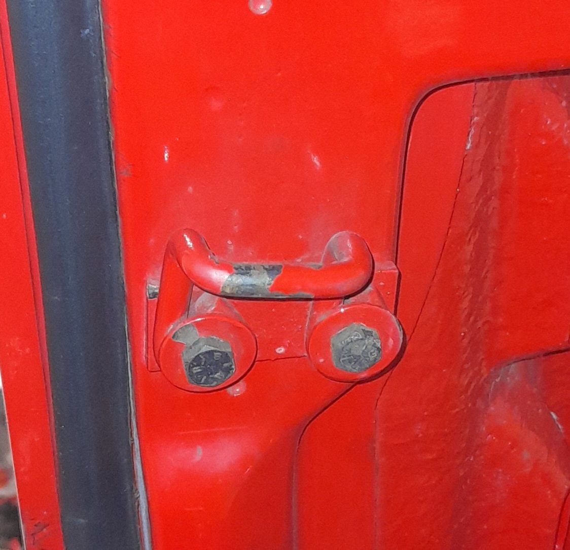

Note there are no holes in my hood? You obviously have a 76 and earlier hood.
best suggestion, get a new replacement or good used hood that actually fits your car.

The passenger side one latches BTW. Its the driver side that needed to be moved out another half inch at least for the latch to lock in.... bit I the contraption on drivers side is also to bulky in general, as I tried welding a simple plate to move it, and peeking under I can see the latch is lining up now, but it's not closing enough to actually trigger the lock.

Yes that's the problem. Those holes in your hood, those large ones. On a 76 a pin went into them. The latches on the early hood are in the hood. And pins on the firewall. On the later style. The latches are mounted on the firewall and instead of pins we have the loop or hook.
Basically they are completely opposite. So, not likely anyone will have a pic for you with something jury rigged up.
.You may not wish to purchase a new or used hood. But that's the only way it's ever going to be right.
