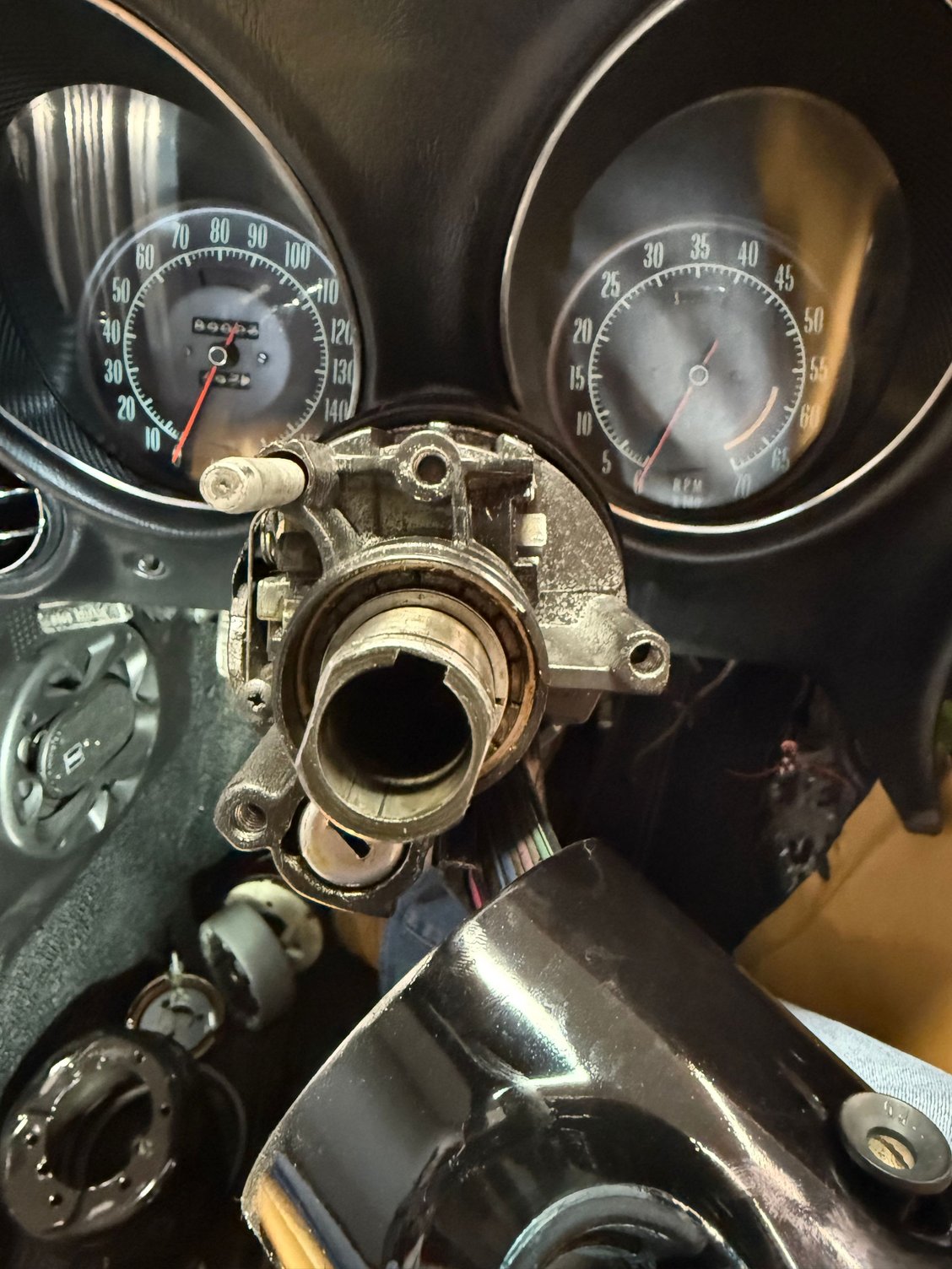

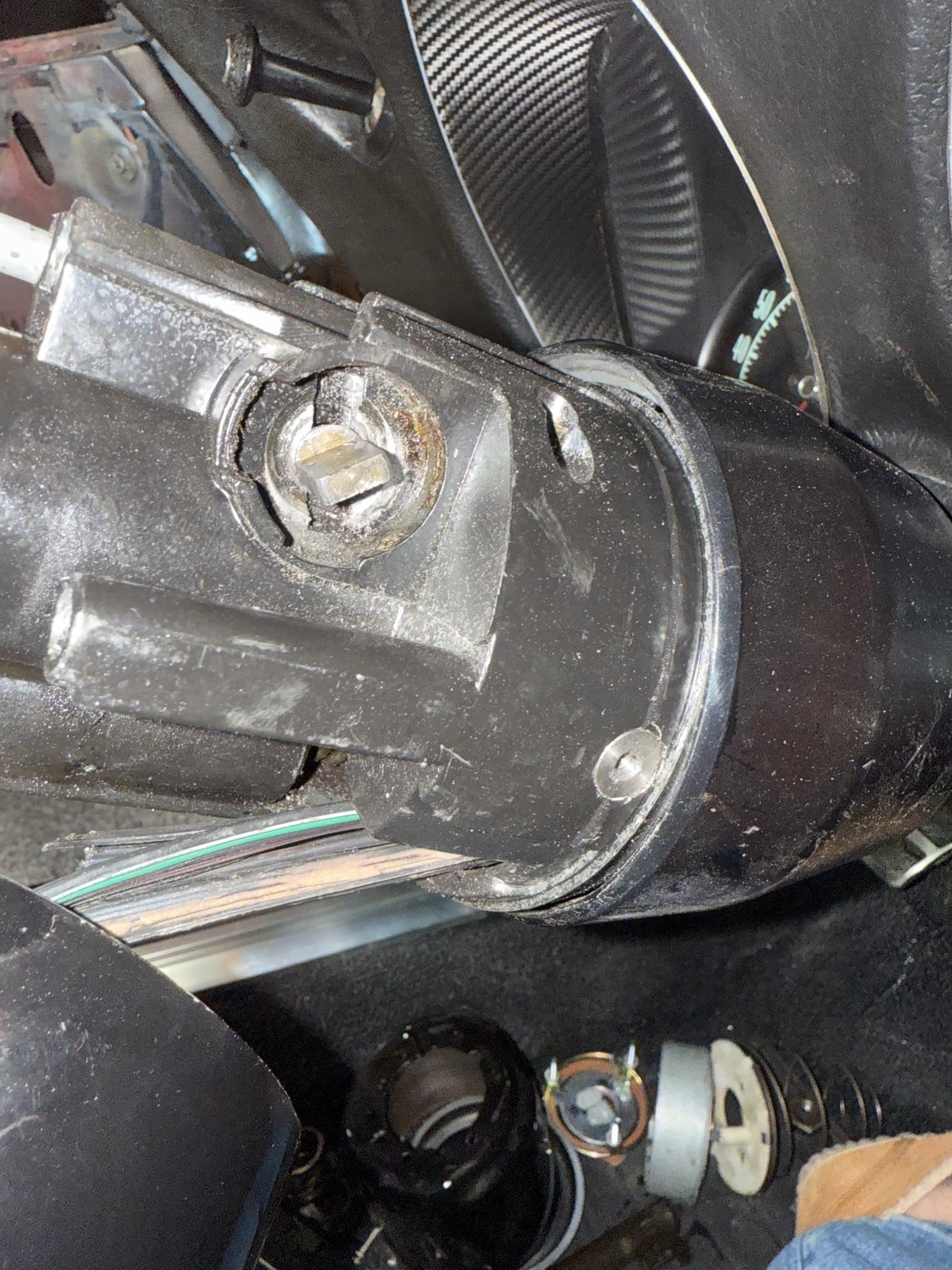

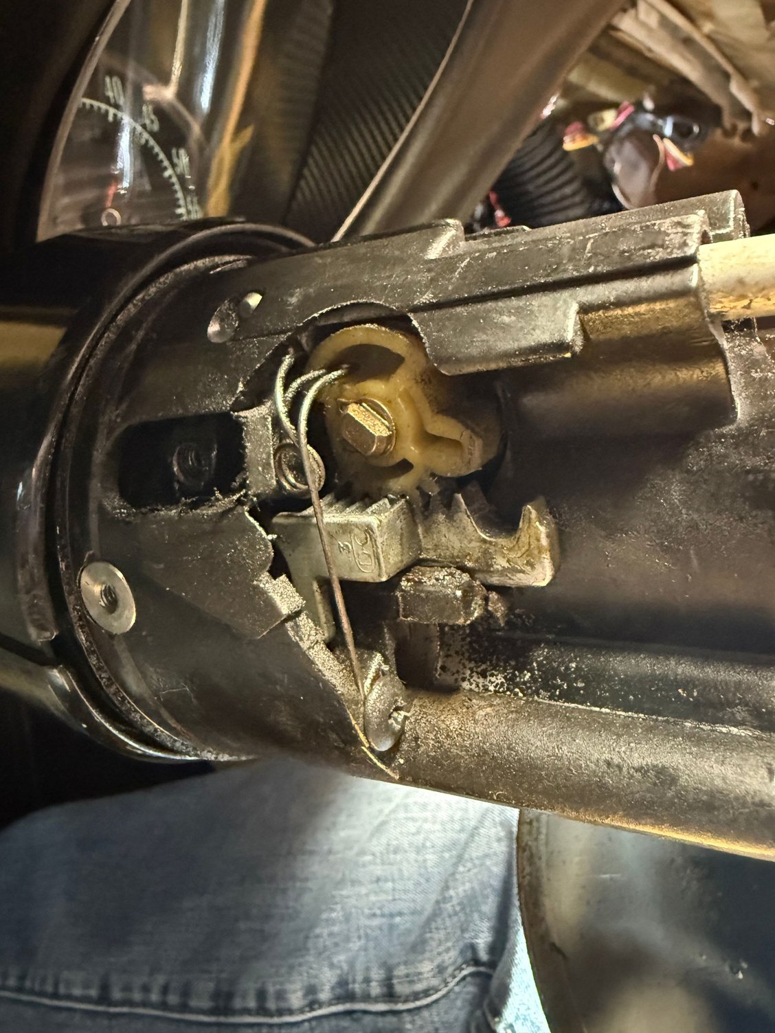

I bought a tilt/tele column and cleaned it up and painted it. Replaced the wiring and turn signal guts. Put it back together and replaced the key cylinder with a new one. I had it all back together and noticed the key would not come out and the key was operating in reverse. In other words the spring tension to activate the starter is towards the rear when you turn it instead to towards the front like it should. The key also will not come out. I took it back apart but can’t figure out what I did wrong. Any help out there?

Did you previously have a standard column? If so you need a tilt/tele ignition switch as the standard and tilt switches work in the opposite direction.

you could start with removing the ignition switch to half split the problem. Ensure the motion and rotation is correct with just the cylinder and rod
