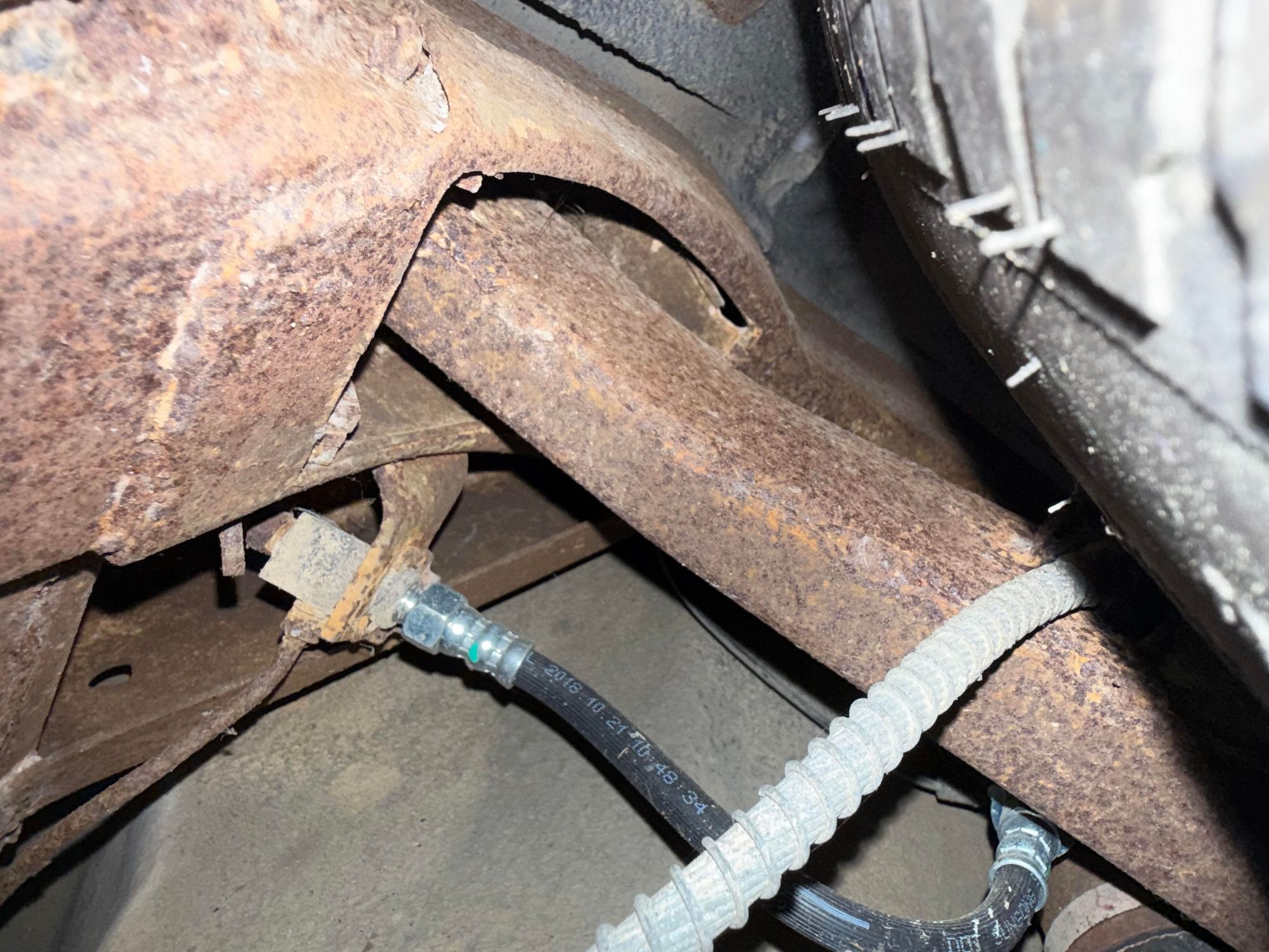

New to all of this. How bad does this look? this is behind the kick panel on a 1978.

Thats not great, but not the worst either. How does the rest of the car look? Especially the kickup area of the rear wheel well.

Birdcage looks OK, . A little rust converter and paint and it'll be fine. No pictures of frame however.
Rubber body mount looks like it's in need of replacement. Big job.

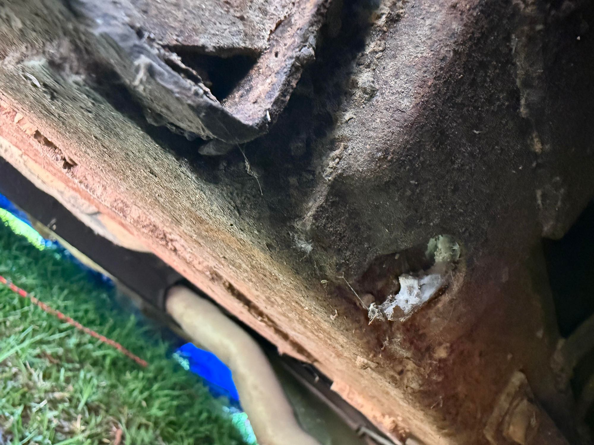

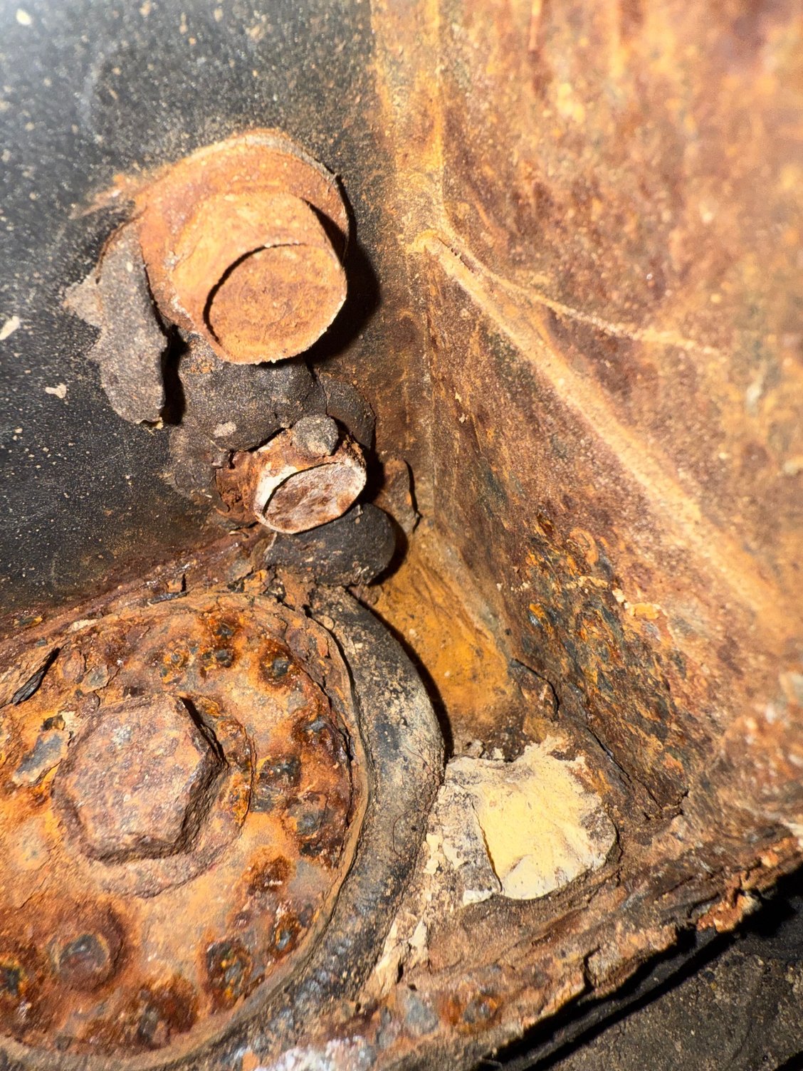

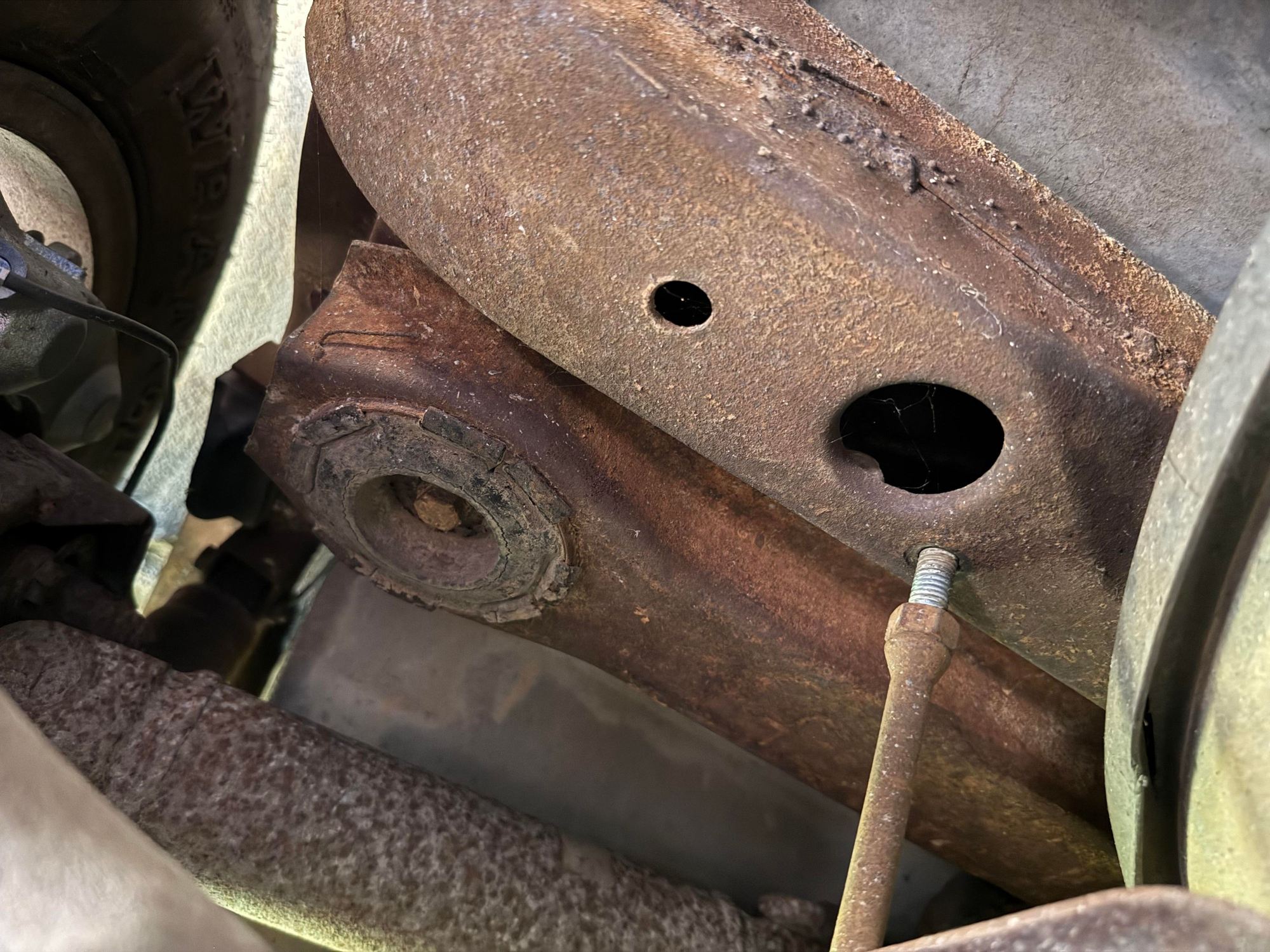

Here are a few pics of the frame back by the back wheel. Everything looks mostly this way. I poked on it with a screwdriver it seems solid. What do you guys think?

Looks like mostly surface rust to me, should be alright.

Agreed, doesn't look bad at all for a 50 year old car.
