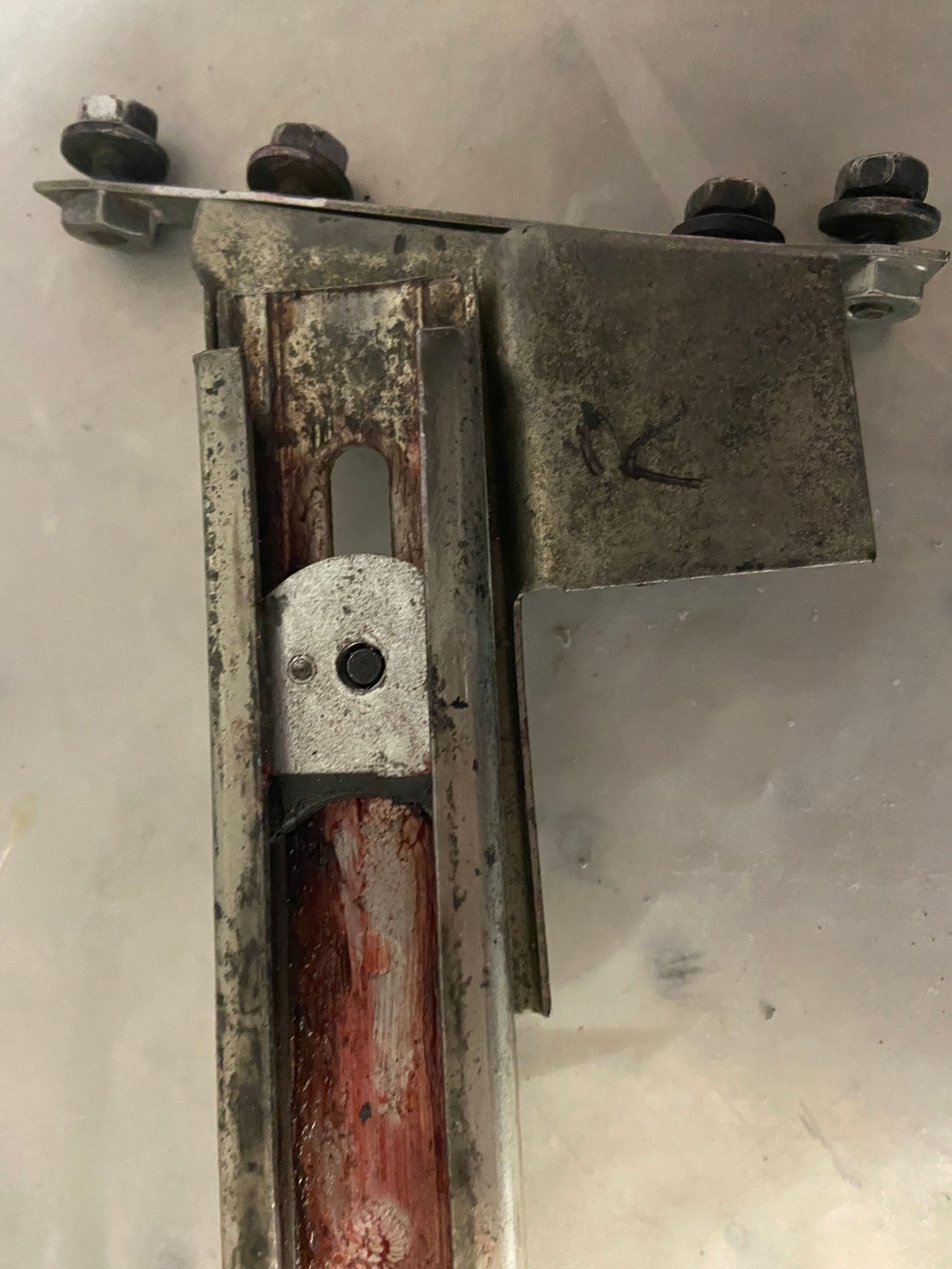

Here you go.from my 78
Adjustable top stopper in front track

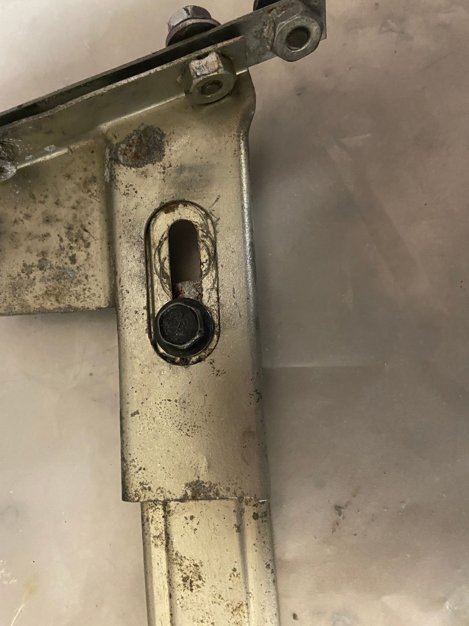

this is the back side, the bolt/screw you need to locate

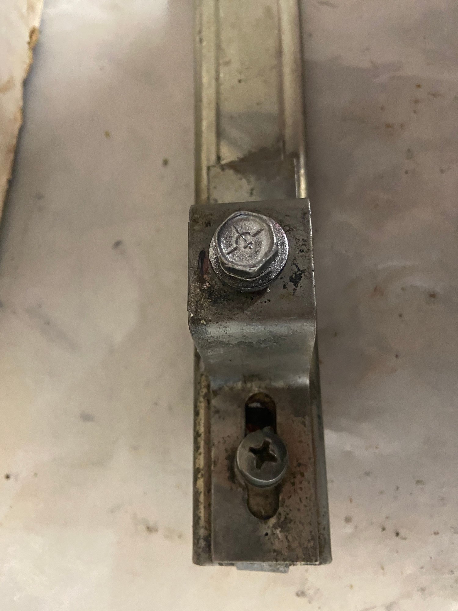

same stopper on the bottom of all the tracks.

Turns out the upper stops were maxed out already. I had to replace the front driver track as the top plate split and the PO used a nut on the backend which just spun as I tried to loosen. I knew about that but not the maxed out adjustments. I had picked up a nice used replacement from carsile a few years ago. Replacing that front track without removing the window was not fun…. Terrible in fact. I put it all back together and with the door open it goes up pretty good, with door closed it does as well but a tiny gap. Pass side does the same but when the door is closed it stops about 3/8” before the top seal. Not sure I’m gona pull that door apart to try and adjust.
