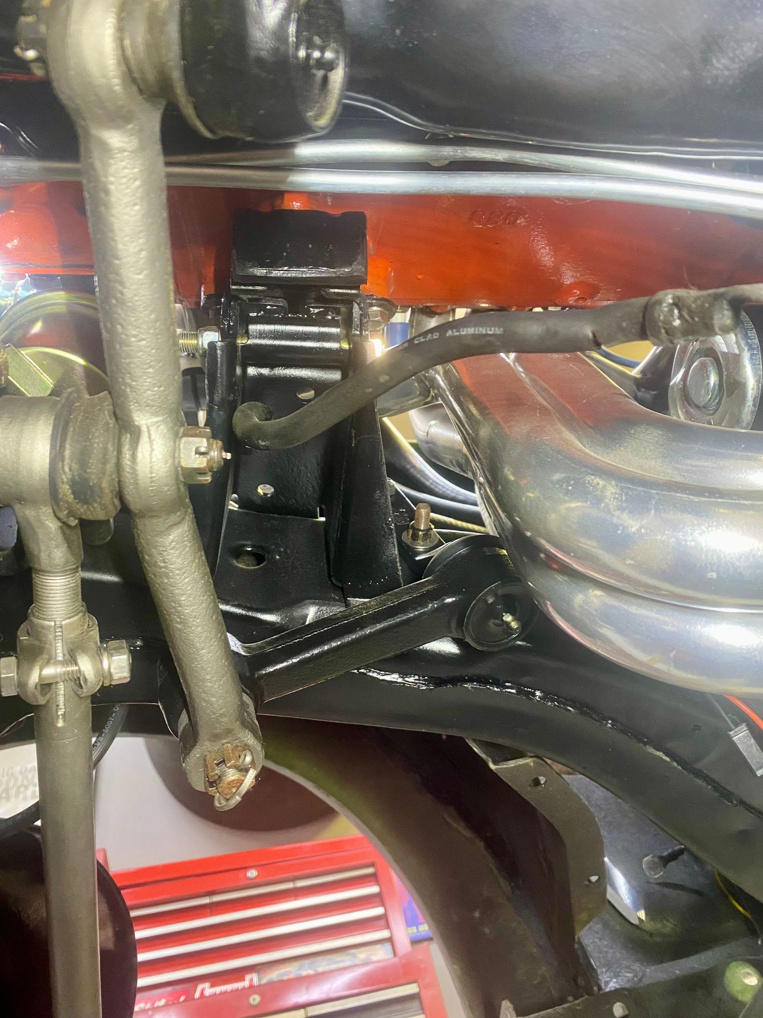

Car came in pieces when I got it so I’m not sure where the other end of this cable attaches to on my 73. It’s right up there under the motor mount.

Added an arrow

To the side of the block. It's a ground. Mine is bolted to a boss coming off the engine side.

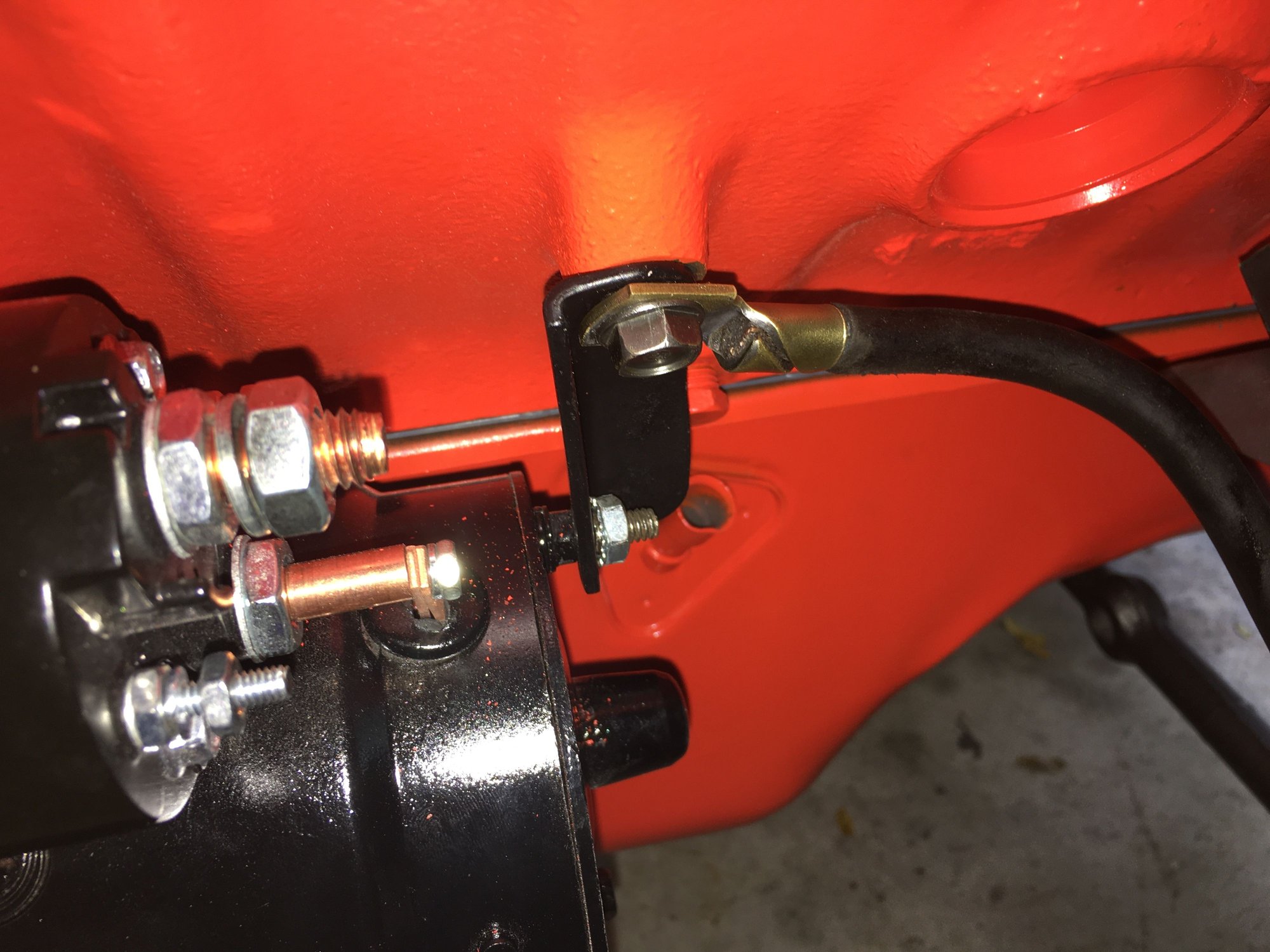

This is from my 1969 big block.
Thanks guys. Wow look at that clean engine

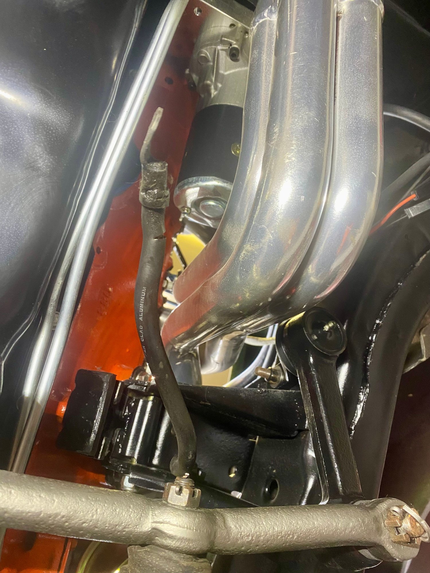

With your headers you may want to relocate the end that attaches at the starter brace.
I found a bolt by the fuel pump that worked.
