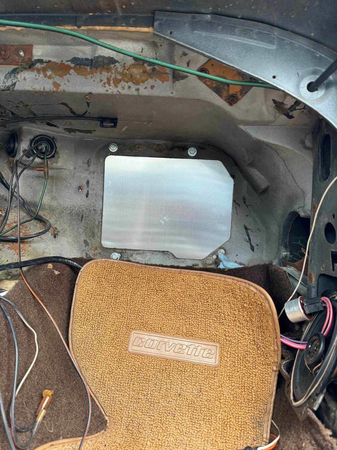

Crappy pic... I found this aluminum block off plate cheap online, so in the process off deleting my heater system.

Looks familiar. The bolt holes didn’t line up too well though.

Originally Posted by Piersonpie
Looks familiar. The bolt holes didn’t line up to well though.
You are spot on! Did we discuss it? So… I plan to cut the bolts, adhesive & butyl the plate, then seal the ill placed bolt holes at tne time that I smooth it’s perimeter. Would have been a great value for most if they got those bolt holes correct. But, I’m glad as it made me realize I don’t want no stinkin bolts & nuts sticking out. On the ‘69, I just glassed the entire thing in. Was my first ever workin tha glass! (Yes, that’s a reference to Faith No More)

I don’t believe so. Good idea about glassing it in though. It’s a bit of a placeholder before the eventual Vintage Air plate.

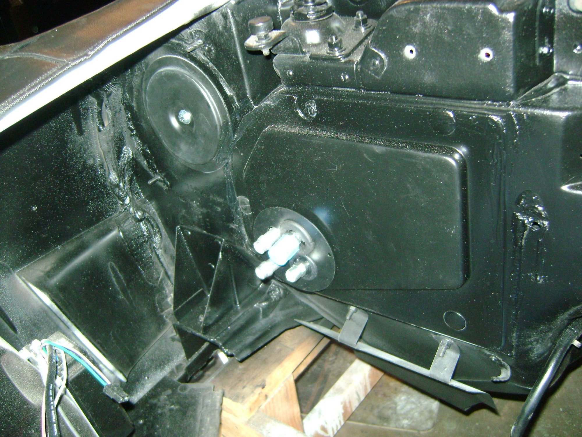

Leaving the option open is a good idea… more so on my end in hot as can be Florida, vs your typically cooler climate. You can kinda see in this pic of the ‘69 behind the injun. I spent tons of hours filling holes and smoothing stuff. Not sure I’m gonna go that far on this one.

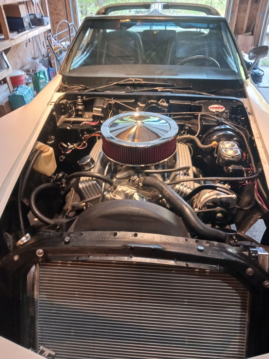

Originally Posted by ScottinMaine
Well, it's not as show-worthy as all your posts, but it's much better than it was. I had time to take a bunch of things off and clean/paint/lube and paint surfaces underneath, and added a new aluminum radiator, alternator and some engine parts. Middle left - I deleted the AC (almost useless in Maine), but I haven't decided what to do about the wiring harness, so for now it's just bundled with a tie-wrap out of the way. I might try a small metal cover painted black that'll blend in. Thanks again for all the suggestions.
That filter assembly looks tall from the pic angle, will the hod clear it when closed?
Yup, it's a 4" filter that gives the recommended 3" gap between the top of the carb air horn and the filter cover. A ball of tinfoil is about 3/4" thick with the hood closed. I deleted the insulation to clean up the hood and make room. I also used a carriage bolt instead of the wingnut for a little extra clearance.
perfect. Engine looks great!
