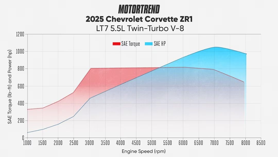

Originally Posted by Faster Rat
I know nothing about newer cars and I really don't care how much horsepower they make at 6 to 7 to 8000 rpm. So what? I come on this forum because I love the 60s big blocks. My 500+ torque at 3100 rpm gives me all the thrills that I need.
The LT7 has 800 lb/ft at 3,000 to 6,500 RPM

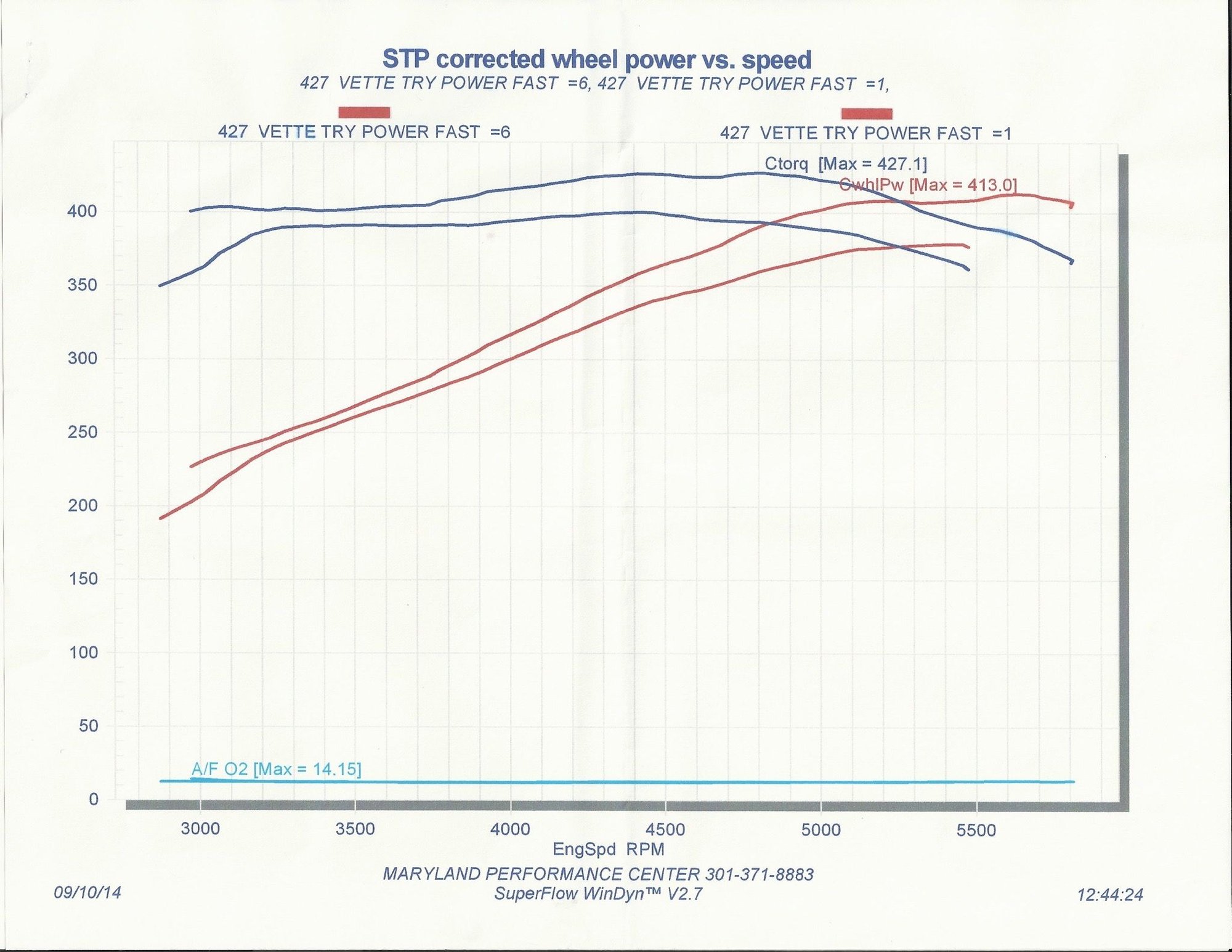

Here is the rear wheel dyno for my 496 big block with EFI. Torque at all speed.
