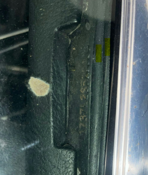

There's a LT-1 on eBay but I have some questions. At first I noticed the tach had a 5600 rpm redline which I thought was incorrect but for a '72 with A/C that is correct. Then I looked at some of the docs the seller posted. It shows a VIN 1Z37L2S522803. According to a Corvette reference book I have, '72 Corvettes should have a K not a L. Maybe it's a typo? The seller stated "K" indicates base engine Corvettes and "L" is for LT-1's. The engine stamp are 2S52803 & V061CKY. CKY is a LT-1 engine per my reference book. I asked for a picture of the VIN on the dash but he hasn't posted it yet.

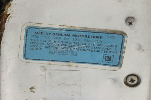

The pad is a restamp. It is an LT1 car with the vin that is listed. The car has a 5600 rpm tach, M20 transmission and a 3:55 rear end. A few signs it was built as an LT1 ac car from the factory. Here is the vin tag, trim tag and door cert label for the car. Car sold a rough barn find 2 years ago for $18k: https://www.hagerty.com/marketplace/...RVW3mi4pfqer1Q

With the retamped pad aside, I do believe this is a real LT1 AC car. But with no paperwork and a restamped block, the value takes a hit.
