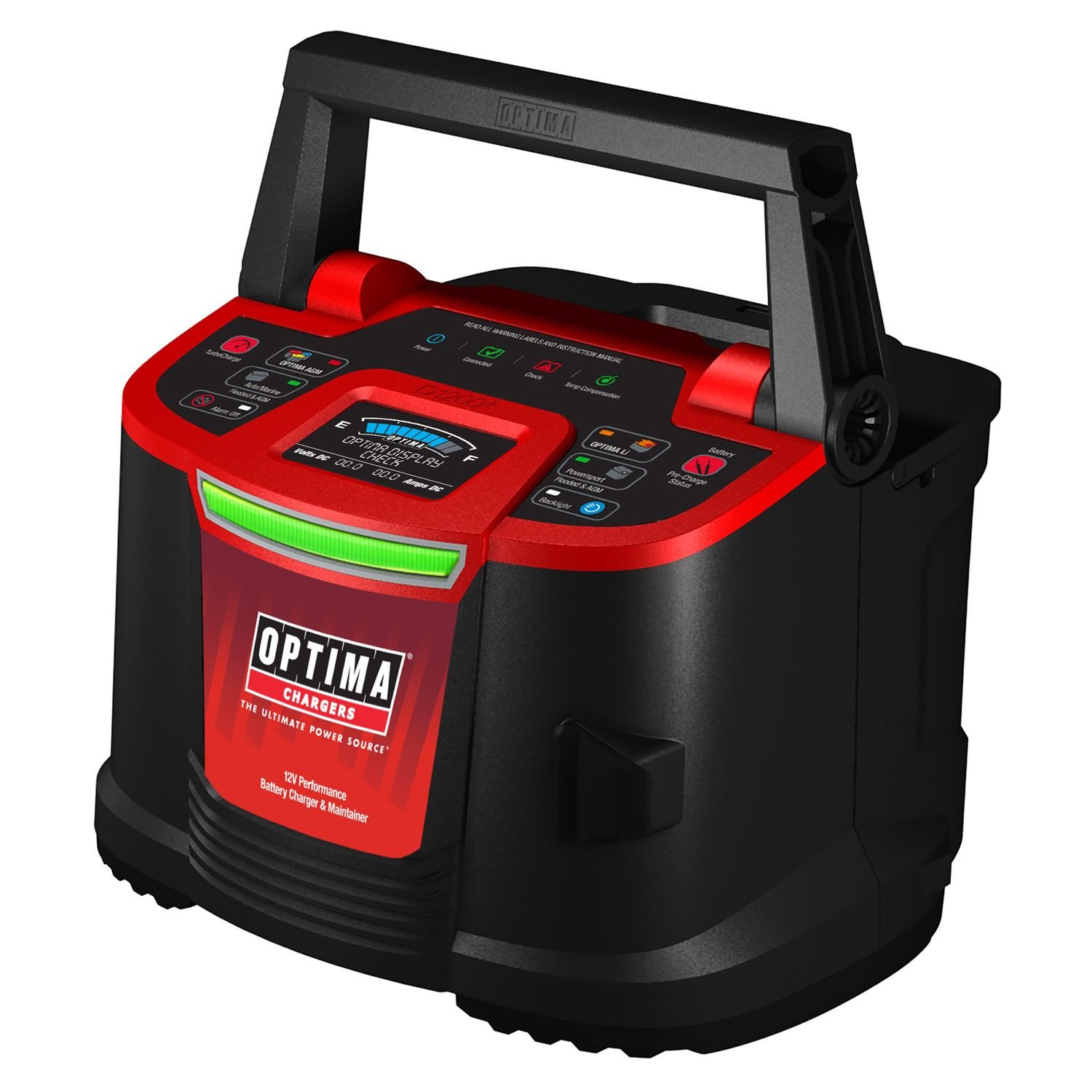

Thanks for sharing this info, I looked up this charger and I found something interesting. It appears that the previous version of this optima digital 1200+ charger was better (digital 1200) as it could charge very low voltage batteries like the analog chargers you mentioned:
This newer 1200+ version makes no mention of charging batteries that have a very low voltage. I do run into this issue from time to time with my vehicles that aren't driven all that often, and my current charger will give an error message that the battery is bad.
I guess I'll look for an old school charger like you mentioned
***Edit***
Just found the specs for the 1200+ lowest it can charge = 2.5V
Since the previous version can do 1.25V, that's likely the route I'll go

I've had the older version Optima Charger (same as your pic above) since about a yr after they came out (employee discount) ...so for about 12yrs or so. Overall it's good. It looks high-tech. The design for cable self-storage is brilliant. They paid attention to making a good unit. Below are my dislikes and likes. Bear in mind, some of the quirks on my 'early' unit may have been resolved or improved upon in the yrs after.
1) It won't charge a really dead battery. Maybe they improved that on later production units. I fairly often need to get out my old-school Schumacher to bring the voltage up, then switch over to the Optima charger. That's really annoying. One of my biggest gripes. I put it on, it goes through the analysis routine...then after a while attempting to charge it gives an error. On a battery I know is good, but just went dead overnight. If they needed to put a small old-school transformer in there ...to trickle some juice into a dead battery (then switch over to 'smart' mode), they should have done that. That's a MAJOR overlook by some millennial city-slicker enginers who apparently don't own a bunch of old cars. I've been to the HQ many times, so I know they had a lot of city-slicker non-car-guy engineers and foreigners ...fresh out of school ..over there!! My old-school 'non-smart' transformer-based Schumacher has .3A, 2A, 10A & 50A (start) modes, will bring up any dead battery that I ever put in front of it (unless it was toast from age or internal damage). Start on .3A for a few min, then switch to 2A.... and then to 10A. Or switch over to a so-called 'smart' charger like the Optima once the battery charge is brought 'up'.
I used to get dead batteries from work all the time from service vans ...fairly new Delco and Ford batteries out of fairly new vans ...but just dead from the GPS or cell phone charger. Our service mgr didn't want to screw around with a battery that was a yr or two old and the walmart auto center was literally walking distance from the office. Sometimes he'd ask me if I had time to go get a new battery and install it (he didn't want to mess with them), and I could keep the core. I had a ton of extra (like new) batteries at one time, lol. Gave some away. I'd also get new batteries which were frozen rock-solid too! Let them thaw out for a day, then charge them up. So I've charged up (revived) a lot of 'dead' batteries, and I'd have to start with the ole Schumacher just about 100% of the time. That goes for other 'smart' chargers I've got/had too. They touted that feature when these came out ...but again, maybe they improved that low-voltage feature on later production Optima charger models. Just saying. Otherwise put a small xformer in there and charge another $20 for it.
2) I've had it really HEAT UP a battery while charging. Only a couple times ever. Standard flooded batteries, never an Optima battery. Curiously, not all cells but one or two cells in a battery. I don't know why it did this. Maybe it was trying to knock off scale? Got so hot you almost couldn't touch the cell. This concerned me and I eventually pulled the plug. Once I unhooked and let the battery cool down, the Optima charger charged the battery normally (w/o heating) after that. Like I say, maybe it was trying to revive the cell? The charger is not high enough amps to really overload a battery. It was definitely trying to 'do something'. But still, I generally spot-check a battery that is being charged, a couple times, just in case. Again it could be just my charger...and most likely that was fixed with later production. Or maybe it's doing something it's supposed to, to attempt to revive a bad cell/s. It wasn't the whole battery which was hot, just like one cell or two cells. I don't understand, and at some point I pulled the plug out of safety. And maybe that's why the battery lasted so long afterwards?? IDK. I haven't had it reoccur in many yrs. So it was a couple one-off situations. But still....
3) It's fast ...but it's not. By that I mean, it brings up a battery pretty "fairly" quick. By design it monitors a battery and fluctuates the charge and amp levels. Then it does a finishing charge which tapers down the amps. Thats the scientific approach by the charger. The finish charge takes forever. So the overall process takes a long time. Not a super-big deal and you can pull off the charger anytime. But my ole Schumacher at a steady 10A is faster. But the major downfall of the schumacher is there's no feedback, so you don't really know where you are on the charge spectrum like you do with some smart chargers.
4) A 6V mode would be really nice. I can think of a few times I could have used that. If you're going to produce an all-round premium battery charger, a 6V mode is really a MUST. But then again, Optima doesn't have any 6V batteries that I'm aware of, and the whole point of the charger was to produce a charger optimized for Optima batteries.
What I Do like about the Optima charger:
1) The design is great
2) The quality feels great
3) The gauge is nice
4) It lets you know what's going on in terms of volt and amp output
5) There's a light for low light or nighttime use.
6) There's a USB output (which I don't often use). But nice to know.
7) Will charge multiple batteries
8) Maintainer feature.

That said if you can find a good used older Optima charger definitely a good unit. I think my issues were early version issues. I agree, the brad new design they sort of cheapened the interface.
