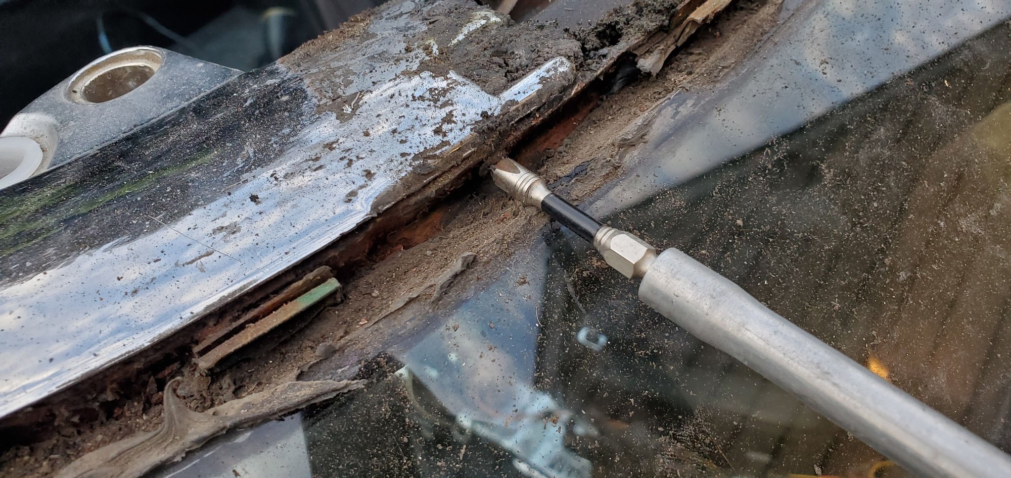

There are a ton of threads about this and the answer always seems to be: remove the windshield. I removed mine tonight. The secret (as usual) is the right tool: an impact bit.
The narrow shank is there to reduce the shock load when used with an impact gun, but in this case, it lets you get just enough angle on the front screws to break them loose.
Here's the inner screw - this is the easier one to get to.

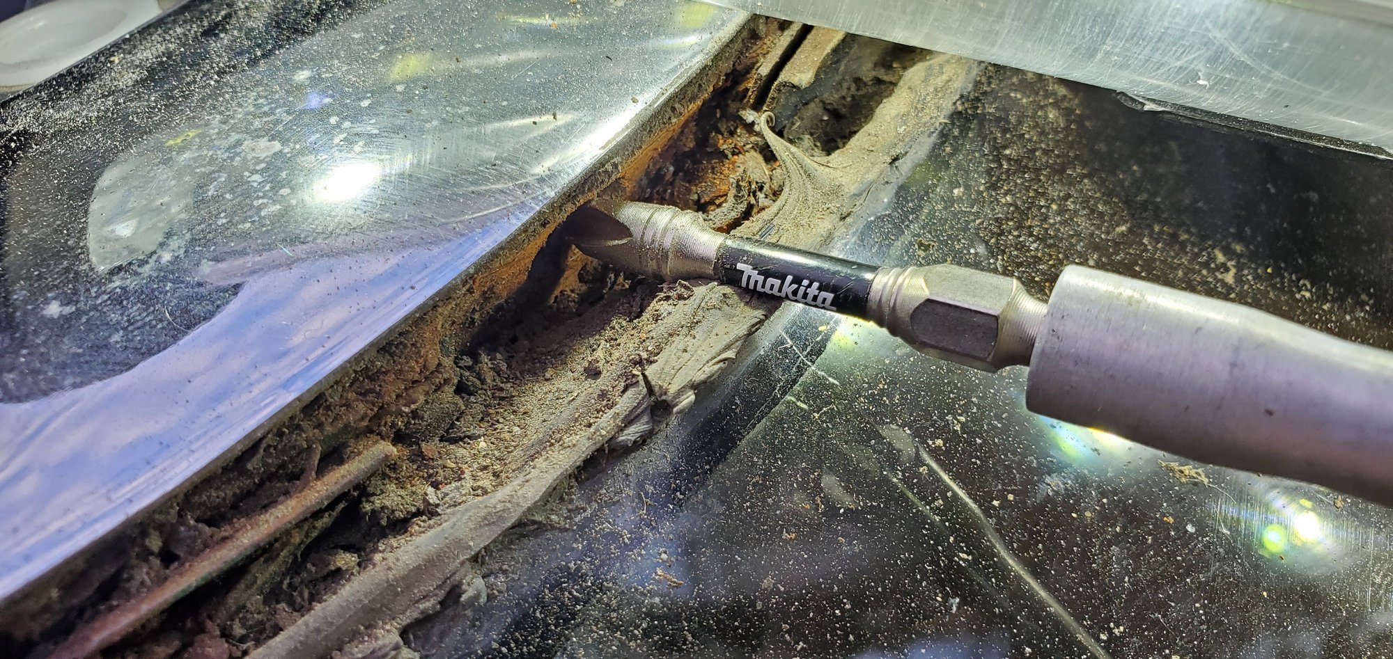

This is engaged on the outer screw.

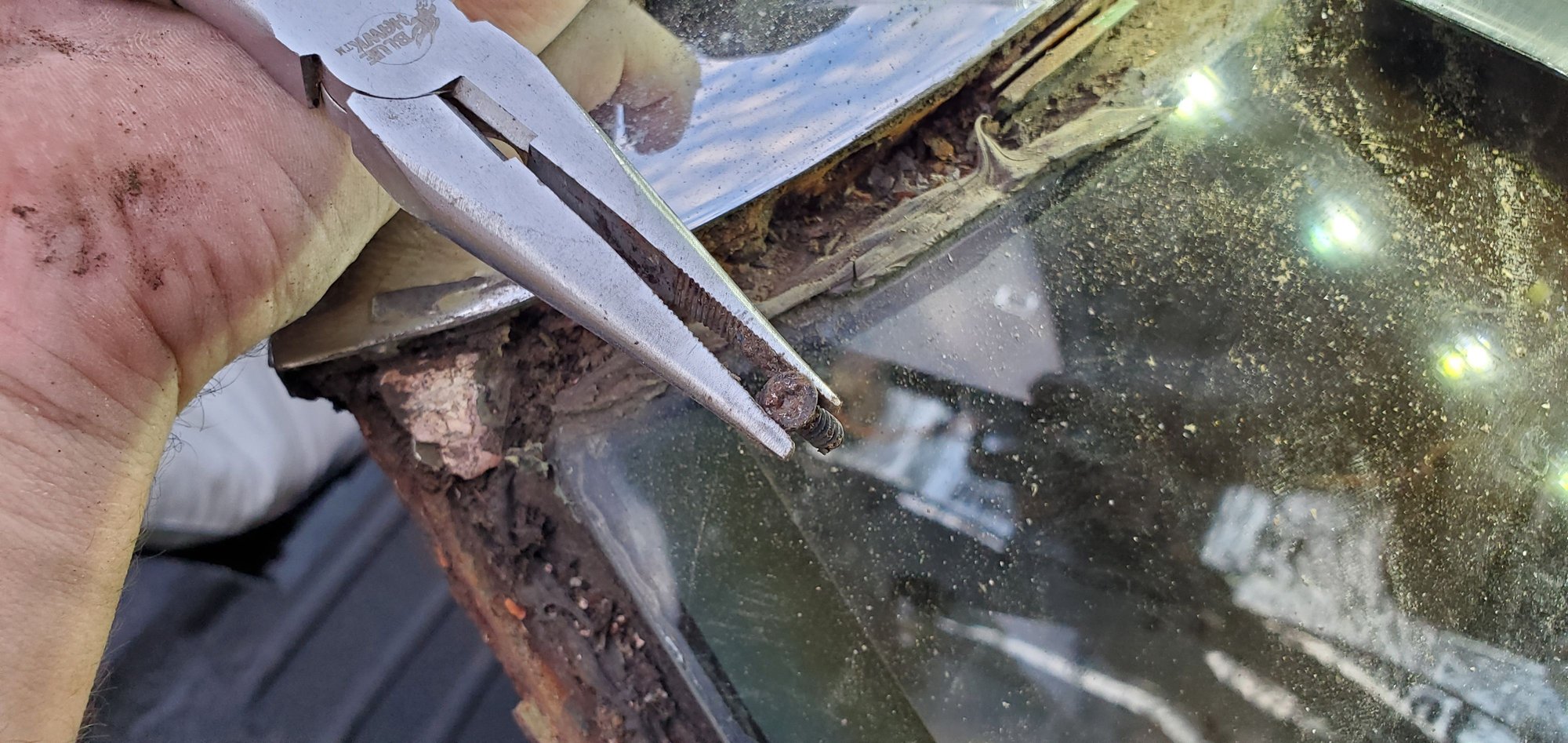

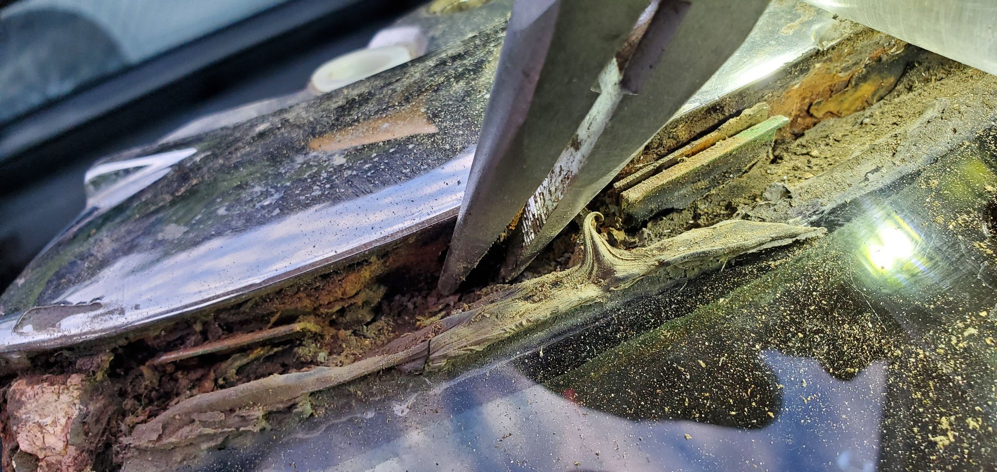

You can only back them out a turn or two, but its enough that you can finish removing them with a pair of needle nose.
You can see mine were pretty rusty, but they weren't really seized in there. They broke loose without a ton of torque. This likely won't work if yours are really rusted in place.

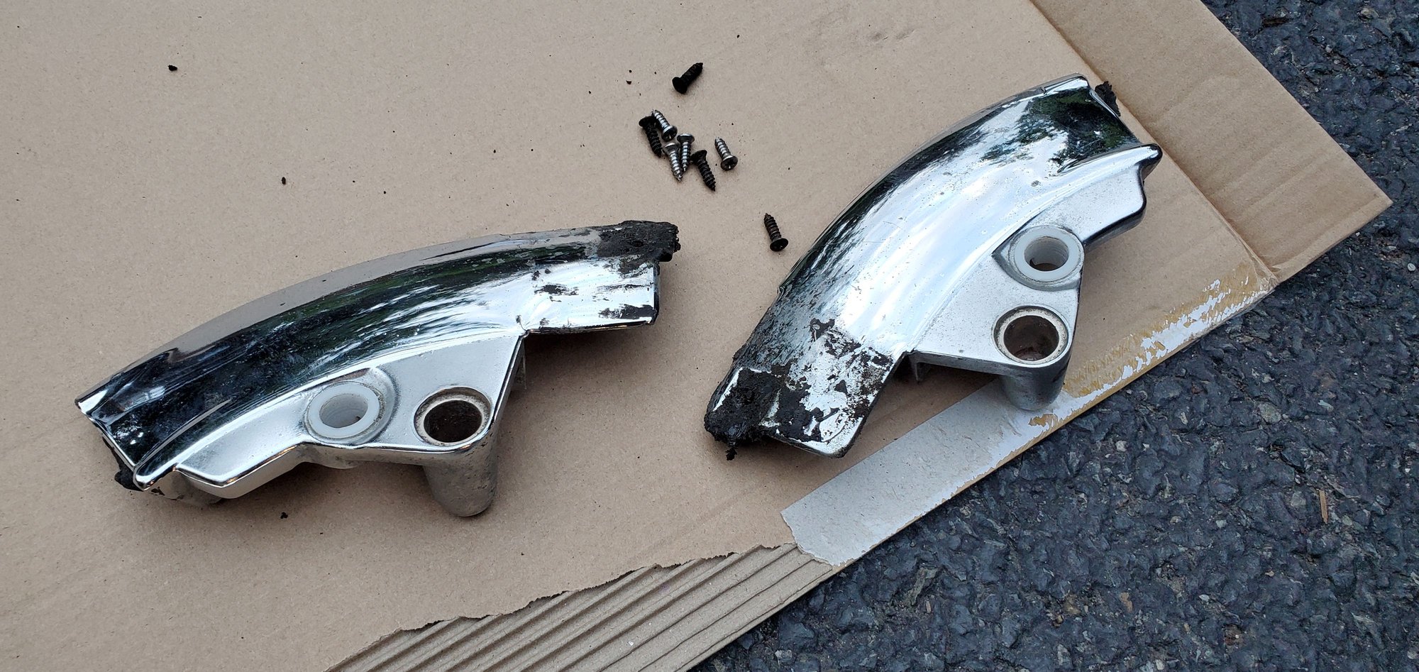

Corner mouldings off the car.
