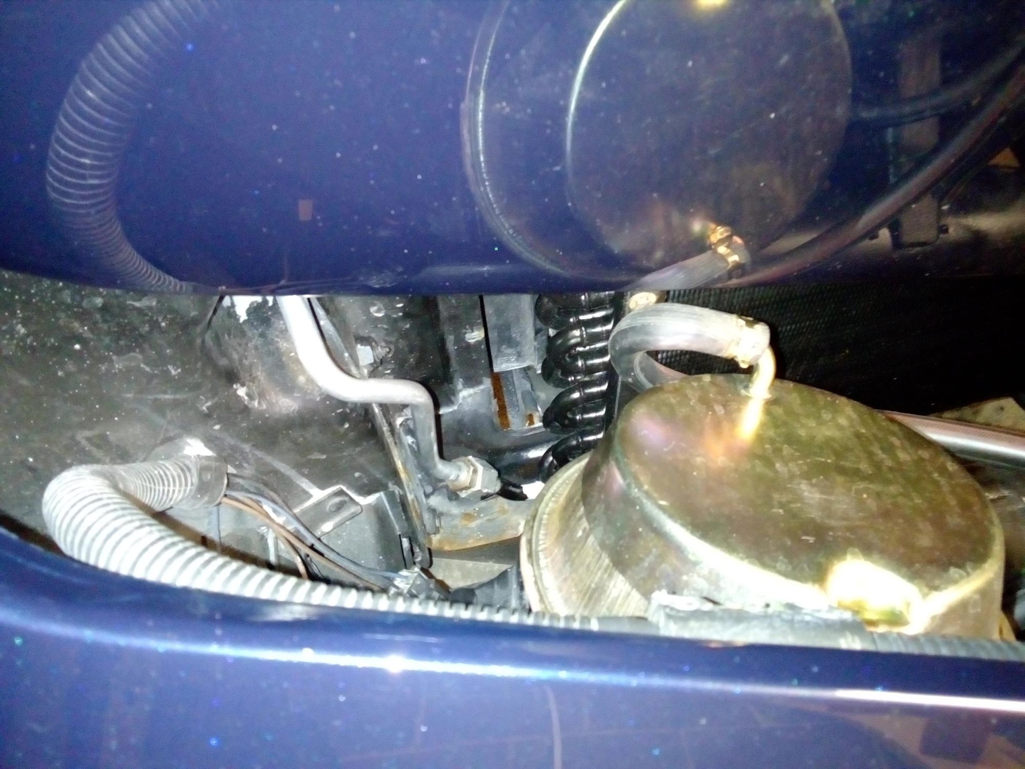

No matter how i orientate that hard  line it doesn't see  to align to the condenser.  This is a 77 built  in october 76. Thanks Ty.

Here are a couple of shots of the hard line in my 78. Looks like you will need to pass it between the radiator support and the inner wing. If I remember correctly it's not easy to thread it through there, I might have had to loosen or disconnect the radiator support (it was a few years ago and my memory isn't what it used to be)

My 78 also passes thru the core support.To the OP, in your picture there is a gap to the left of the support just above where your line is. You need to put that line thru that gap FIRST. Once it is there, you can turn it whatever way you need to start threading it to the condenser. Once that is all done you will see how it lays up agains the innner fender and then you can connect the other end. It is not very obvious how that is supposed to go.

I have a early 77 as well that once had the VIR system. That line comes through the gap as the arrow shows above.
