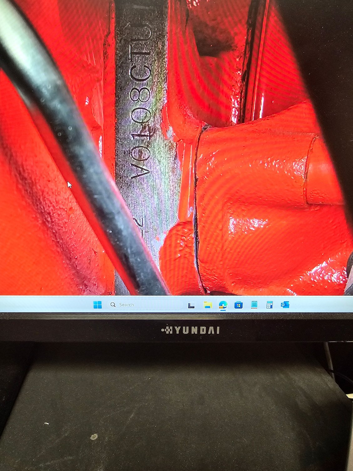

Can you post a clear picture of the stamp pad that had no paint on it. And if it does have paint only use a chemical to remove the paint.

Default Engine pad

That pad has been altered or touched. The milling cutting lines are going the wrong way for a flint block

Looking at the surface of the stamp pad I can't quite decide if the pad was cleaned with something abrasive like sand paper, or if it has been decked and restamped? The stamping itself looks typical of factory stampings, but the pad surface is an issue.

October 23 to January 6 is certainly longer than is typical for one of these engines, but it is not out of the realm of possibility. Taking everything into account (casting date, assembly date, VIN derivative) gives us a much better picture.
This is a comparative pad close to the assembly date of the OPs engine.
First 0, 1, and C are all different… That doesn’t address the VIN derivative in the OPs photo (which we can’t see). Add that to the long spread between casting date and assembly date… Would be nice to see the VIN derivative.
