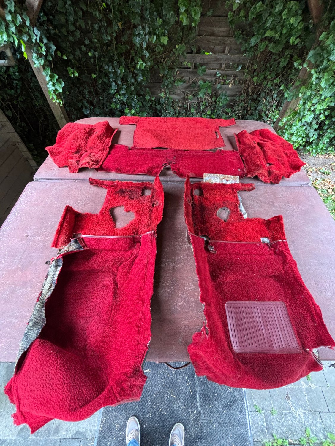

I removed the old carpet from my 77 which smelled bad and had holes in it.

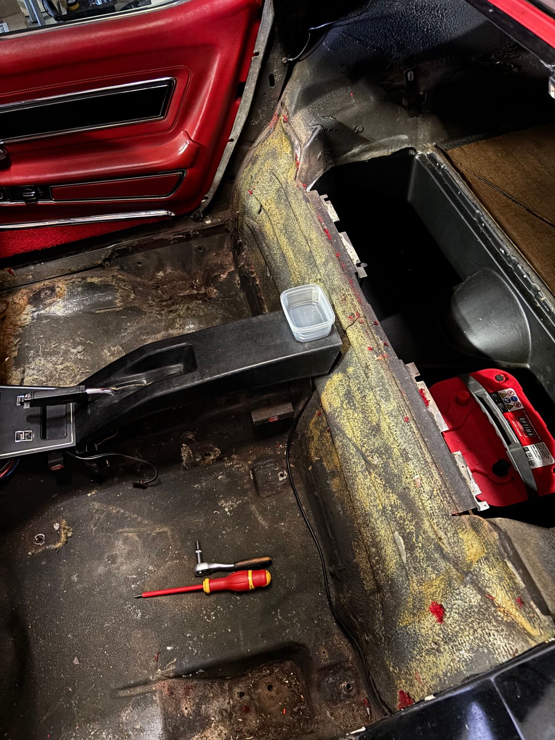

- The RH floor (foot space) is very humid/wet. How can I know if it’s water and not something else? It doesn’t have a smell. I don’t know if it’s water or WD40.
I sprayed the bolts from the body mounts a lot during the last half year to get the bolt prepped when I replace them together with the old and very damaged bodymounts.

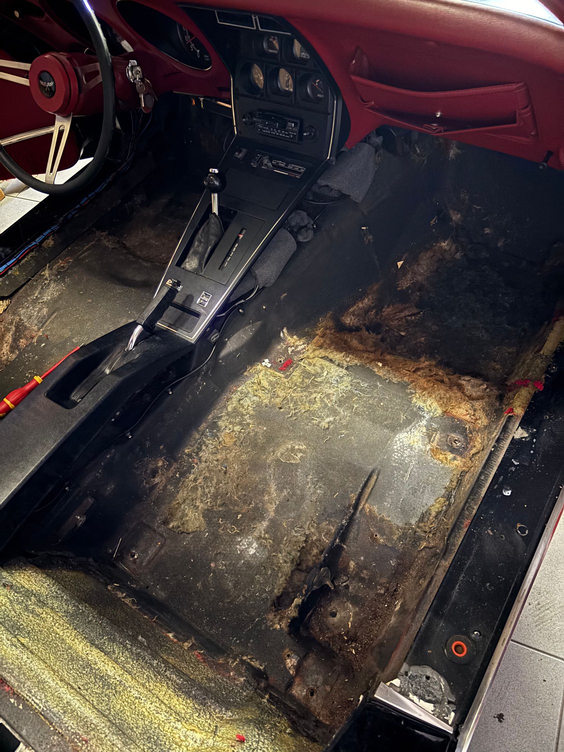

- Do I have remove the thick insulation stuff that was sprayed on the floor (rear and front)? It looks a lot like the stuff in the wheel wells. Or should I leave this in place?
- I will remove the old smelly insulation and replace it. (It seems there ones was a mouse inside). Here are the layers I want to apply to the floor:

Could the leak on the right hand side be from the heater core?
If you want the Raptor liner and/or Dynamat/Fatmat to adhere to the floorboards, you're going to need to remove all of the old insulation and clean the floor first. That would also be a good time to check/replace any seam sealer along the floor joints.

ALSO...YOU MAY WANT TO REMOVE ANY BACKING FROM THE NEW CARPET BECAUSE IT WILL BE TOO BULKY WITH ALL THE GOOD STUFF YOU ARE ADDING. (tRY INSTALLING ONE SECTION OF CARPET TO SEE WHAT I MEAN)

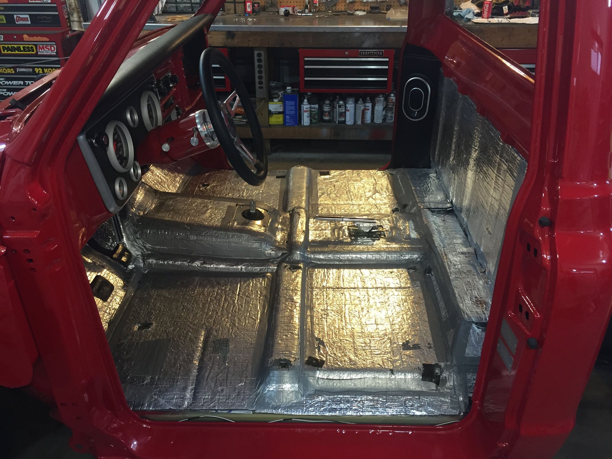

On my hot rod projects I buy the generic "Dyna mat" with on side very sticky from Summit. Then again generic insulating pad about 3/8" thick that foil on both sides with jute in between. Then the carpet.
On my 71 C3 project with headers I added from DEI fiber glass/foil insulation on the bottom side of the car above the headers.
Pic of my 68 C10 before carpet.

I just removed all the oem sound deadening material sprayed in at the factory from my 73.
It was several days of scraping and I’m now sanding.
In some areas it was really thick and others very thin so be careful.
It was hardest to remove it from any areas that are actually metal.
I was advised to leave the fiberglass floor in its natural state, clean the residue with some acetone then apply the new mat directly to the fiberglass for the best results.

If you haven’t purchased your carpet yet, Al Knoch Interiors offers it with the Jute or you can purchase the carpet and Jute separately so you can lay the carpet in some areas without the Jute underneath especially the areas under and around the pedals and console pieces.

If your passenger floor is wet, it's almost certainly coolant from your heater coil. Once you trash your old carpet, it should be easy to figure out. Use degreaser and clean the floor, and look for new wetness. Water will almost certainly evaporate quickly, while the coolant will linger.
