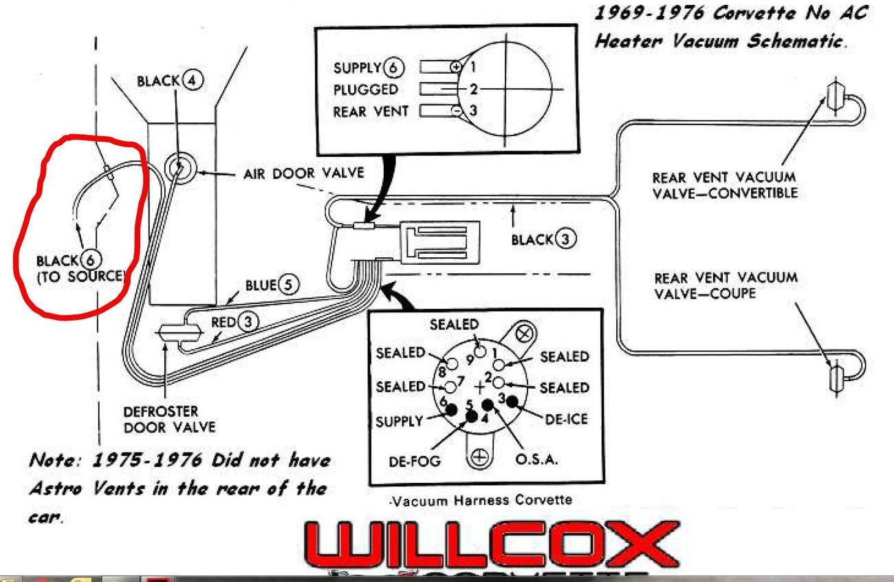

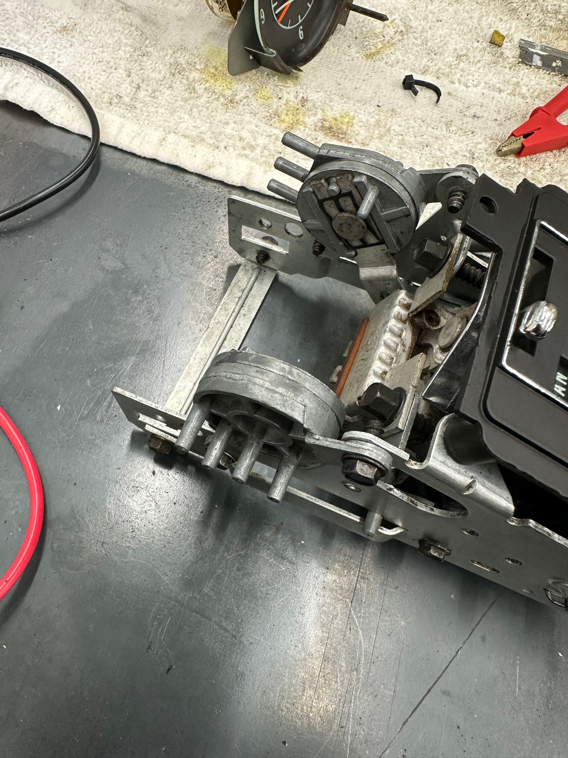

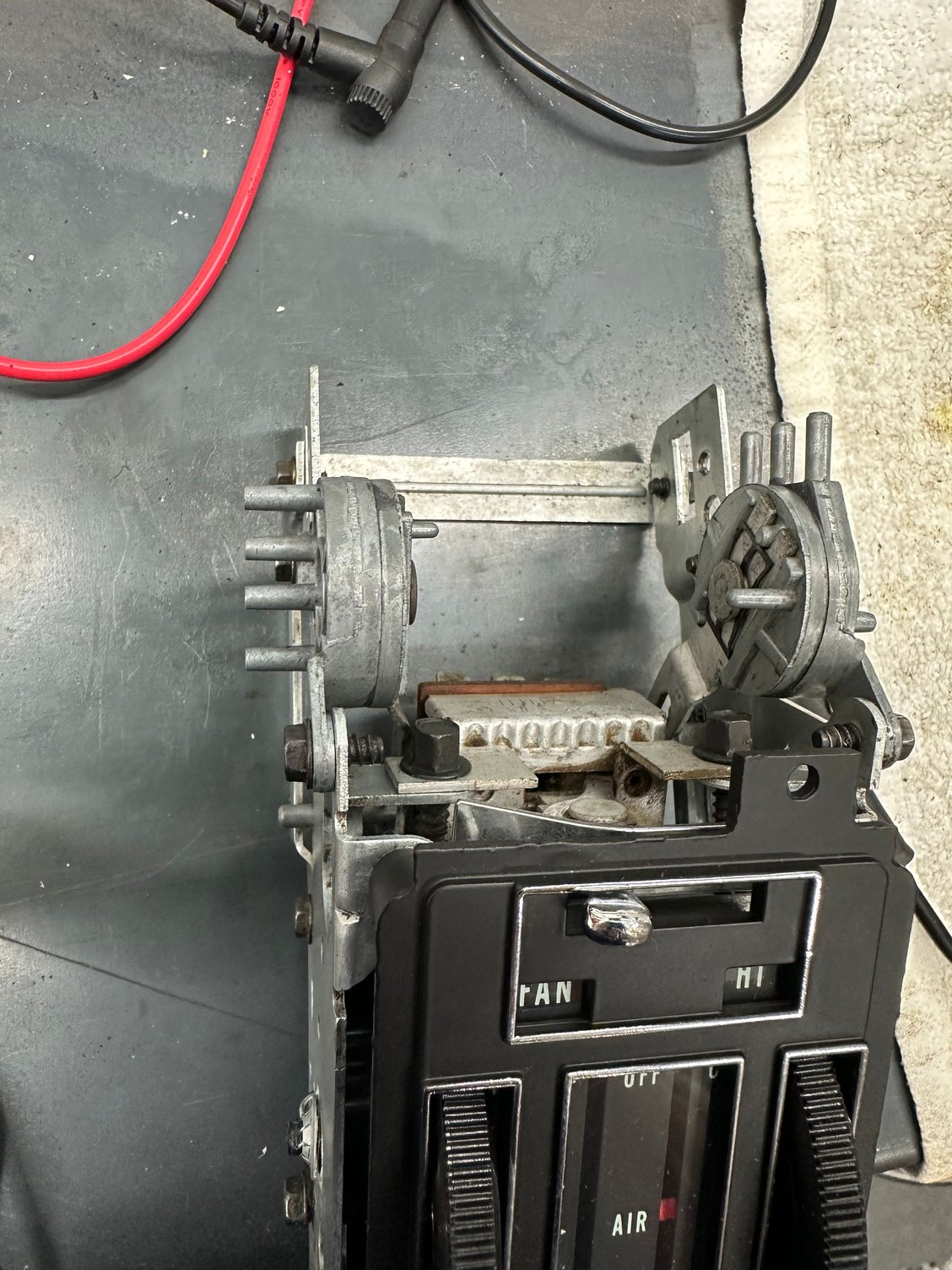

Can anyone help with where the main vacuum attaches to the heater vent control?
Actually I’ll take any sort of diagram that sorts out the vacuum lines and where they attach to the control.
Here is a picture of the nipples that the lines attach to.

Take a look at the absolutely brilliant wiring diagram (electrical and vacuum) produced by @robertea.
https://www.corvetteforum.com/forums...g-diagram.html
