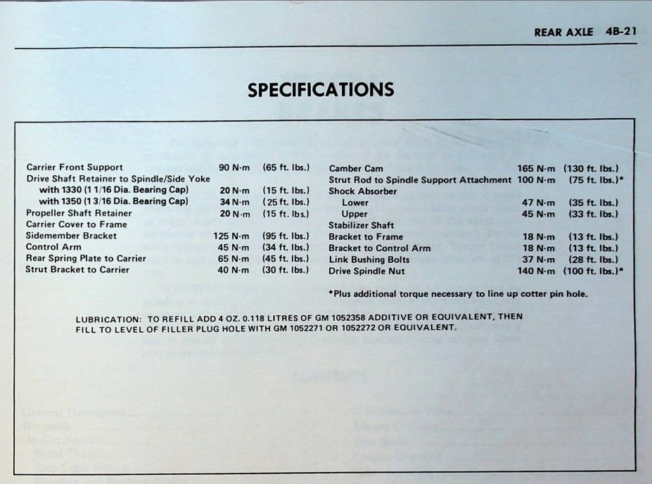

Hello,
Are the stated torque settings in the 1980 assembly manual stated in N.M. or Ft. Lbs.?
Thanks.

my 79 uses NM
see chart and faintly see the N*m? Newton Meters.

Thanks. My symbols are a bit more blurred (1980 manual) than yours, so I couldn't make out if things were stated in Ft. Lbs. or NM. Your pic now confirms that I have overtorqued (in Ft. Lbs.) my rear spring bolts. I now need to reset my torque wrench for NM and re-torque. Thanks mate !

Originally Posted by Masic
Hello,
Thanks.
I don't have a 1980 Shop Manual but do have a 1982 Shop Manual. They state both NM and foot pounds (1979 Shop Manual does too but not applicable for Dana rears) so not sure what part of your manual is blurred. See attached from 1982 batwing Dana axle section.

Rear spring plate to carrier 65 N.M. Thanks. Saving this one.
