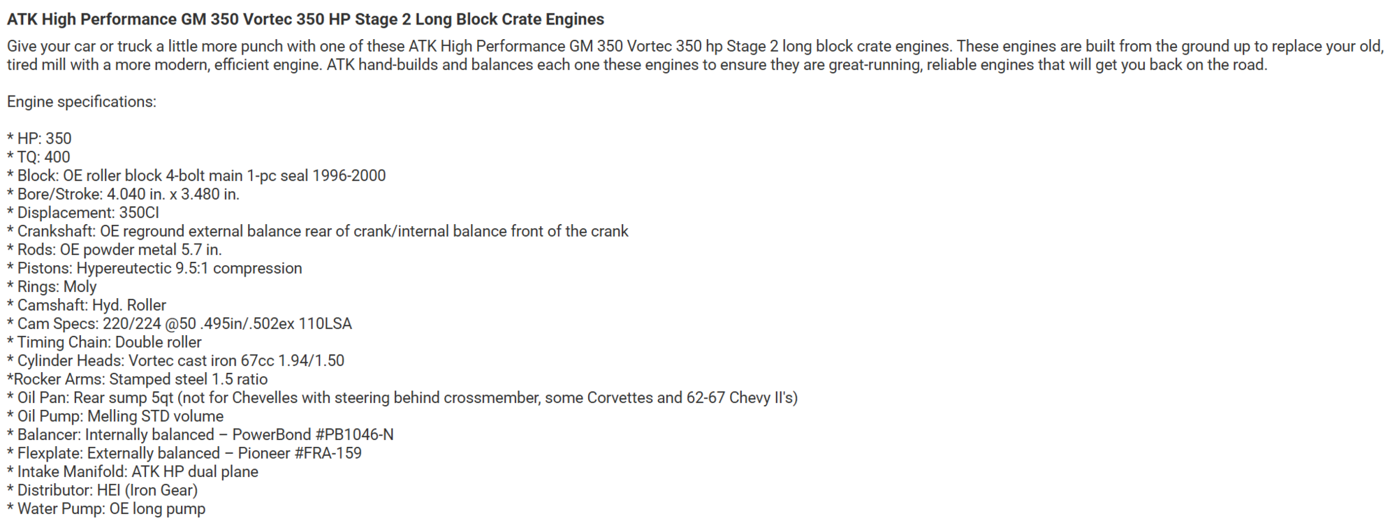

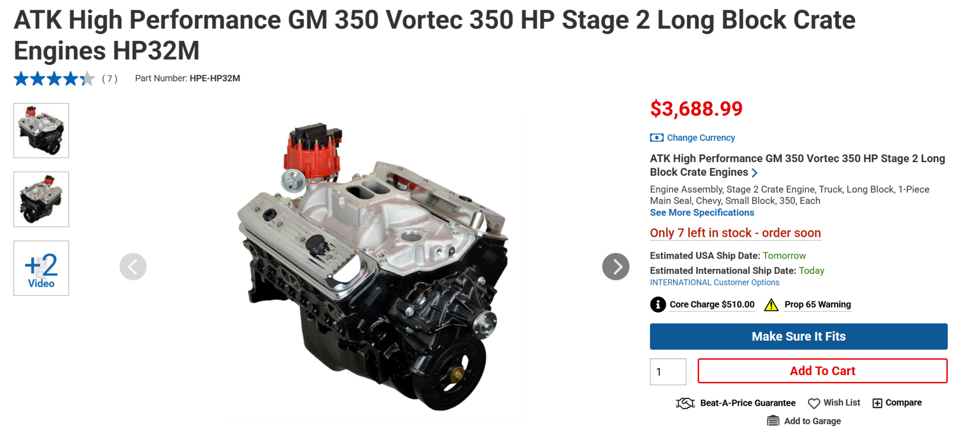

What do you think about this crate engine from Summit Racing - It's in my price range as I wanted to be around 4 to 5K for an engine build.

ATK (aka ATK Vege) is bottom of the barrel; run.
If you can up your crate motor game another $1200, I suggest GM P/N 19433032 . 350ci/357hp every bit is All Brand New and All USA with best Warranty (GM) anywhere, anyway. Good genuine GM iron Vortec heads, good steel billet roller cam & roller lifters, good forged steel crank.

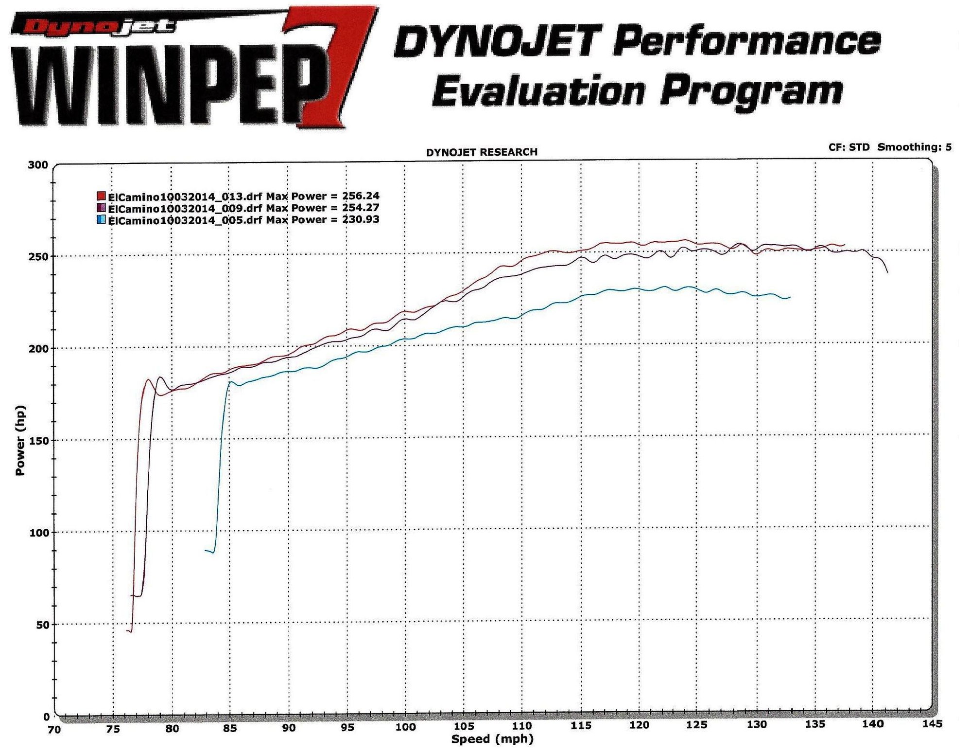

I haven't been on here in awhile, just saw this. Below are some chassis dyno test results from a 350 El Camino I had several years ago. The motor was a base 350. It had an Edelbrock Performer EPS intake, a set of generic headers, and a mild cam (never determined which cam it was, but probably a Comp 260 or 268.
I first added FAST EZ 2.0 efi & ignition control. Tuning was super easy with it, and after several dyno pulls I got the blue results (bottom curve) on the graph. The Elky ran lower 15's at the track in this form.
Awhile later, I came across a set of Edelbrock E-Street aluminum heads on eBay - CHEAP! They were the larger chamber size, and I got them for about $700 shipped! A friend is a highly respected head porter, and he offered to give the heads a quick check. He re-honed the valve guides, as they were tighter than he liked. He also did a quick back-cut on the intake valves, and we changed out the seals. I then installed the heads, and took it back to the dyno.
The middle (purple) curve is the first pull, with the EFI settings the same as with the iron heads. AFR targets remained the same, but I started playing with the timing. As expected, the aluminum heads required less total timing. Also, the new heads liked the total timing to come in quicker. The top curve is after I finished tuning the timing. Bringing the total timing in at lower RPM resulted in a nice boost in the mid-range power. This was all done on 87 octane gasoline.
Right now, I'm working on a friends '72 350 Corvette. I initially installed some AFR heads, Stan's Tri-Y headers, a HR cam that I designed (and had ground by Comp), and a nice 2.5" exhaust system. Some details and photos here: https://www.corvetteforum.com/forums...pressions.html I'm not sure of the gears, but it would easily smoke the tires.
Right now, I'm finishing up some updates to that car. I just installed a FAST EZ 2.0 efi & ignition system on it. I took it on a test drive yesterday, it chirped the tires pretty hard when it shifted into 3rd at about 5800rpm! I'm hoping to put it on the chassis dyno next week, but it is obviously much stouter than the El Camino.
I know Stan's is out of business, but one of his employees was making the tri-Y's a few years ago. More info on this thread: https://www.corvetteforum.com/forums...headers-2.html
