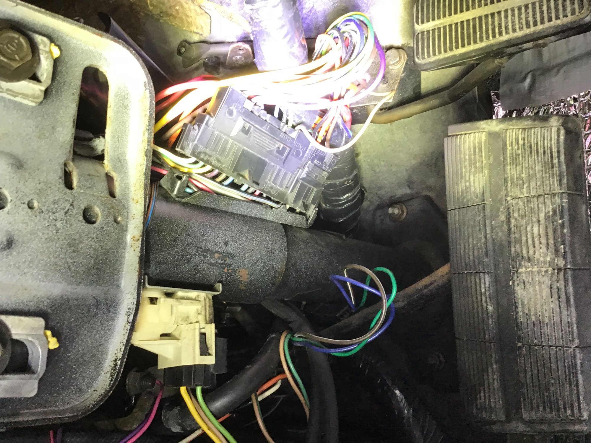

This is on my 1981,I pulled the long group of wires on bottom of steering shaft column,I took them a loose to inspect them,all is ok,but now can’t get them to clip back in place,wires are in the way,any recommendations,and it’s in place,so not like it’s out the car,I see it clips on the sides,but the wires on the back side want let me squeeze it enough to clip it.

Can you see the electrical "pins"...
if one of them is slightly bent you won't be able to snap the connectors together.
I have had to take a couple long thin screwdrivers and move problem wiring aside to snap connectors together.

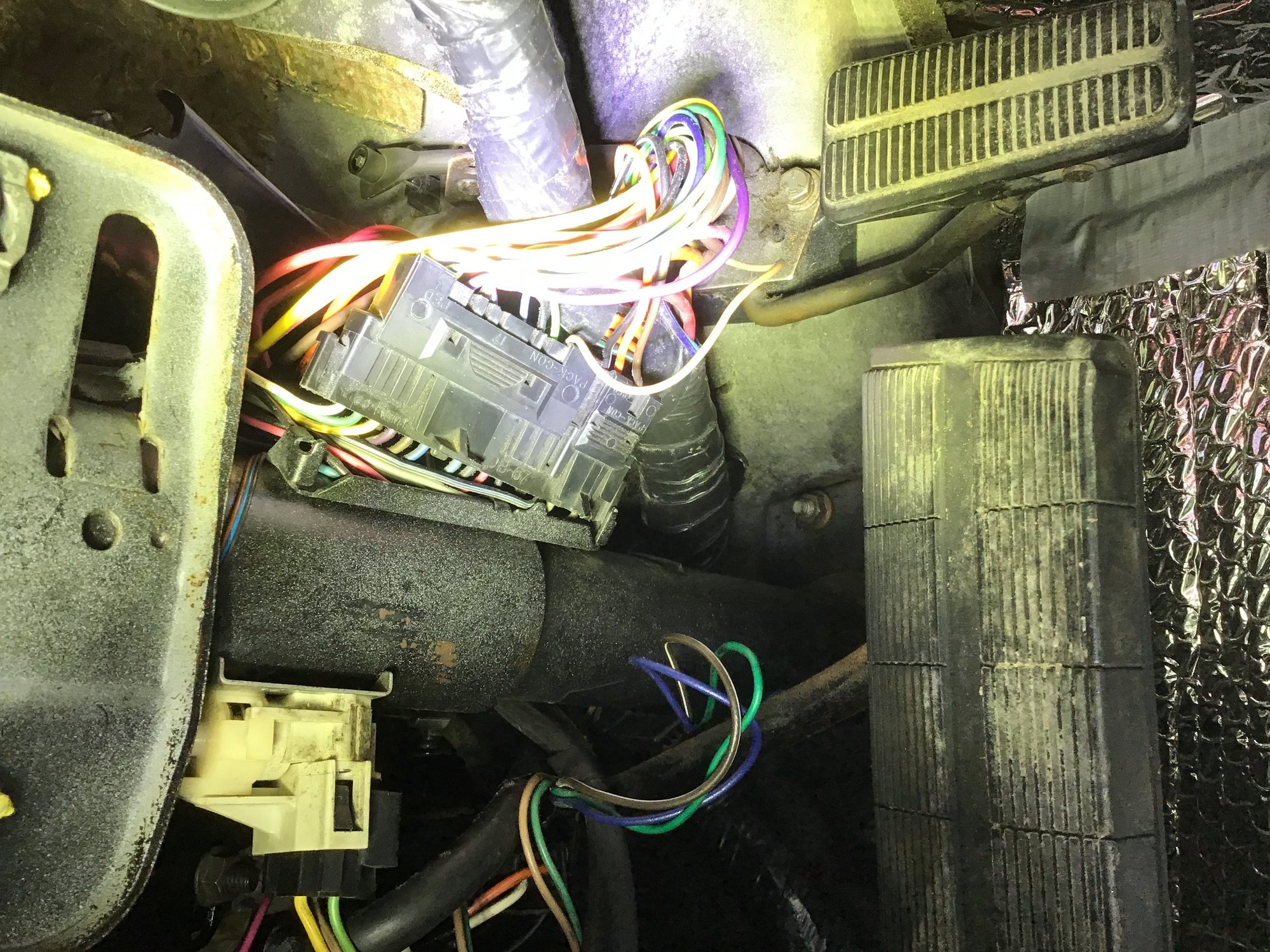

I think we’re talking about different things,here’s a picture of described area,I’m trying to connect it back to black plastic piece,
The wires on the back side won’t let me clip on ends.thanks

Here is a pic of my 78. You need to have the plug itself lie flat against the clip with the wires going up and down against it. I am not sure how to describe it so maybe my picture will help.

If you loop one half of your plug wires around the back side of the shaft, then come up underneath, it should align properly.
